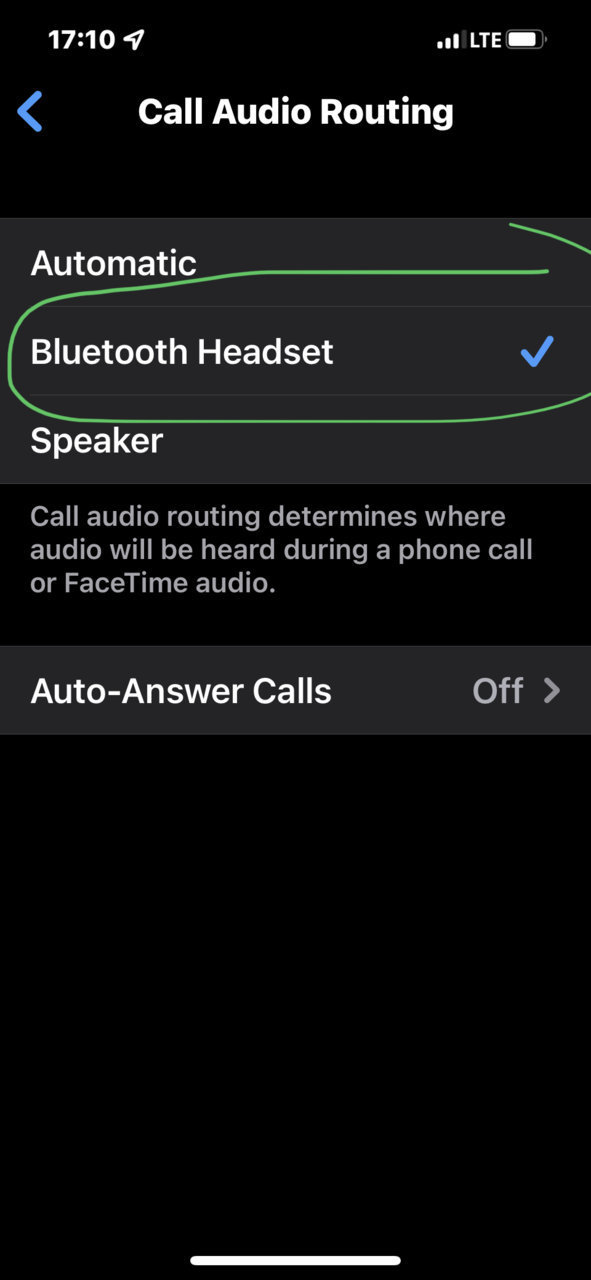

    Just so you realize, this thread is for people that have an aftermarket radio, and that have bought an adapter to use the OEM mic with the radio. For your issue I would ask Toyota. It’s probably that it’s not insulated where the mic is. That’s why you’re getting background noise. Also check the settings on your phone for carplay make sure it’s using the trucks mic not your phones also
    make sure those are selected. For the one go to Bluetooth select radio, change device type to handset.
    the other one is under accessibility change call routing from auto to bluetooth headset

    Great guidance. I’ll try the settings. I’ll make sure I’m asking or commenting on the correct thread next time. Learning how to navigate and search this site.

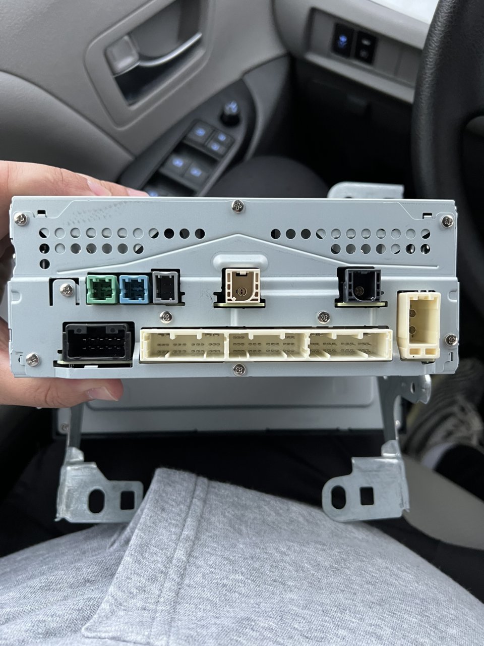

    Hi wickedax ive been thinking trying to email and pm to buy harness from you with no response if u dont have any available is there any way you can at least post a picture or diagram of what plug to and wires to tap into on a 2020 toyota sienna with sos basically same radio as tacoma see picture below. I have a joying and internal mic is horrible and would like to use original mic
