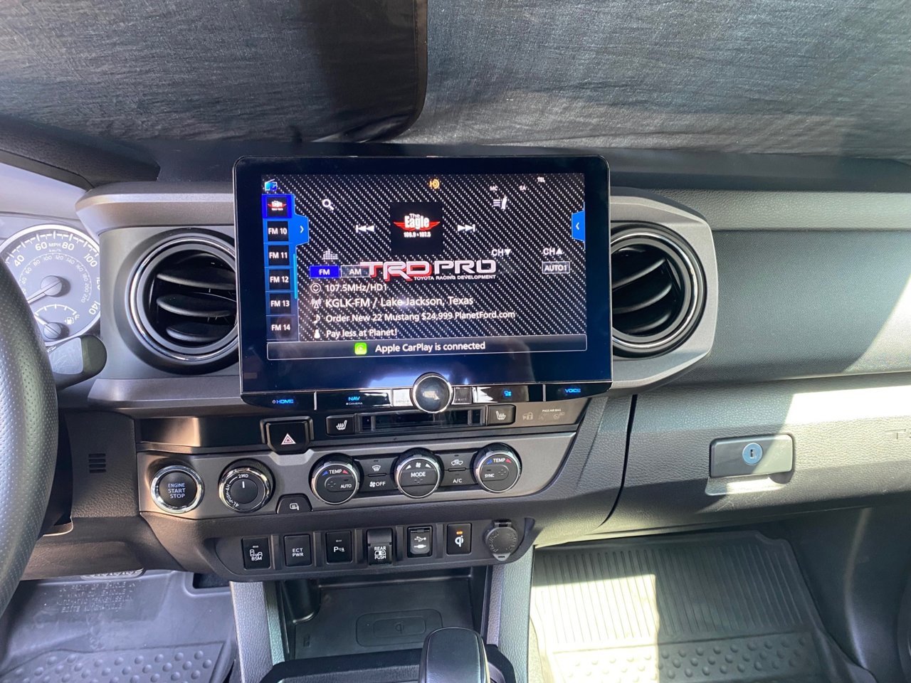

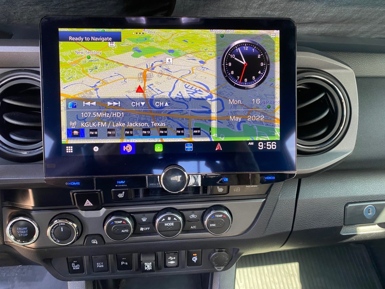

  11. May 16, 2022 at 7:47 AM
    #251
    jvolek
    jvolek Active Member
    Jan 22, 2021
    #353630
    28
    John
    Houston, Texxas
    2019 Tacoma TRD Pro
    Installed the Tombit and Kenwood Head Unit, the Tombit works perfectly for those wondering. It's disappointing to see the company seems to be out of the product, but thanks to a forum member I was able to pick one up for my Tacoma Head unit installation upgrade.
    I am really surprised a company like iDatalink Maestro hasn't figured out this factory microphone solution, or purchased the technology from Tombit to utilize in their kits?
    Kenwood DNR1007XR

    Awesome! It’s really a bummer that this isn’t working well for anyone with Pioneer HU such as myself…call quality with Apple CarPlay isn’t clear. Even after all the troubleshooting. I’m just glad to get rid of the stinking “mic”.

    That's great to hear, which model Kenwood H/U did you install?
  14. May 16, 2022 at 8:10 AM
    #254
    jvolek
    Jan 22, 2021
    #353630
    28
    John
    Houston, Texxas
    2019 Tacoma TRD Pro
    DNR1007XR
    patdeezy likes this.

    Please post a pic of your HU? TIA
    Were you able to use our GPS antenna by using an adapter? Do you have a short cut button programed for front/rear cam on the steering buttons?

    Not sure if these questions are directed to me, I used the Maestro GPS antenna adapter, as well as the Sirus XM adapter, and the XM module all work perfectly. I do not have a front camera as of yet...

    The only thing that is not truly configurable on the head unit is the dimmer illumination...Kenwood's illumination is either the lights are On or Off for dimming, I like driving with the daytime lights and RIGID fog lights on, which means I drive pretty much all the time with the lights in the on position. It is not a major issue as the illumination adjustment on the screen is pretty quick and easy when I drive at night.

    Update, noticing a lot of static on the receiver end of phone calls thru Apple Car Play, will need to pull the head unit back out to ensure I didn't pull anything loose during the installation. Will likely try the Kenwood Microphone to see if it eliminates the static issue on phone calls.
