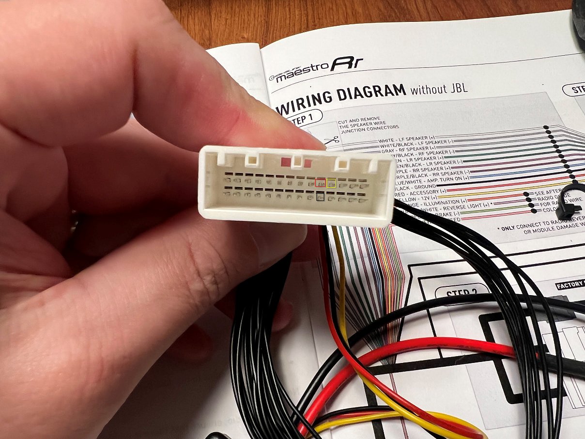

    Anyone have some pics of the 2020+ setup that was sent out? Preferably of the harness itself and the pins it lines up with in the factory harness. This would be w/ the SOS button, pretty pretty pretty please.
    Tried getting a hold of @WickedAx , but I'm thinking he may be burned out on this project, so not really responding.

    Are you just wanting to know what wires were spliced into on the 2020+ harness so you can hard splice on yours?
    I’d like to figure this out as well. I have a 2021 and I swapped the radio already. I reached out to Tombit to be a tester but no reply, guessing he’s done with this project. I’d like to get the little module at least but I also don’t know the wiring needed to be spliced into, though I do have access to ALLDATA and if someone could tell me what wires were spliced on a 16-19, I could probably correspond those to the necessary to be tapped wires on the 20+.

    Exactly, I have the 2016-2019 adapter which doesn’t fit my 2022. In my truck, I have the SOS button up top, but I declined Toyota connected services, so it’s basically a dead button.
    Reading some of Tom’s responses a few pages back when he was moving into beta testing his new design he mentioned that trucks with the sos button the mic was powered by the button itself so 5v was not being provided by the head unit. I think that could simplify things. (Link: https://www.tacomaworld.com/threads/3rd-gen-tacoma-oem-mic-adapter.714665/page-5#post-25705032)
    me not sure…:notsure:

    @BLtheP I think what is here is MIC + (?), MIC - (?)and then 5v, stepping down from 12v (?) I haven't opened the box to see what they are soldered to.
    In this post he mentioned he finalized "PCB Design" for the 2020+, so it seems some sort of adaption may still be needed: https://www.tacomaworld.com/threads/3rd-gen-tacoma-oem-mic-adapter.714665/page-7#post-25880370
    @Hideki posted some pretty good info when it comes to what the leads (may) be in use: https://www.tacomaworld.com/threads/3rd-gen-tacoma-oem-mic-adapter.714665/page-6#post-25738167 , interestingly enough the adapter I have only feeds 3 x wires into the harness.
