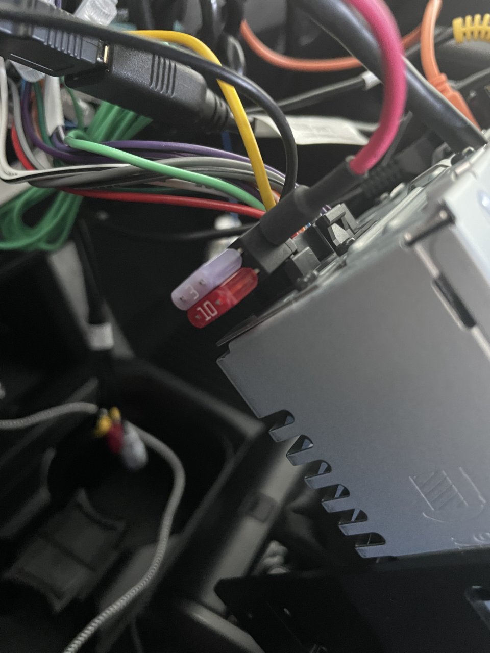

    Extending the add-a-fuse to the in-cab fuse box should not present a problem for most people attempting to install an aftermarket head unit. Cut, strip, use butt connectors or posi-lock, extend the length with some properly sized wire, wrap with tape or loom, route under the dashboard, pop off fuse cover, remove any fuse which is ignition switched (poutlet1 or poutlet2 are easy choices) and install the add-a-fuse.
    I was going to go that route at first for seat heat but wound up poaching off the trailer brake controller + a high current relay + 8 circuit compact fuse block for ignition switched power.
    NOTE: The maestro uses the same fuse style as this so any aftermarket head unit using a maestro should have plug and play install capability regardless of the head unit selection.

    If you desire full plug-and-play, a second T harness for power and ground would make sense to me, but that adds cost. You might need to differentiate that by JBL yes/no and/or eTune3 vs eTune2 but if you used a cheap JST connector you could have the power T selection independent from the rest of the product.
    I plan to do that myself (2 pin connector to supply power and ground off my under-cupholder compact fuse block, though if you used 18 gauge for either I'll use an 090IIU connector instead of JST since those get tight past 20 gauge)

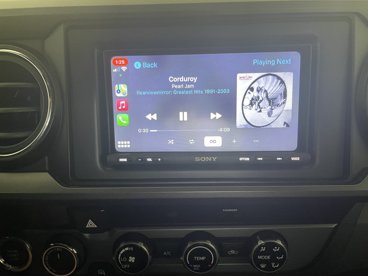

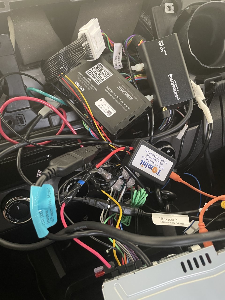

    Hello, I received my Tombit 3rd-Gen Tacoma OEM Mic Adapter in this morning's mail. This was quite a nice addition because a month ago I installed in my 2017 TRD Sport Access Cab 4x4 a Sony High Power XAV-AX7000 head unit and all new Kicker speakers including the Kicker/Subaru dash tweeters, and wanted to make use of as many of the factory inputs as possible. SiriusXM is very important, so instead of using the ugly magnetic external antenna I sprang for the extra 20 or so bucks to get the Metra adapter that connects to the standard add on SiriusXM receiver on one end and connects to the factory lead to the shark fin SiriusXM antenna. Also the USB port adapter (for USB 2 on the Sony) to make use of the dashboard USB port, and now this awesome Tombit adapter to make use of the factory microphone so no need to have the ugly stick on mic in front of the gauge cluster. So as of a bit ago, the only thing that isn't factory is the Sony's USB 1 port (used for Apple CarPlay and Android Auto), but even there I was able to buy and mount one of those under dash USB extensions and use a fabric covered fairly rigid USB to Lightning cable, so I can live with that. (The Sony doesn't have wireless CarPlay, and even if It did I'd not use it because obviously it doesnt charge the iPhone, rather it drains it).
    Now, before ordering, I could have swore the Sony used for its built in fuse an ATC type wide fuse. No dice. It uses a mini fuse. So I went to O'Reilly and purchased a Mini Add-A-Circuit fuse tap part number DFHM0200ZP and chopped the red wire on the Tombit to remove the ATC fuse tap and butted this new mini one on. Now, a couple issues here, (and I hereby accept responsibility for specifically not following the Tombit instructions to NOT do this, it's all on me) but the mini tap a fuse has thinner gauge wire than the one that comes with the Tombit and also the instructions say not to use it in a fuse socket exceeding 10 amps. Well, the Sony's fuse socket is rated at 15 amps and had a 15 amp mini fuse in it. So, out of an abundance of caution I installed in the mini tap a fuse a 10 amp fuse to replace the Sony's factory installed 15, and also had to use a 3 amp on the Tombit splice since 2 amp fuses aren't readily available for the mini fuses, and the part from O'Reilly included the 3 amp anyway (and the 10 amp as well).
    So, everything works. The microphone works, Siri could hear me loud and clear. Phone calls were of the same quality as the Sony provided mic I'd been running since install. Knock on wood everything is a go.
    Now the main concern I have is that downgrading the Sony's internal fuse from 15 to 10 amps may blow that sucker. There is a Pearl Jam song on my iPhone that is quite high volume and is decoded in Apple lossless that once caused the Sony to go into some type of software based shutdown after jamming the song at near max levels for some time. It was either Corduroy or Better Man. Anyway, I'll try playing those songs at high volume and see if I can get that software shut down to occur, and hopefully the extra current doesn't blow that 10 amp fuse (maybe the software shutdown occurs before the hardware fuse comes into play?) I used to replace the factory 15. If it does I may need to risk it and put a 15 in the tap a fuse, but as long as the 10 doesn't blow I'm sticking with it. Will report back if any issues arise.
    Oh, and one other small modification, the wire plug for where the main harness for the Sony plugs in had a tab that goes over the fuse. With the tap a fuse, the cover would have made it so you couldn't have the harness and the tap a fuse installed simultaneously. So I snipped the tab off with linesman pliers.
