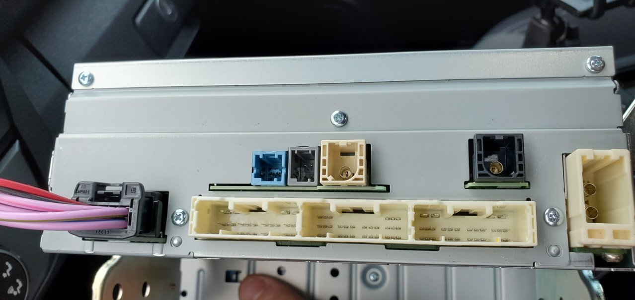

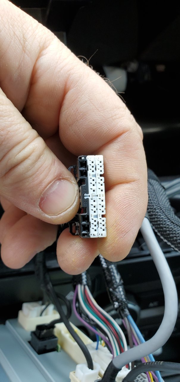

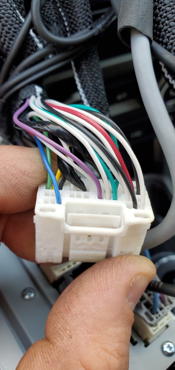

    @WickedAx I'm not seeing a 28 pin male. I have 2 26pin and 1 32pin females.
    Edit: This is a 2020 OR MT

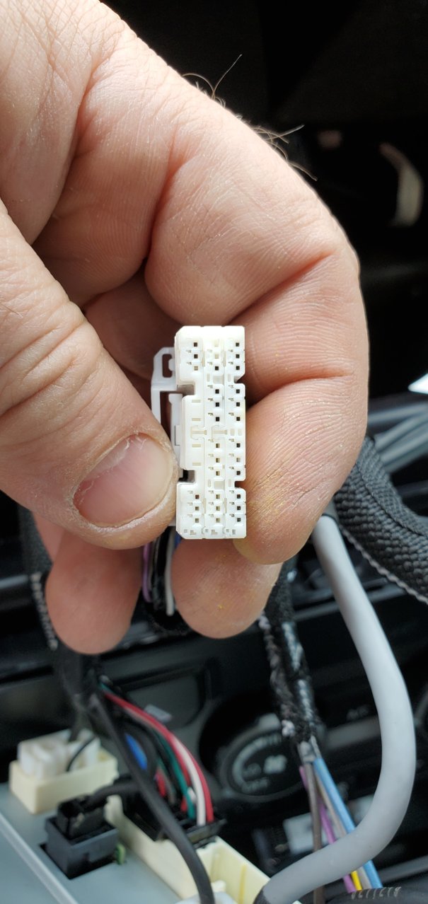

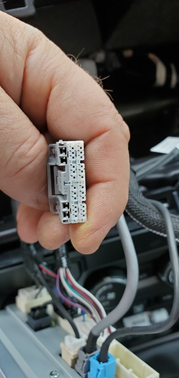

    @jstemp, that's perfect! Thank you so much! Not sure when the 2020 (and later models) adapters will be ready but as soon as they are, I've got one earmarked for you!
    FYI - The gray harness (the one in the second picture you posted) has 28-pins as there are 24 small pins and then the 4 larger pins on the left and right side at the very top between the spring latch.

    @WickedAx I doubled up the white connector pic. Here is the last. So it's a white, black, and gray

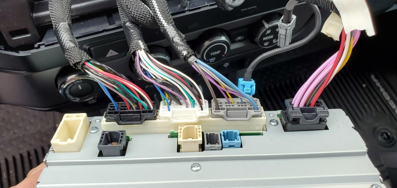

    @WickedAx Will this work or do you need to see in more detail?

    That'll work, @jstemp. Thank you!

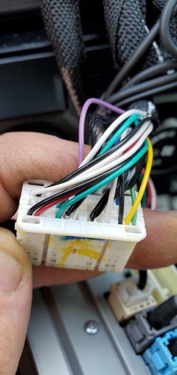

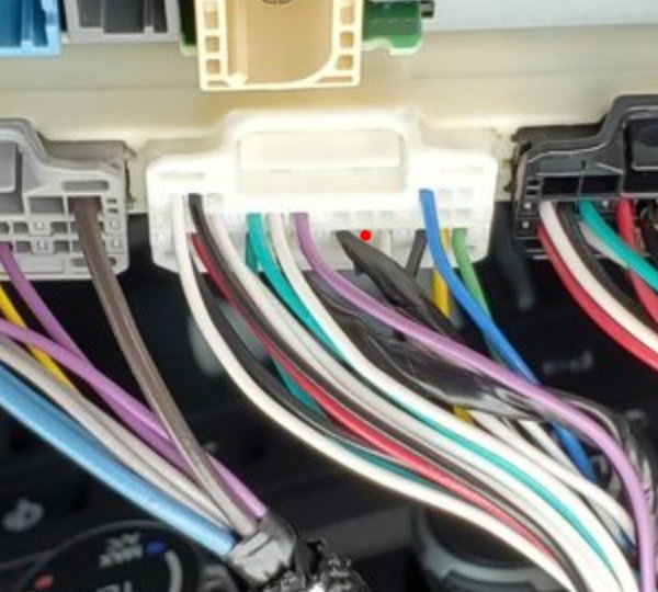

    Ah, that explains it! I was wondering why I wasn't seeing a VDC line out of the OEM head unit to the telephone/mic module but that's because in the 2020 (and later models) with SOS, the telematics module is powering the telephone/mic assembly (as opposed to the head unit providing the power.) That lines up with what I'm seeing in the wiring diagram.
    In the picture below, I placed a red dot on one of the pins on the back of the white connector between the electrical tape wrapped wire and the white wire. Can you tell me if that slot is empty or does it have a red wire coming out of it (I'm assuming it's the former but need to be sure?)

    There is no wire in that spot.
