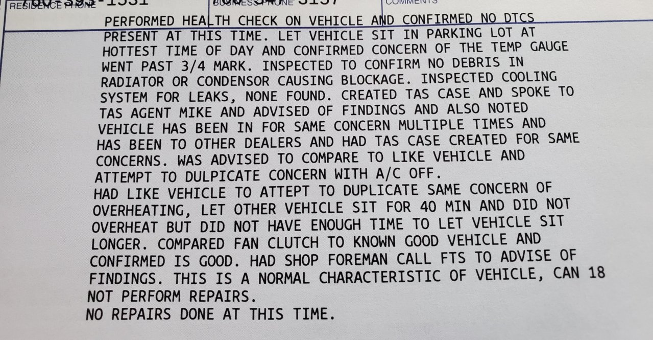

    Just a FYI im at the service department showed them the TSB and they told me no they sent the information to toyota but there not able to do anything

    Can someone please explain if im reading this wrong because this is their excuse to not do any repairs due to over heating. I'm I wrong?, how is the truck gonna overheat with the AC off -.-

    @TacomaCali that a bunch of bs. So they admit your vehicle is overheating, test "like vehicle" dont see it over heat and say its normal. I'd do what @Skydvrr said and just let it blow.

    @Johngoesoffroad I went in today to speak to the service manager straight up told me he wasnt going to go back and forth with me and that it "doesnt matter what the TSB says" Because the FTS person said no repairs. I Just called corporate today and their gonna investigate it supposedly. This guy straight up looked me in the eye and said its a normal function, then he said I dont think it is but thats what the FTS guy said ‍:goingcrazy:

    @TacomaCali thats so sh****. Let corporate investigate im sure theyll call you back in to either a different dealer or the same for a re-inspection. I honestly dont think the TSB is related to our concern since it doesnt mention anything about heating. I'm sure since you have a few visits with them their "taking care of themselves" in regards to the lemon law. If they dont perform a repair although you may have multiple visits the lemon law from what i know doesnt apply. I'm sure the service advisor is being told to have you leave as the service manager seems to be fed up with the situation. Only way you'll get a result is if you keep calling. id highly advise you call everyday so they dont brush you off.
