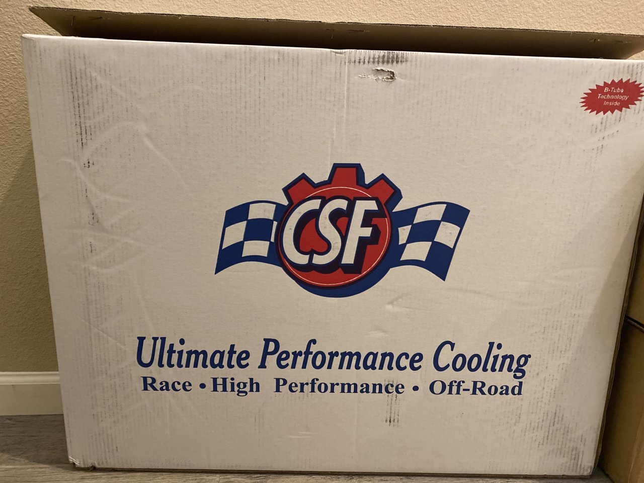

  11. Sep 19, 2020 at 12:08 PM
    #71
    el_taco_inferno
    el_taco_inferno New Member
    Jul 1, 2018
    #258023
    4
    Izzy
    2016 Inferno Tacoma TRD Offroad
    Well my radiator got here today I’ll be installing it this weekend and keep you guys posted!
    Mt133677, NMBruce and jmneill like this.
