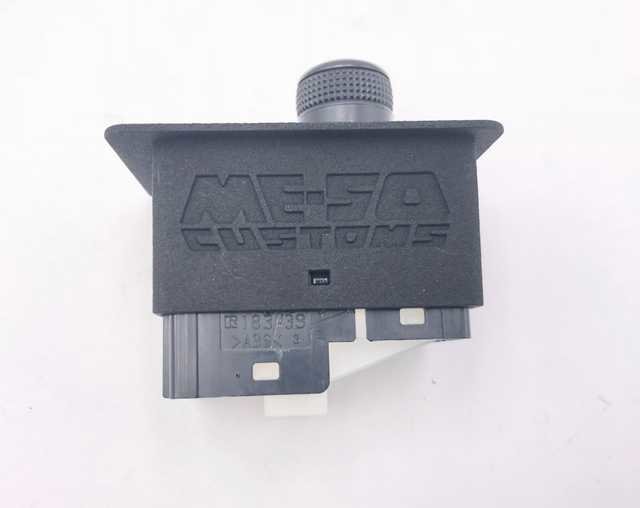

    UPDATE:
    ME-SO Customs Controller Bezel Switch Panel - Thanks to @mesojdm

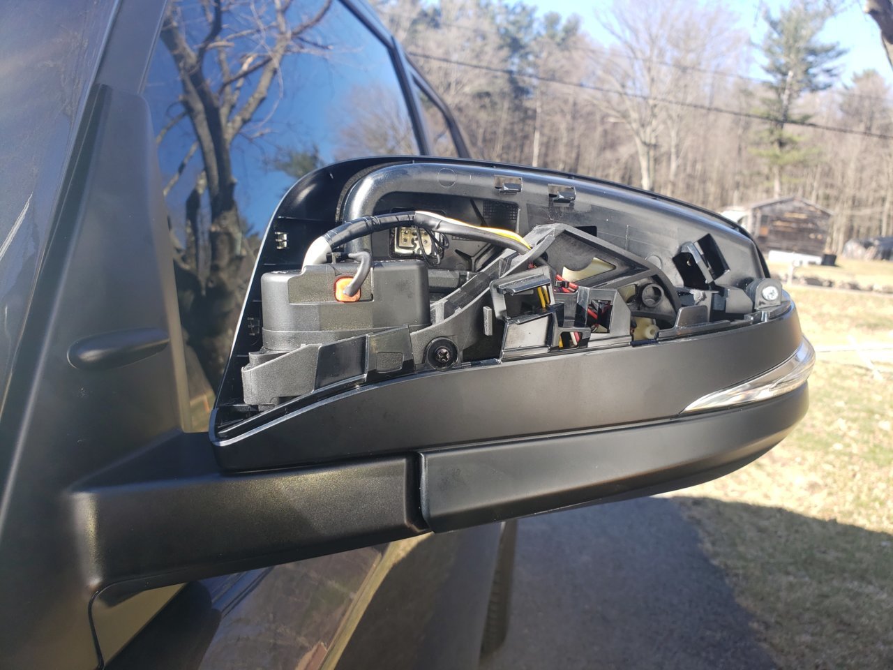

    UPDATE:
    Alright everyone! 4Runner DIY Kit is 100% installed inside the OEM 5th Gen Mirror!
    Things we found out during the install process:
    • Connection Plate or the Adjuster Actuator Need to be Switched Out
    • Connection Plate Needs to be Modified to fit the OEM Turn Signal Signal
    • Three Cirlcles on the backside of the Mirrors MAY need to be Modified depending on the Adjuster Actuator used for this Kit
    • Mirror Housing Adjuster Actuator mounts are not needed and therefore are cut off and smoothed out to make a clean surface for the Adjuster Actuator to mount cleanly to the New Connection Plate
    Other than that, I think that about sums it all up. Everything else went extremely smooth with the install process. All we are waiting on now is the 4Runner Switches and Wiring Harnesses. However, we did a test of the mirrors to make sure they were operating and functioning 100% after install. What do you know, they WORK!!! :bananadance:
