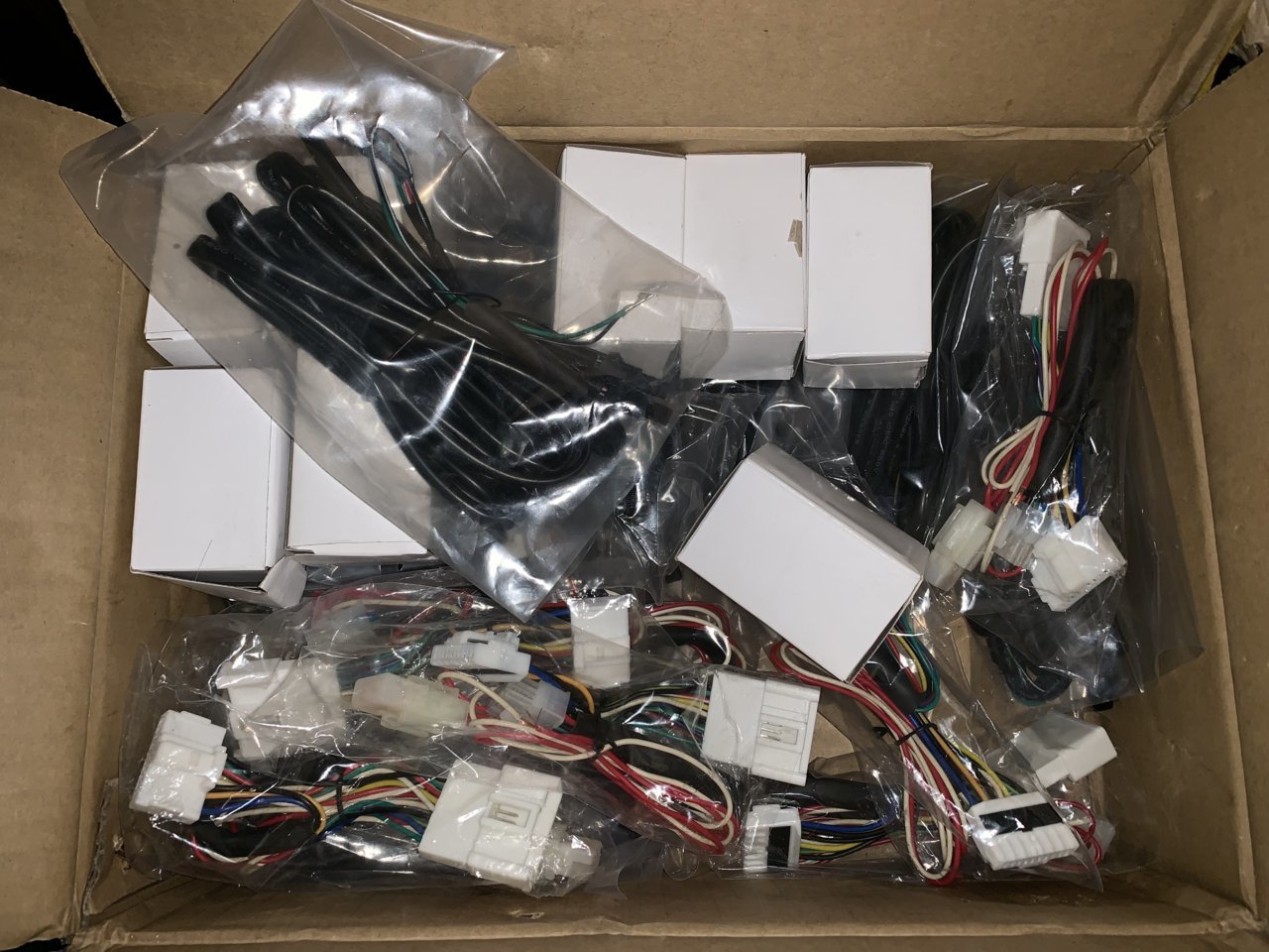

    UPDATE:
    1. I received the 4Runner Replacement OEM Toyota Adjust & Fold Switch, Automatic Control Box for the Folding Mirrors, Wire Harness, and the Motor Extension Harness. If everything goes well this weekend, I’m hoping to be sending these DIY Kits out for the 4Runners on Monday.0391884B-38BE-4166-8894-1AF0E039C2D4.jpg
    2. So what does that mean, well I get to start working on the rest of the 4Runner orders :bananadance:
    3. Now for the Taco Kits...I have been sent some instructions to try from the factory on the wire harness this weekend. If everything goes well, then I should be able to start working on these orders on Monday as well.
    4. I received the New Sets of Mirrors for the Tacos to Build! However, I received only the Passenger Mirror because supposedly the Driver Mirror is backorder until the 30th. Haha. Good Lord. Too much!
    I am super excited to get these 20 Kits Shipped and in the hands of their NEW OWNERS HANDS!!

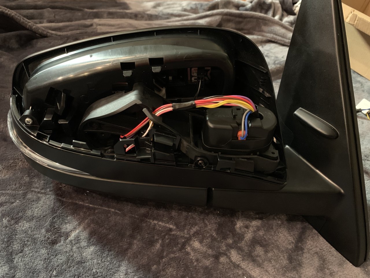

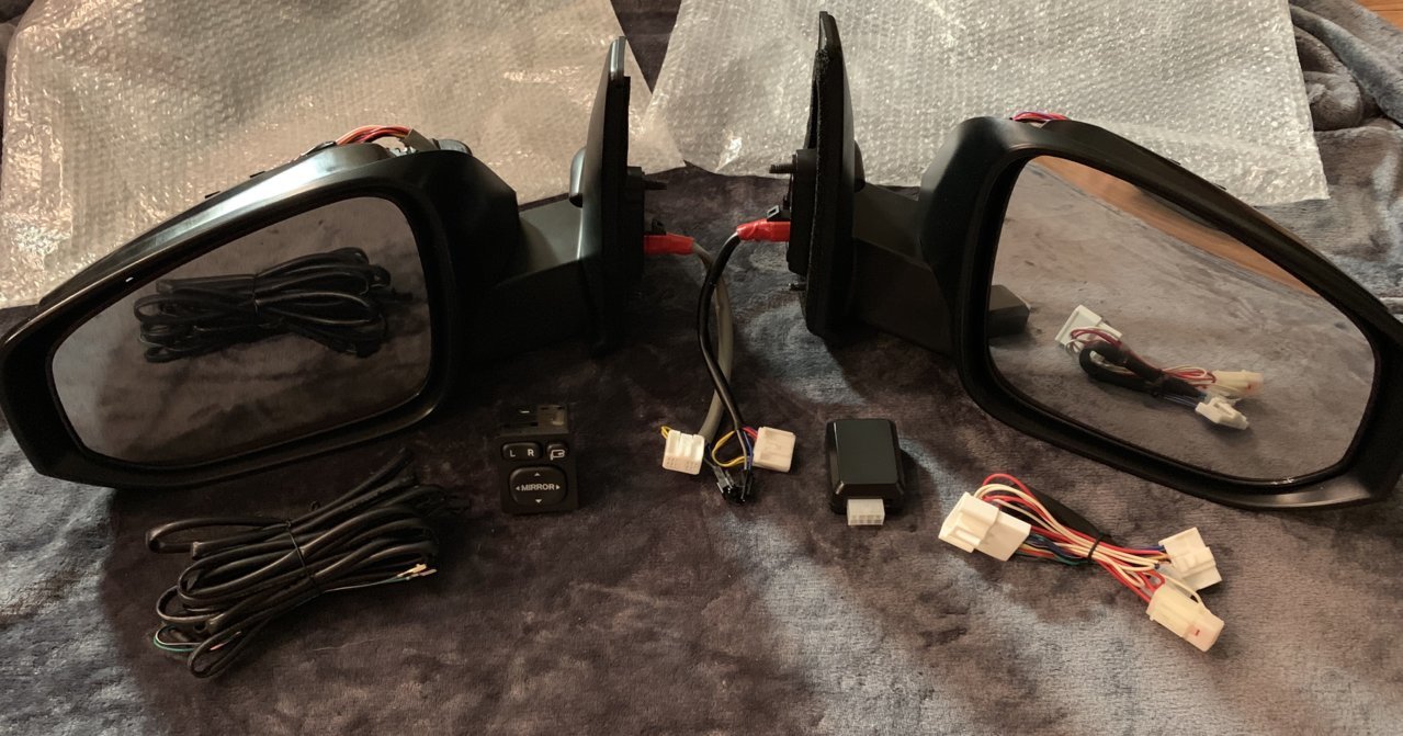

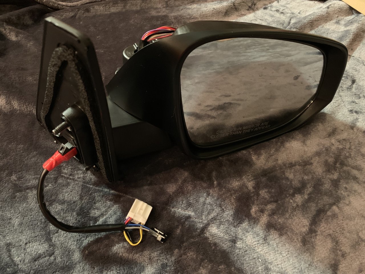

    UPDATE:
    Today was a HUGE success for the 4Runner!!! The 5th Gen Power Folding Mirrors are a go once I finish the installation instructions. I will be working on it all day tomorrow and I’m sure it’s going to take a lot of time. I’m not sure if I will end up finishing it tomorrow or not. I will make it as detailed as possible as I know you guys are going to need it :) This has been so much fun! I cannot wait to get more feedback!
    Here are some key modifications that will need to take place during this install:
    1. OEM Mirror Housing does need to get trimmed on the backside to get rid of most of the tabs around the circle where the Actuator rests.
    2. Connection Plate has a few areas that need modified in order to make it work for the 4Runner, but it works. There needs to be a small section cutout for the Turn Signal which isn’t too bad. There needs to be two 1/8” holes drilled through what are already mounting holes, but you need to be able to put a screw in from the backside instead. It will be identified in the instructions, but you’ll need to sand down two of the Actuator mounting holes that sit higher because they’re not used and they stop the OEM Actuator from sitting low enough. Lastly, there are some tabs that just need shaved off so the bottom cover piece can sit flush up next to it.
    3. On the Actuator, there is a tab on the top thay just holds the wires, you will not need this tab anymore and it also prevents you from being able to rotate the Actuator to line it up with a mounting hole for the new connection plate, so you’ll just shave that off too. Very minor. You’ll see.
    4. Last modification that is needed is in the backside of the Mirror Glass. Due to rotating the Actuator, the three little circles do not matchup anymore. It’s ok. They are pointless anyways. Just shave those right off and make it smooth.
    I’m pretty sure I touched on all the modifications that are needed for these Power Folding Mirrors. Trust me, you are going to absolutely love them!!!
    Here are some pics of what they are going to look like when you are done!!

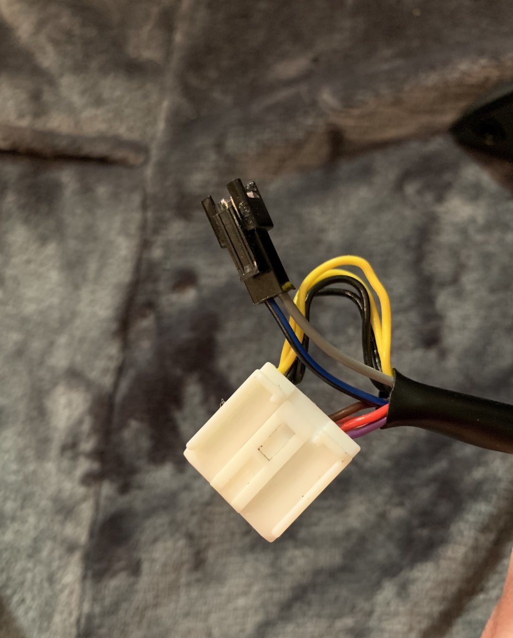

    *BONUS TACO/4RUNNER MEMBERS*
    There is no need to Splice/Tap into your Trucks OEM Wire Harness. My 3rd Gen Plug-N-Play Harness is made with all brand new material including OEM Connectors, Terminals, and Wiring to go with your Trucks Wire Harness located on the 3rd Gen Tacoma on the Passenger Side in the Kick Panel Area. SOON TO BE WITH THE 5TH GEN 4RUNNERS!!! The 5th Gen 4Runners Wire Harness is located on the Driver Side in the Kick Panel Area. The ORIGINAL purpose of this harness was to allow you to Lock/Unlock your Tailgate with your Key Fob. You are still able to use your key in your tailgate, but this alleviates the need for your key and makes it more convenient for your use.

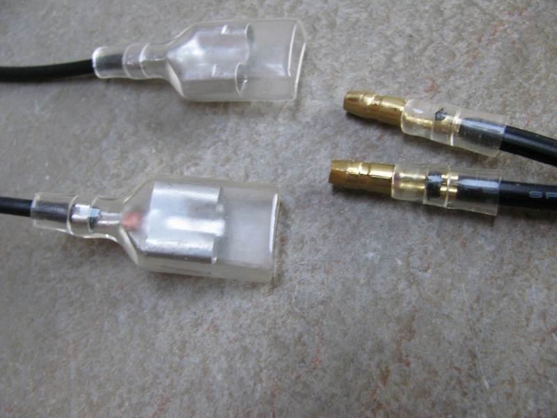

    I am contemplating looking into placing another order, however, this time I was thinking of implementing a SPECIAL twist with them!!! What do you think about adding a bullet connector splitter like the following picture on the end?
    By adding the splitter on the end, it allows you to plug in only 1, or 2 different connections if needed. I'm looking at this as a perfect opportunity to implement another way to connect two essential mods that I feel our Taco should have come with in the beginning: Tailgate Actuator and Power Folding Mirrors. As most of you know, I sell these PNP Harnesses as a FULL KIT or just a HARNESS option. However, I am closing out my current batch of 300 and I need to decide what I am going to do next. I've been getting asked to purchase more, but I have to purchase 300 at a time. Which is exactly why this led me to think of this option. I can kill two birds with one stone. I will change up the end connector to make a splitter and therefore, you are able to connect both your Tailgate Actuator and Power Folding Mirrors. :bananadance:
    As for the 4Runner community, your PNP Harness will be more like the current one pictured above as you do not have a tailgate that needs an Actuator. However, please let me know if there is another mod that you can connect to your Lock/Unlock Wiring System that this would be of good use and I can definitely implement the same splitter on the end verses the single bullet connector. :)
    Please let me know your thoughts. Trying to once again, make another install as easy as it can possibly be on my customers. However, if you don’t think you would use this and you would rather just tap into the Lock/Unlock Wires that are in the Door Panel, let me know. If I place another order of these Harnesses, I have to be able to sell 300 of them and trust me, that’s a lot of Harnesses (x2 now). Therefore, I’d love some honest feedback. ;) P.S. Before anyone asks, when I do finalize what exactly I want to order, it is a 3-4 week waiting process on these Harnesses.
