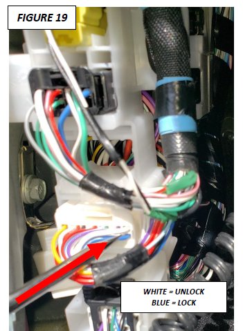

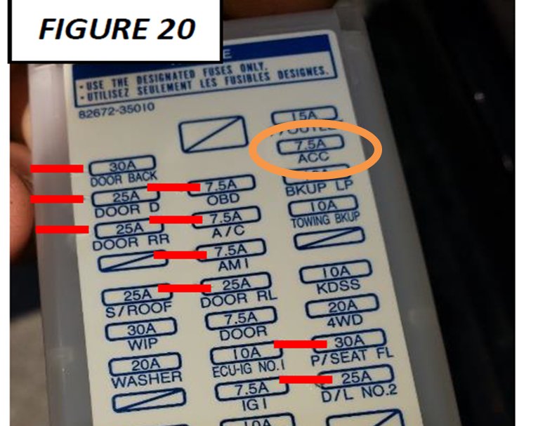

    I think you just wouldn't connect the White wire to the locking system in Fig19?
    Could it be this simple? Maybe add a switch to this wire to have the option. I'm guessing on the wiring here.
    Image from install guide.

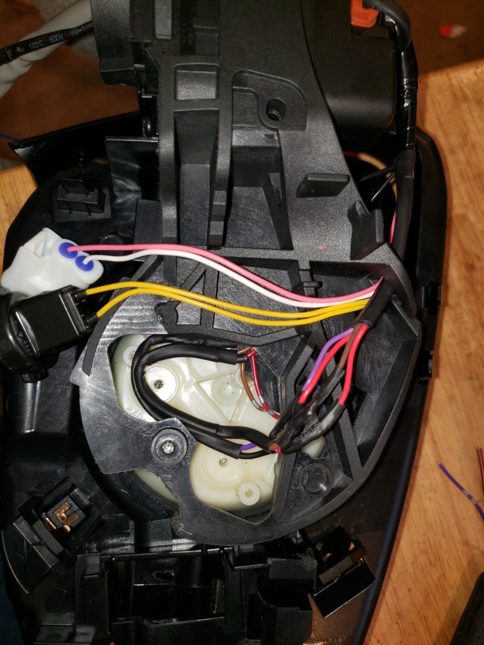

    Started on the Mod today. :bananadance:
    Followed all the steps in the guide and I've got the drivers side mirror swapped over with the new parts. Other side should go faster tomorrow.
    Couple of tips:
    1) when your doing some grinding to one connection plate do the other side at the same time.

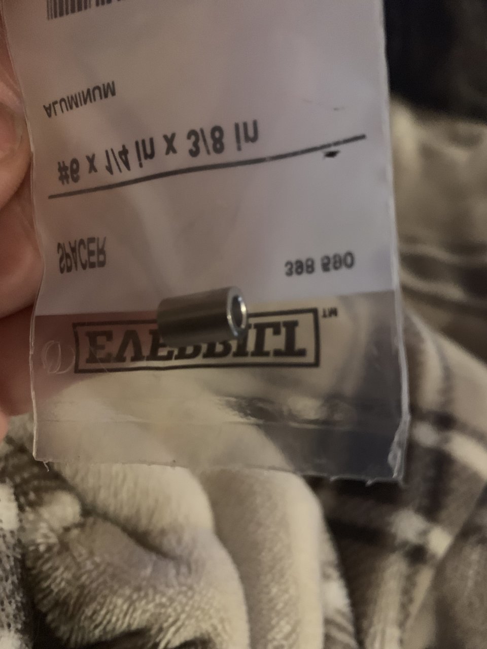

    2) One thing I did is add a spacer/washer for the mirror adjuster to make a more secure fit to the connection plate since only one screw now holds it all together. The spacer is just some aluminum tubing, if I would have cut it long enough the washer wouldn't be needed.
    3) Had to make my motor wires about 6in. longer to get through my wire loom and lining up with the other connectors.
    This guide is well written and great pics. :thumbsup:

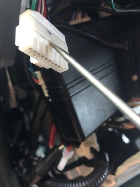

    Done! It's Alive! Mirrors Fold and Unfold, and Fold and Unfold. hehe
    Notes:
    -Mirrors still adjust but you have to clock everything CW in your head. Right is now up and Left is down.
    -Only thing not working is the L/R mirror switch backlighting? Might need to move a pin around or does it even have backlighting? :confused:
    -Putting the 2 pins into the OEM O1 connector took me for a little ride, little suckers wouldn't push in and I didn't want to force them in...until I saw this.:annoyed:
    -The plastic keeper on backside of connector needs to be popped out and the then pins will slide right in.
    7bf1099e-2e07-4773-ae3e-2205ed6a1865-ori_29ea8eaba191f4321065cbef2e0c20e101aa7a39.jpg

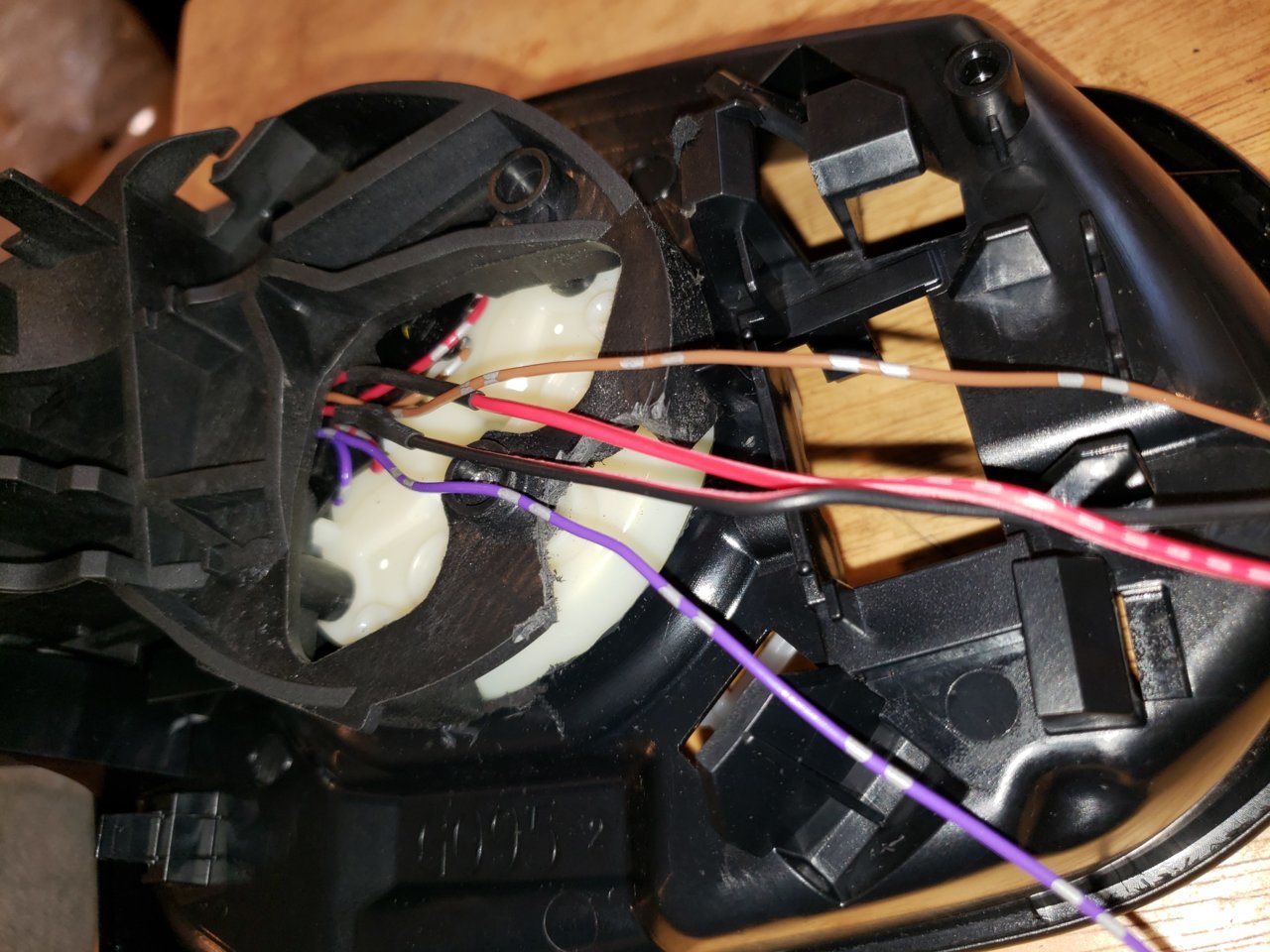

    Here is my adjuster and where the wires come if that helps for the orientation.

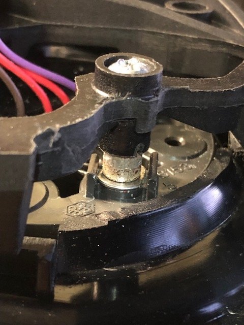

    So your Adjusting Switch is off? Is that correct? I’m thinking that is due to the rotating of the adjuster? I’m thinking of a solution for this. I was wondering if this would be the case or not. As for the backlighting on the switch, I do not believe these switches have the backlight in the research I have read but I have read where some people have made mods out there to convert the switch for the backlighting. All of Toyota connectors have that locking device on the back of their connectors. You pop it up and then you can slide in the pins. Just like if you want to remove a pin you lift the locking device and use a distractor and they slide right out.

    What if you rotate it back and drill into the Connection plate in the big flat area where one of the other holes line up since you only need one hole on the adjuster. Then it will be right side up and everything should line up perfectly?

    I think just rotating the adjuster will fix the issue, hopefully the next screw hole will line up. :fingerscrossed:
