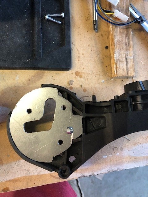

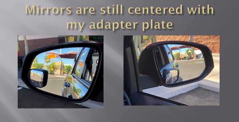

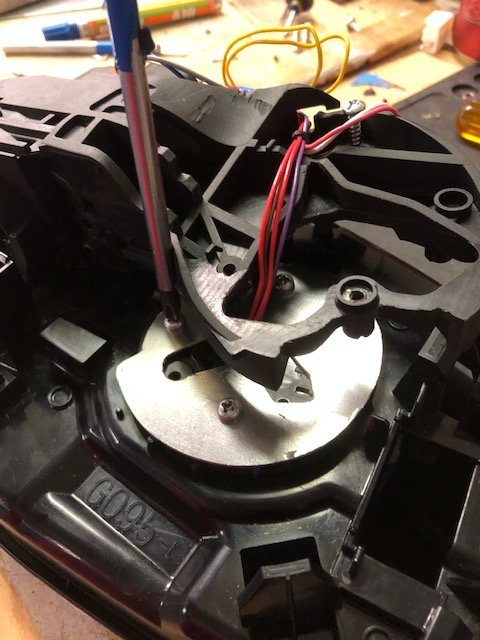

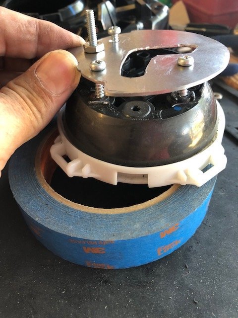

    I got it all lined up now, U/D/L/R are all good. Had the actuators clocked 90deg out. Turned them CCW to fix.
    I also went ahead and made an adapter plate which uses all three actuator mounting holes and then attaches to connection plate. This took awhile doing the arts and crafts thing before finally doing it in metal. But my idea actually worked. I'll post some pics later.

    Ok, Here's the metal bracket I made.
    22f9e790-9061-4aea-aeeb-c17fbe1a3a9a-ori_8db31dd152cf7ad8adb39f41451434e2b90bbe61.jpg
    311f7938-9fcd-43c1-888c-c85584016e9e-ori_b70e5e0d1b0f4fc98be43a274f8d79a27bb72107.jpg
    235e94fc-7307-4823-b173-ff4502f1235d-ori_4426c6b603074ae214b7e96813811bf90a8ccc0e.jpg
    f1ce6740-5ad2-4580-9a3c-c03c97a769ac-ori_4350c3e711adbf19baac473d073d999c3f2131be.jpg
    6d945ddf-3381-48ca-a1a1-4c5d437c2441-ori_dac00b16b9eaf4f95d7291b3ae456c161f67b9c0.jpg

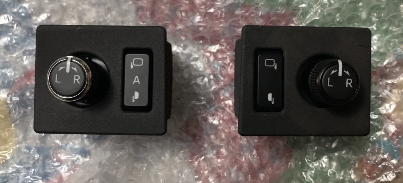

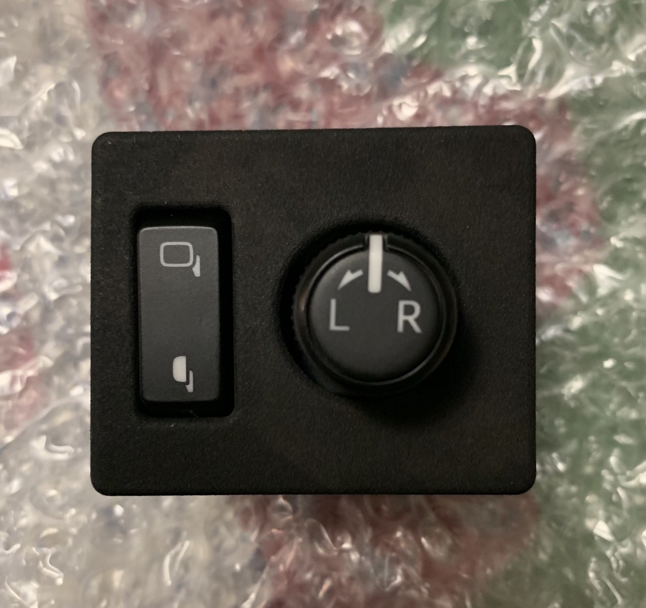

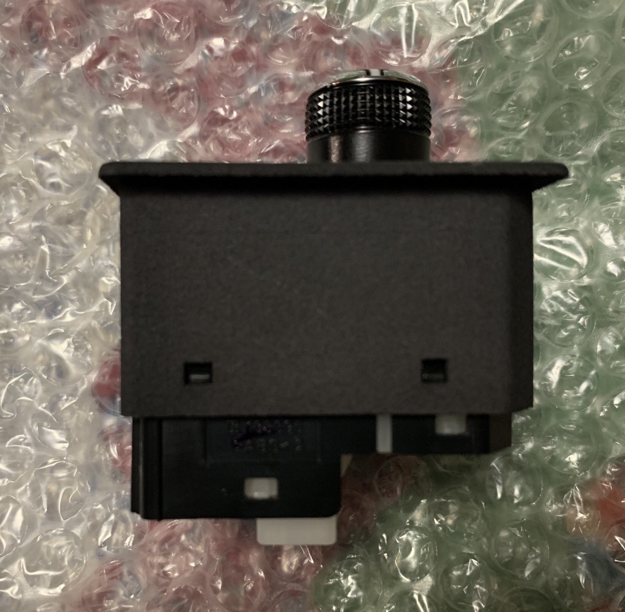

    1. Box of Tacoma Extension Harnesses got Shipped today!6A8B2D25-7E23-4263-AA63-1E3505976B0E.jpg

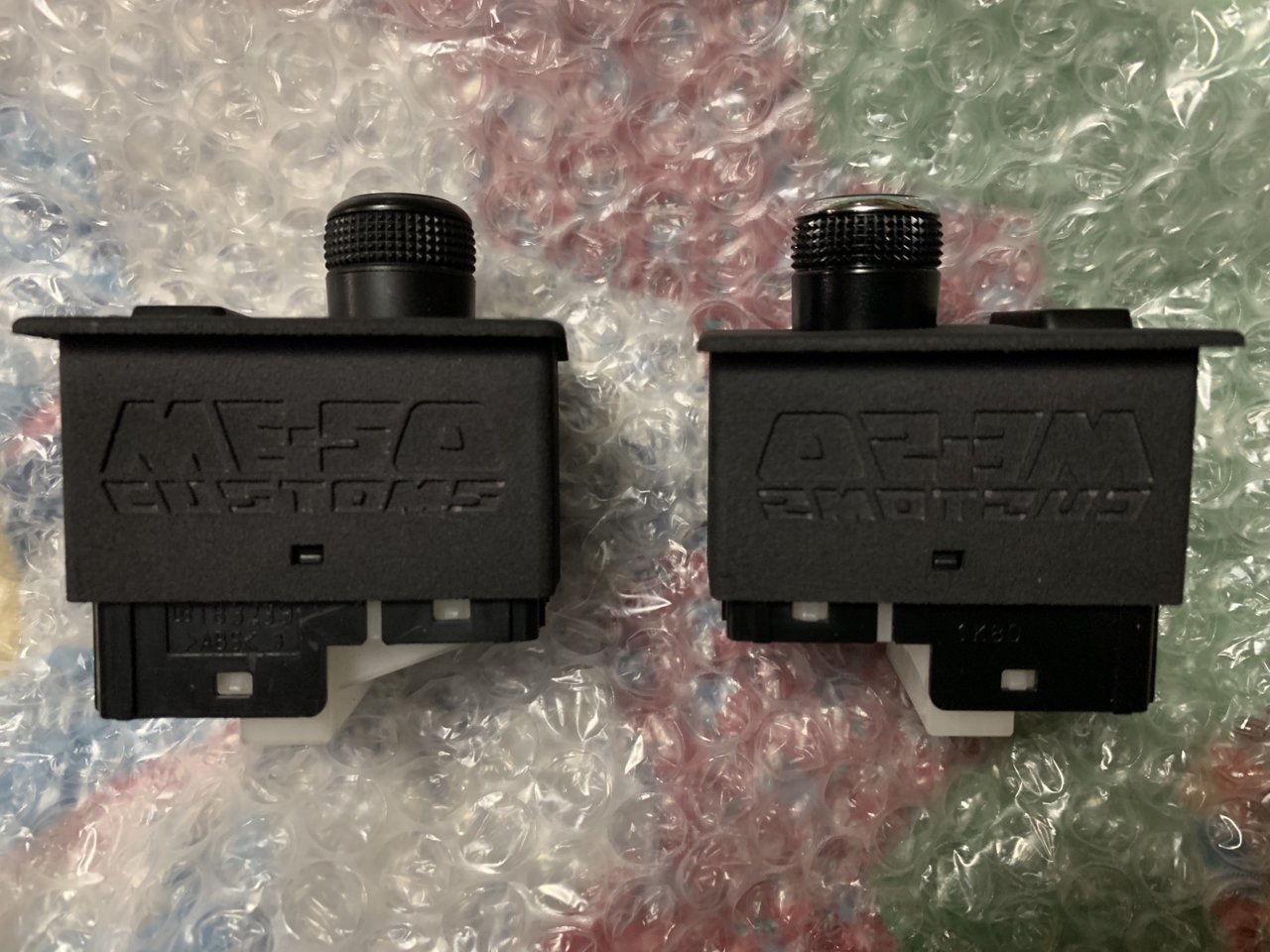

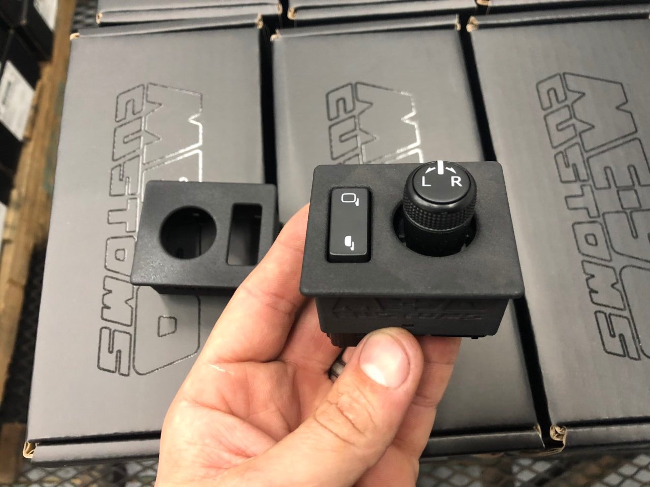

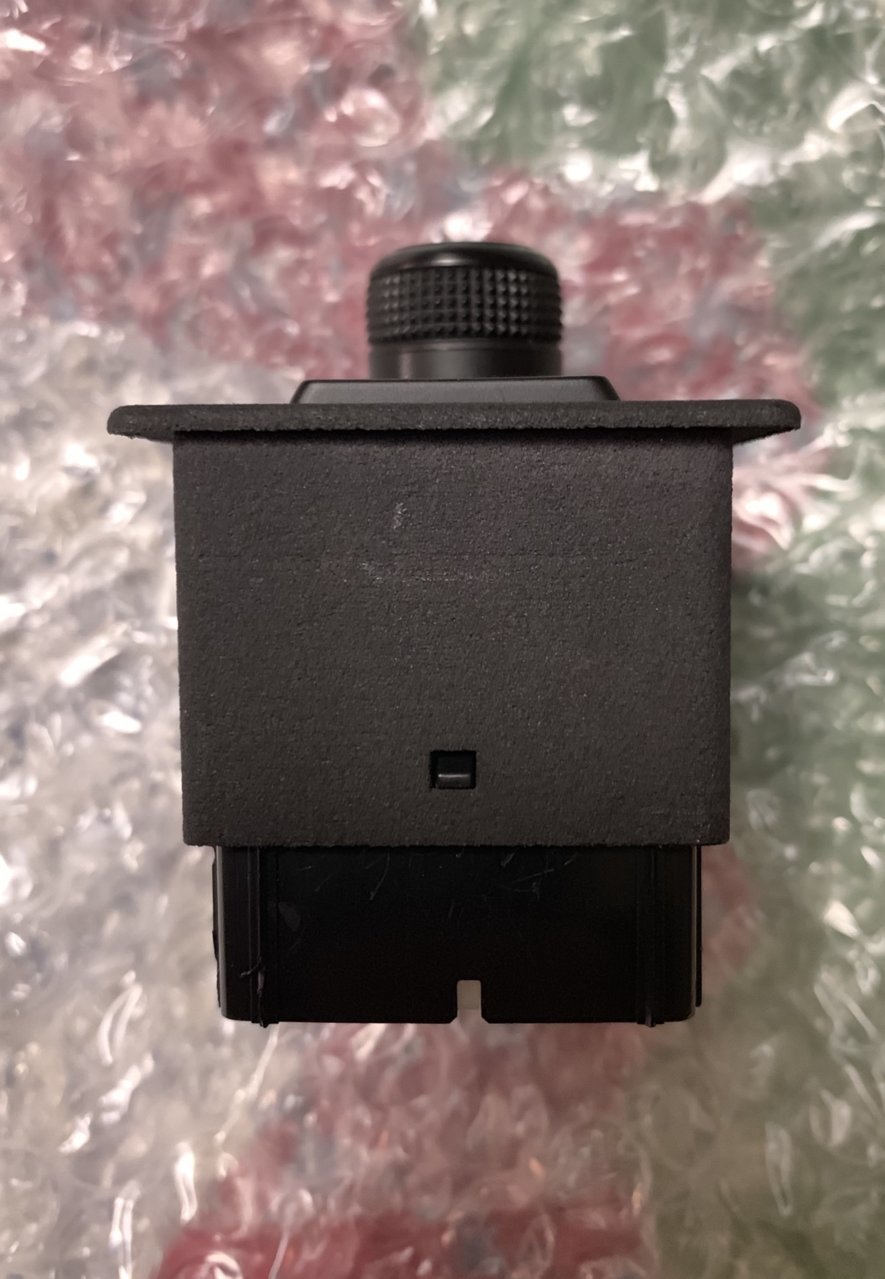

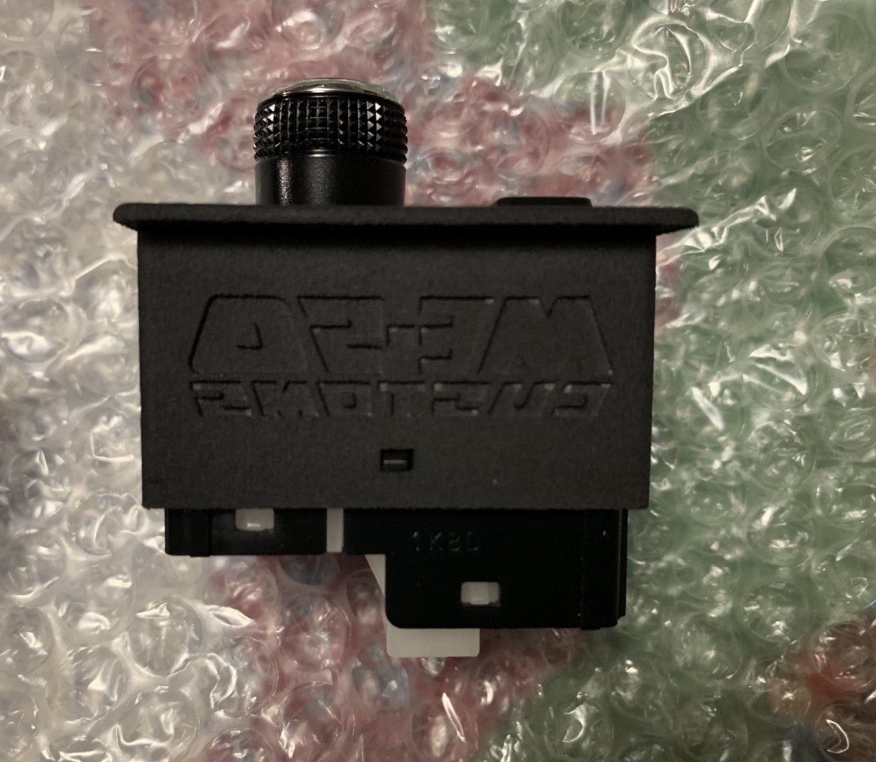

    2. Look what I received in the mail to test out!28CD8DA9-8A8F-4BC8-AD85-EDCC59FBB4EF.jpg 0BC26A3A-CAA3-452A-A5F8-73E7E5280FE5.jpg0FFA6AF2-CCE7-4997-80FA-202346C88FEA.jpg 04B2E397-9F7F-4D8A-812C-BA8E4C7A9931.jpg 444CA094-D32B-488A-BCE2-EA907AB15592.jpg 6251F609-1944-490C-81B6-17F3CC96B9C9.jpg AB1A1F64-C9D6-44D5-9B1D-1A0020B93E71.jpg F291F655-2B71-4DA7-A0BB-820D6285AD05.jpg

    Does anyone have a pic of a prototype of this product? I'd like to see the end result before putting my money down on something that could be potentially useful.
    KTJO 4x4[OP] likes this.

  14. Apr 23, 2019 at 11:13 AM
    #334
    NoOne
    NoOne El Taco Guapo
    Feb 6, 2018
    #243575
    5,824
    Ø ©
    Gulf South
    2022 Tacoma DCLB OR (AT) - BC
    2018 SR5 - (Sold) 2018 OR - RIPieces 2022 OR - BluCrush
    What is the useage/difference between the two styles?
    KTJO 4x4[QUOTED][OP] likes this.

    Two styles could be from Hilux or Fortuner.
    The orientation appears to be for LHD and RHD from other markets.

    I figured as much, for the original application. I was wondering pertaining to the NEW application... :D

  17. Apr 23, 2019 at 2:20 PM
    #337
    airmac_11
    airmac_11 Well-Known Member
    Nov 13, 2018
    #272596
    265
    2019 Cement DCSB Premium/ Tech TRD 4x4 Sport
    Yea thanks cencal_taco, I see the parts from Page 1 and how the parts are supposed to work together. I get that. The problem I'm having is while the product being offered is very cool and I'm definitely interested- cutting up the 'Arm controls' on the driver's side armrest is not my idea of stress-relief. I'd like to see a finished product or maybe a video on how this could be prefomed, before dumping will over $500 into a product.

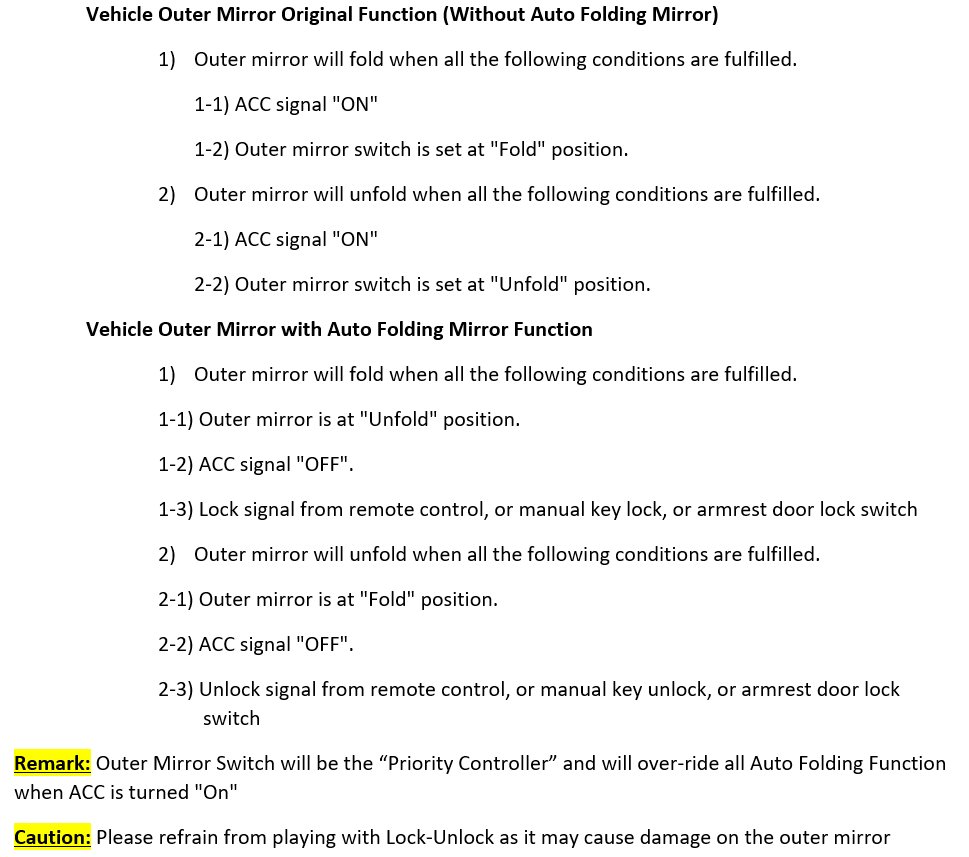

    Well one is from the 2015 Model and the other one just came out 2018-2019 model so I had to get it, but it's extremely hard to get and ONLY offered right now in a RH model. I'm actually having a hard time trying to find the right one that has correct back to the switch because so far I have found out there are 3 different versions of this new switch. :) The one I currently have, well I have two of them actually, but he one that works, actually is missing one prong on the top so I need to test it to see if it is needed on our Tacoma or if is something that we do not use. I'm pretty sure that it is our FOLD Wire connection :annoyed:My vendor is currently still looking for the one that does have the prong in that location. Once we find it, it should be easier to locate. It's just tracking it down so we can get the OEM Part No. The other is easier to get and offered in LH and RH model. I'm testing both and then I'm going to go from there. Ideally, I would like the Auto feature Switch. However, if I am not able to get that one, then it will obviously be the first one.
    To give the Tacoma Owners a little idea of what features are going to be programed inside the Control Kit:
