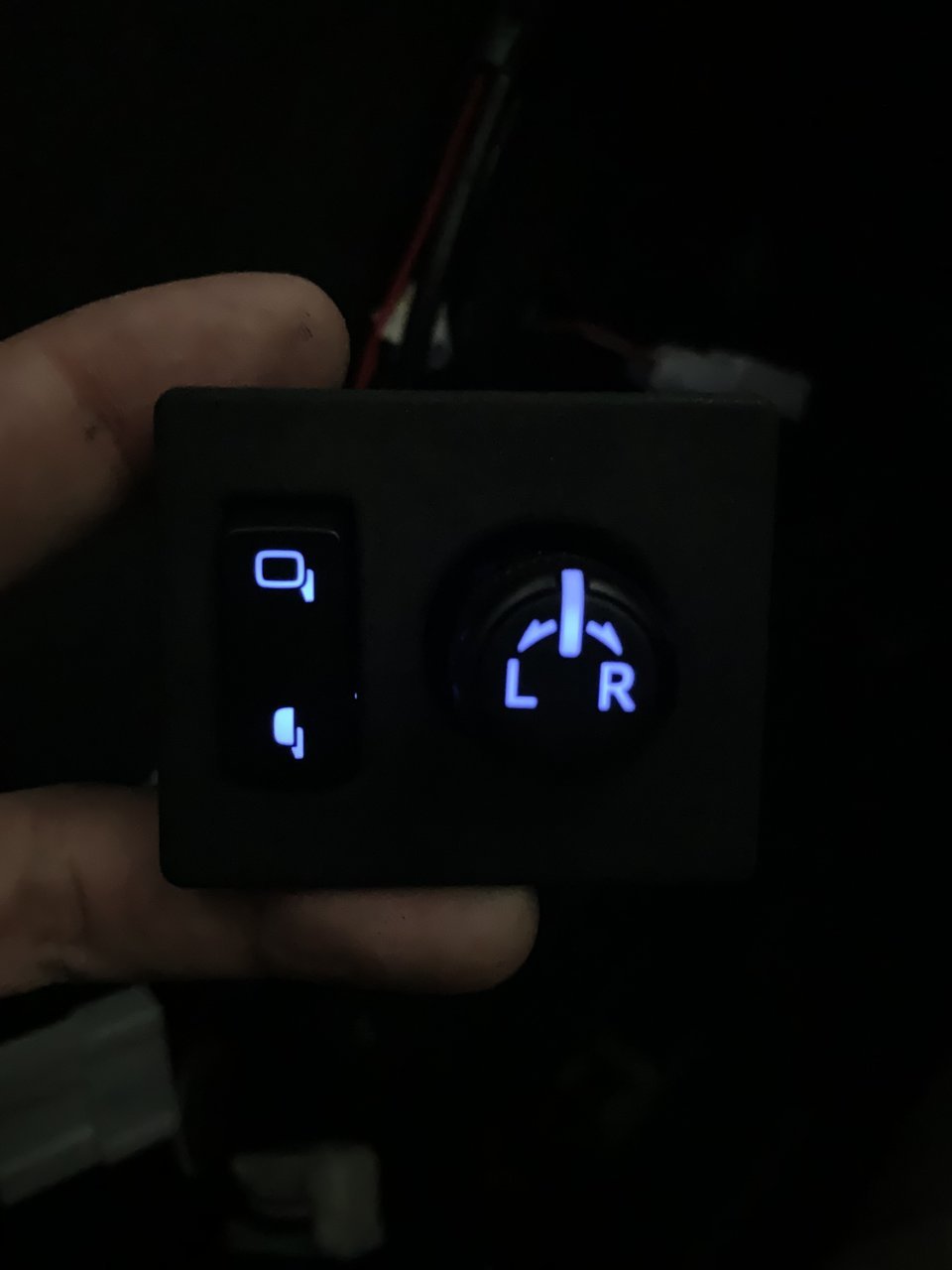

    UPDATE:
    Well worked on the wiring this weekend. I have it all wired up and I’m running into issues with the Fold and Unfold Button on the Switch. I have the Adjuster Knob working perfectly.
    I’ve tested all the wires:
    • Constant Power Wire that goes to the Control Kit lights up when I touch the Ground that I have wired into the Connectors to match up with the Ground running from the Control Kit (which I made sure was the correct Ground by just running the tester and finding the end to each wire in the Harness and matching each Wire to Wire)
    • By the first test, that also means the Ground is Good.
    • Next test was done on the Lock & Unlock Wires, which by running the tester to find the end to each wire, I did find that I had the White Constant Power Wire and the White Lock/Unlock Wire mixed up. Therefore, I’m glad I did that tester because now I know exactly which wire is which. Not that it really matters or changed anything, but it’s still nice to have a complete wire pinout to the Control Kit Connector. When I ran the test on each of the Wires, the Light came on and then shut off. Just like it is supposed to do, so the Lock & Unlock Wires are Good.
    • All the Adjustment Wires seem to be working just fine as I move the knob on the switch, both mirrors are able to be adjusted in the correct direction (Up/Down, Right/Left).
    • The illumination (+) and I’m assuming (-) both are Good as well as the Switch Lights up with the Dash Lights.
    So people...what wire am I not thinking about? There has to be one wire that I am missing? It’s probably something very small. I’m super close to being complete with this. I even made sure the mirrors would Fold & Unfold so I just connected them directly to the Battery and they do so that’s all Good!

    Let’s break it down into sections...Does the mirror fold/unfold with the control module disconnected or removed from the circuit/stock setup? If it works stock, then something with the control module maybe or wiring from there as you said. What’s the pin out diagram on your module?
    KTJO 4x4[OP] likes this.

    Yep, I lost "the issue" in the post. The mirror control works and the fold/unfold works... but not with the module? Not really sure where/how to help without a better breakout of the good/bad.

    Yeah. I don’t think it’s possible to just hook it up to the OEM Switch without the Control Kit connected. However, I was able to see the other Switch Lit Up (LH)

    Try holding down on the switch?
    I had a problem with a latching switch for my nav override. When latched, the contact points wasn't making a good connection. Replaced with a new switch and works perfectly. Thank goodness I bought a set of 10.

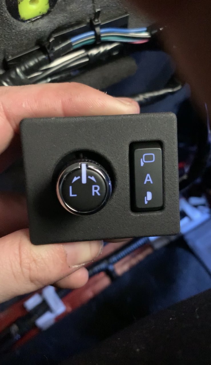

    Yeah. I might try to mimic the 4Runner harness just to see first and then go from there. Mirrors fold and Unfold when you just hook up the power to the wires themselves, so now it’s just a matter of connecting those to the switch

    where to mount that switch? any photo? Will love to see a photo. also is it automatic fold and unfold the mirror when the car stop and start?

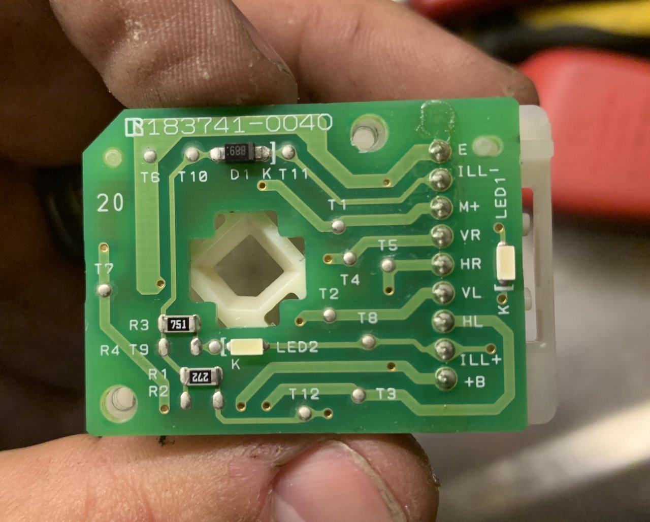

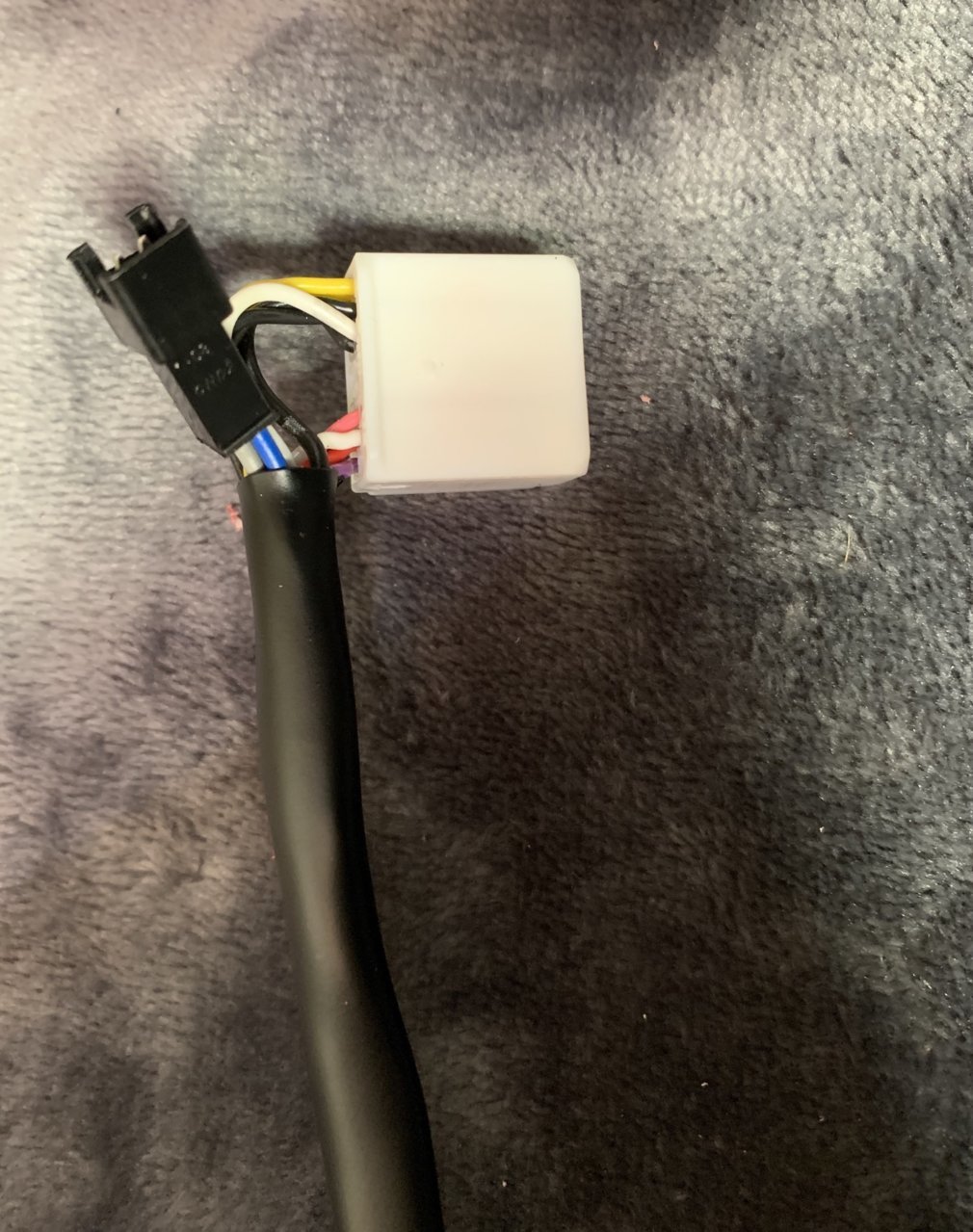

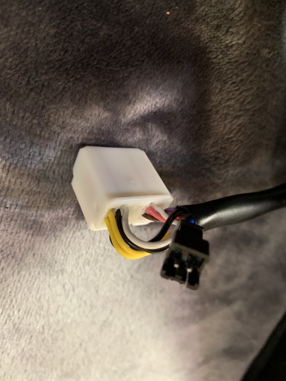

    UPDATE:
    Well I have some great news people, I got to see the Harness (ONLY) FOLD and UNFOLD the Mirrors last night for the first time. I took my truck up to my cousins shop and we just kept throwing different combinations out after different combinations. That’s the only thing I could think of and it was my last resort with this harness. At this point, I tested and tried everything else. Let me tell you, it was such a relief when I finally was able to see those mirrors go in and out for the first time.
    After that, my cousin actually took the switch apart bc he wanted to see the inside of it to see if my pinout diagram was matching up to the actual switch locations.
    I’m happy to say, without having a wire diagram for this harness or anything to go by, other than our truck wire diagram, I was able to invert their wire harness and make all the necessary changes to match up the wires and they did in fact match for at least the bottom portion of the switch. :bananadance: We put the switch back together and for the first time, I was able to see the Mirrors FOLD. However, we were not able to get them to UNFOLD. So, that means we have to work in the other side of the harness now, and see if maybe I need to flip some wires to have them match up. But.....it’s getting there :thumbsup:

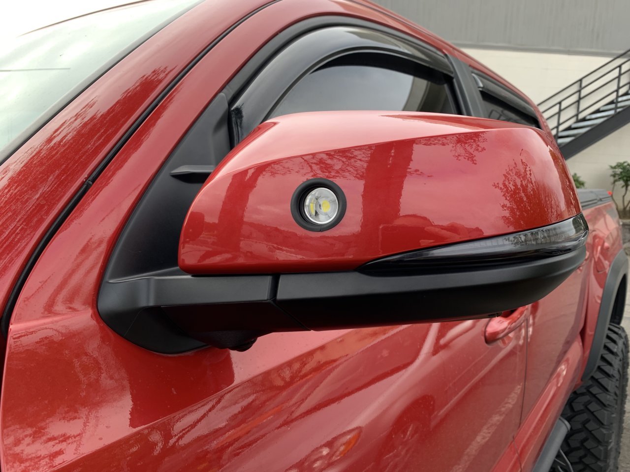

    What lights are these? When I search for "Rigid Ignite Ditch Lights" I see something completely different. Link to the actual lights used, please.
