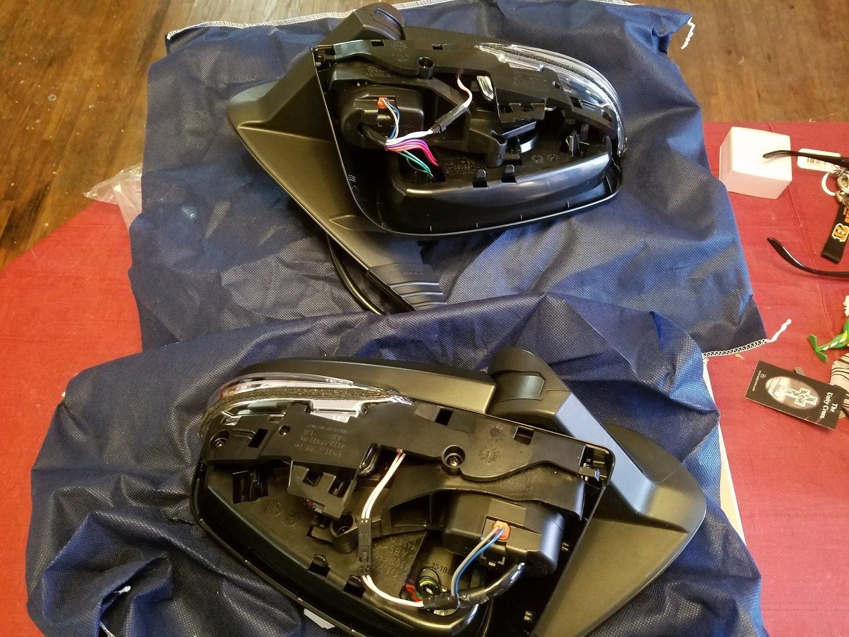

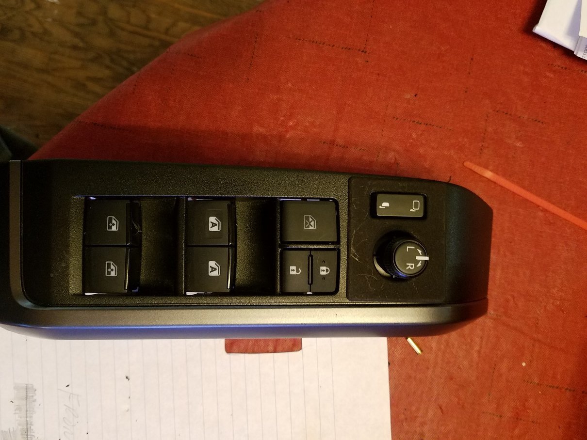

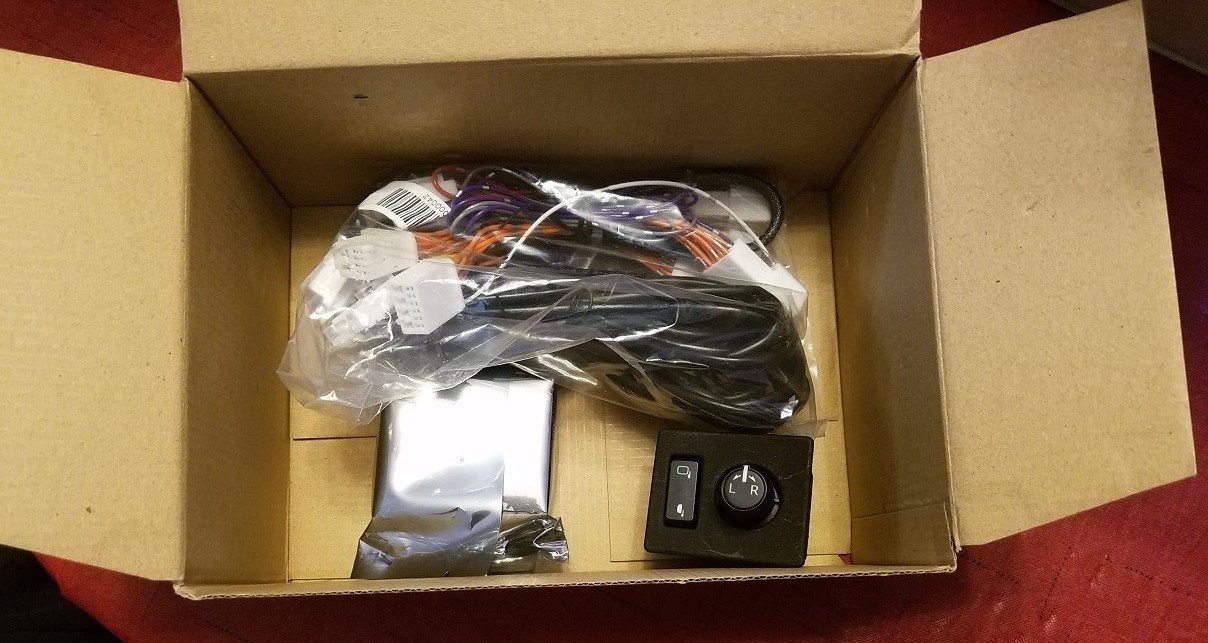

    I had intended to take the unboxing pictures to also help with repacking to return my mirror housings. But, the packing is straight forward for the return, but very professional and I felt compelled to share.

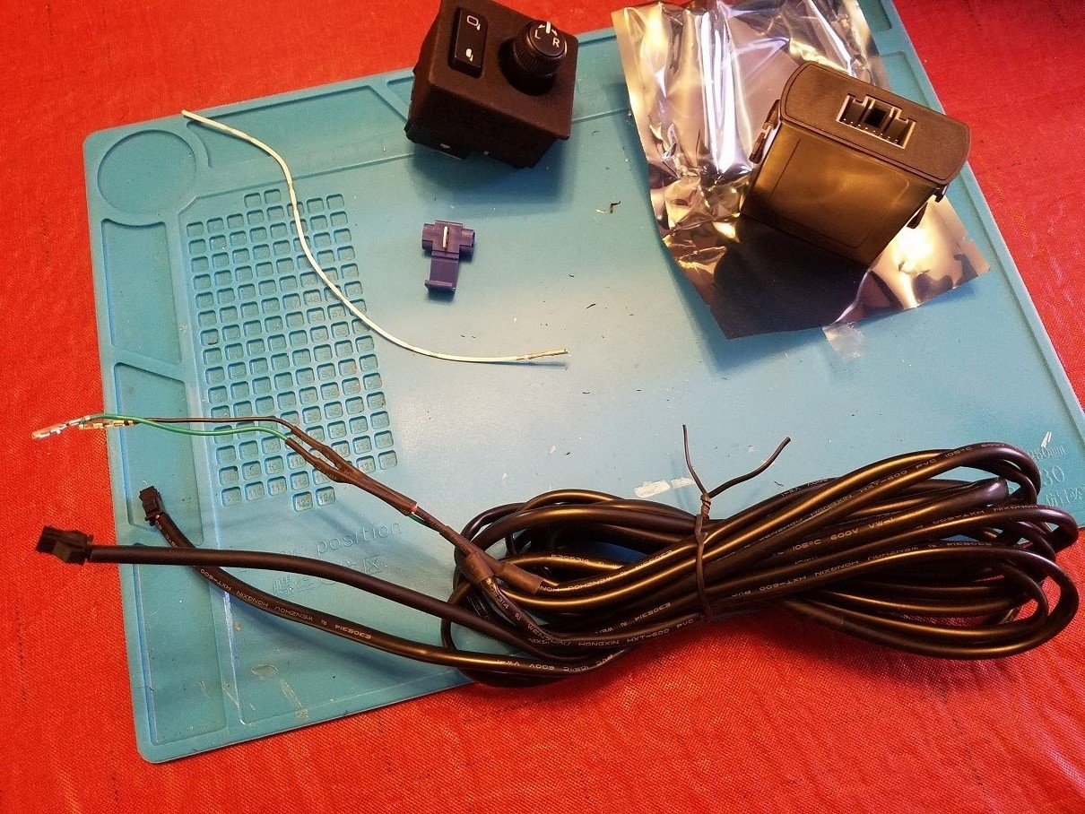

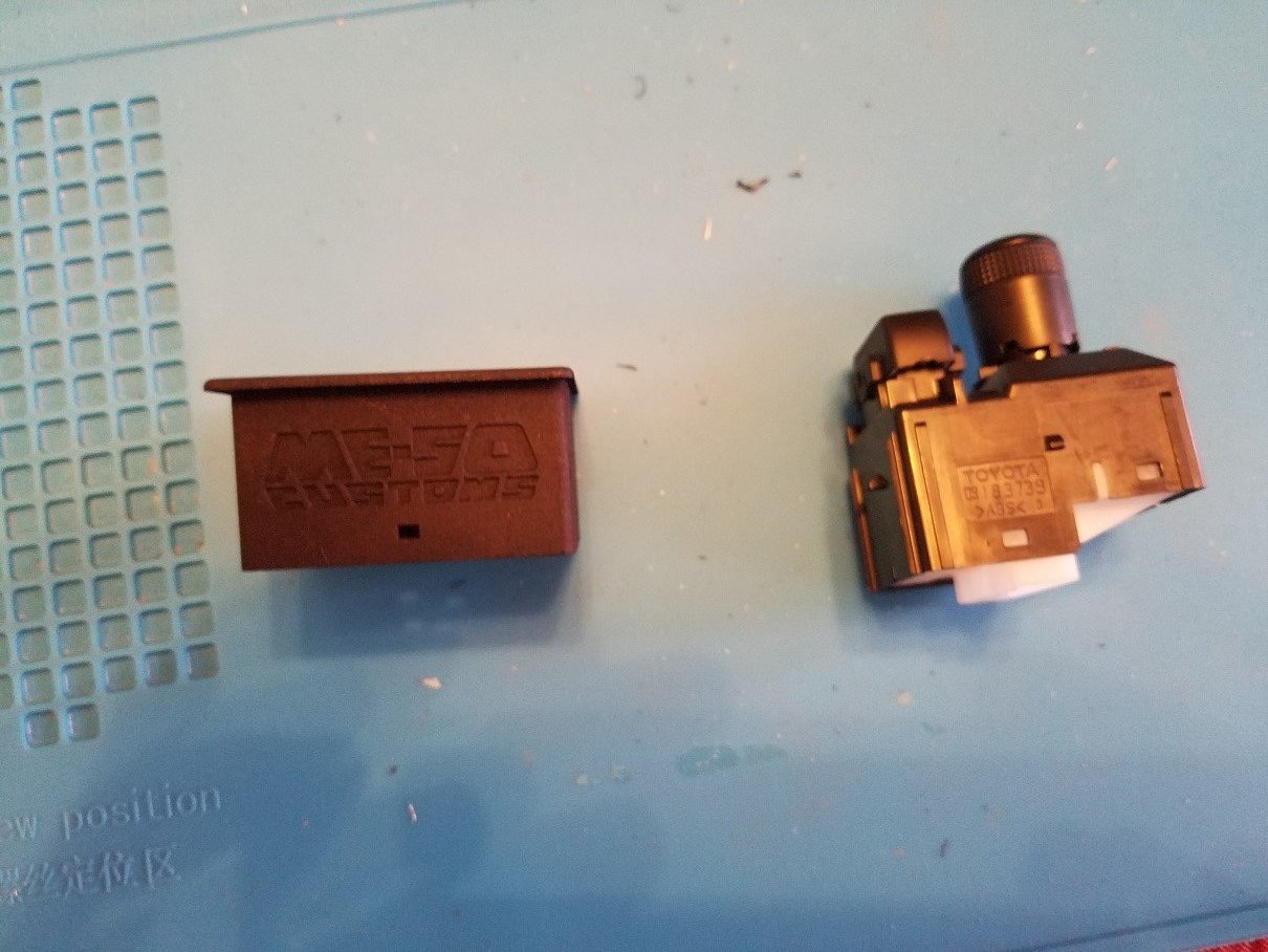

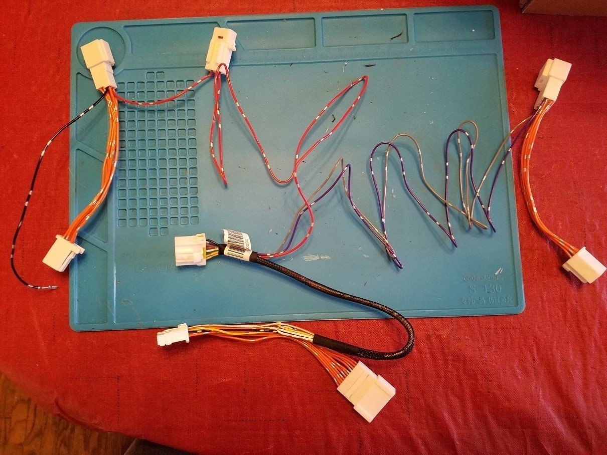

    I am going to re read the installation post a few times to familiarize my self with the harness again before I tear into the door panels tomorrow morning.

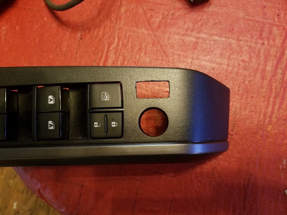

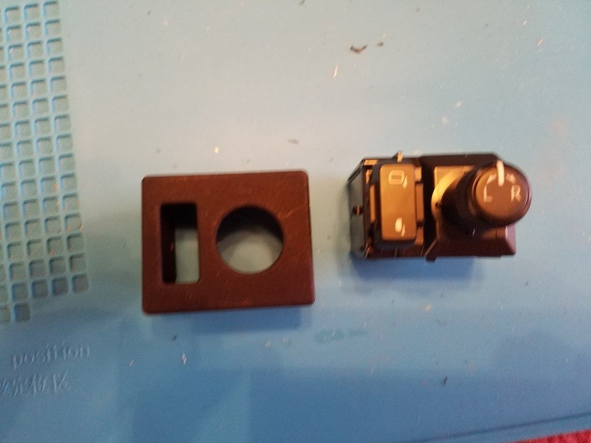

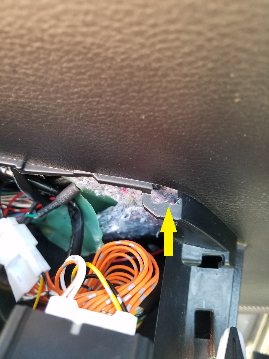

    I am going to try to cut the factory bezel to fit the switch first. If that goes south, I will enlarge the hole and use the MESO bezel.
    Side note: there are 5 latches in total around that housing, it is a little tricky to extricate the switch from the housing. If you go this route, Take your time and make sure you have 2 or 3 very small screw drivers to carefully pry the housing off the latch while applying gentle pressure to push the switch out. Slowly and carefully work your way around and it will eventually release.

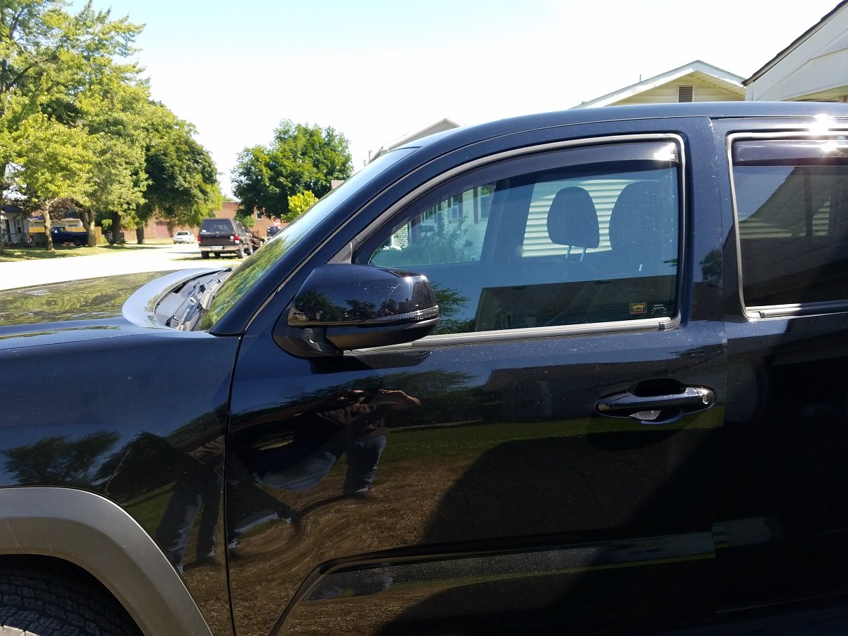

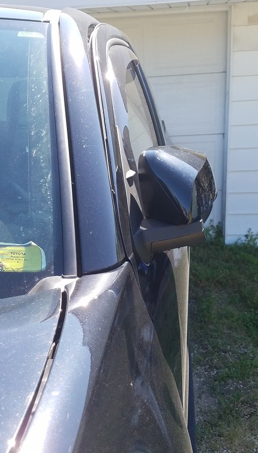

    I have the driver's side installed, I'm still working on the wiring. Here are a few shots of the mirror in place. please excuse the upper housing. Bugs are crazy here right now and I wanted to wait until after install to wash the truck. I figured it would be a good test drive for the folding feature.

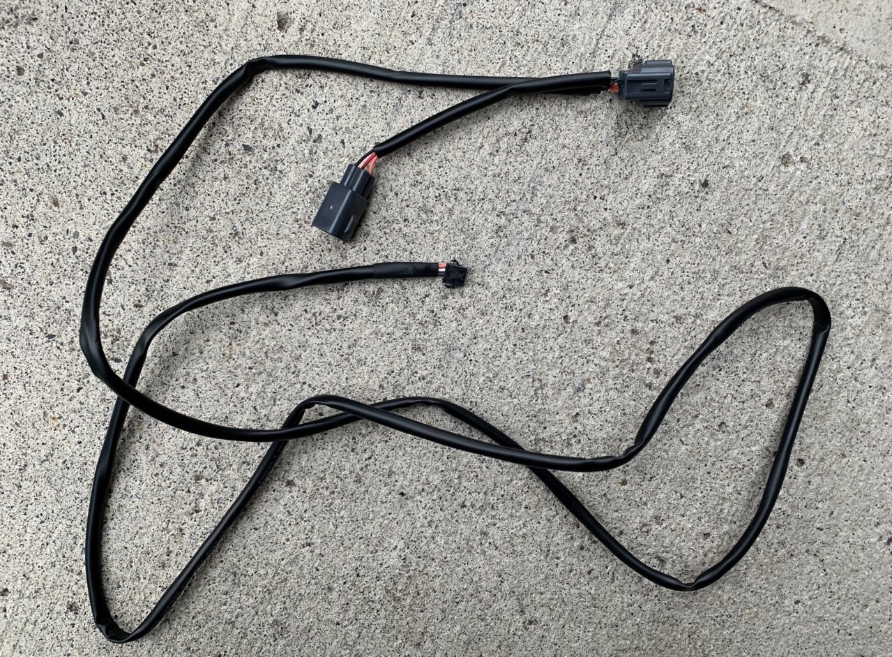

    I actually finally had time to make my own DTRL PNP Harness for my Mirror Turn Signals so that they will actually turn on and off with my DTRL. This plugs directly into my Headlight OEM Connector and then plugs into my Driver that goes to my RGB Mirror Turn Signals.
    I might actually get to finish my own tomorrow :)

    If anyone is interested in this DTRL Plug-N-Play Harness let me know. I can look into getting these made. This plugs in to the back of the OEM DTRL Connector and then if you have MESO Turn Signals or if you have similar drivers this would plug into those by installing a JST Connector onto the White, Black, and Orange Wires of your Driver.
    For others wondering the same question about the Flexible Tubing I used for this Harness, it is the same stuff that is used for the Extension Harness with the Power Folding Mirrors. It is soft and flexible for sure.

    Day Time Running Lights Harness?
    Sorry if I have missed it, but what is it for?

    It allows my Turn Signals in my Mirrors to operate with my Day Time Running Lights in my Headlights

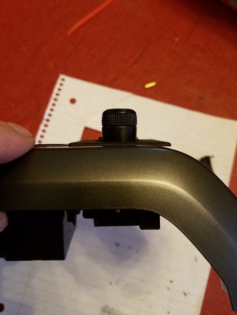

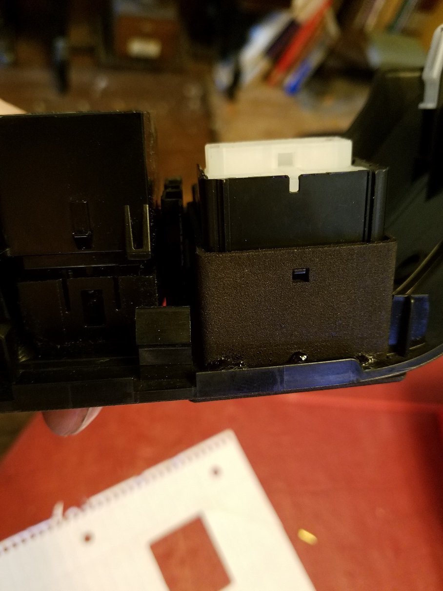

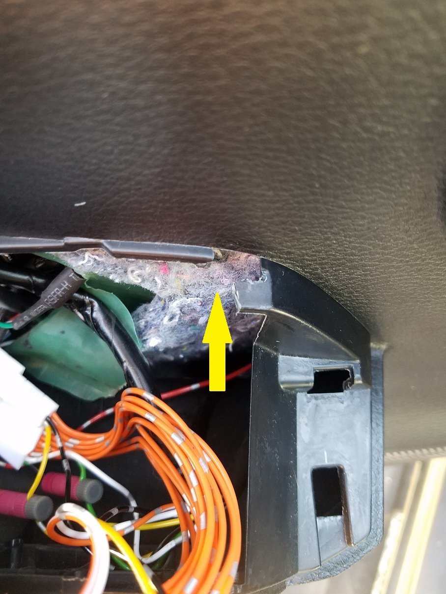

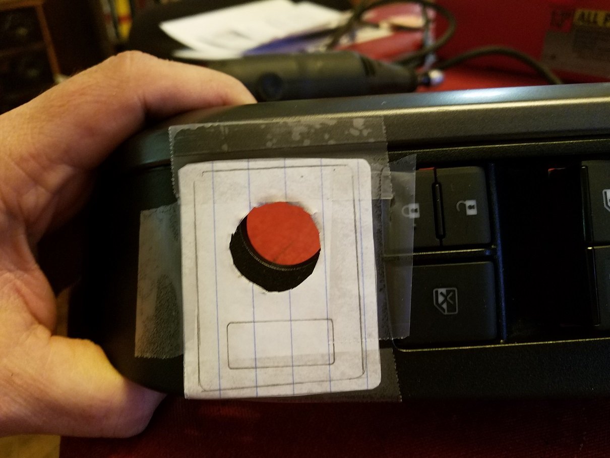

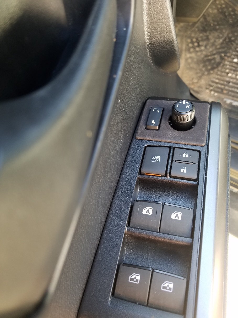

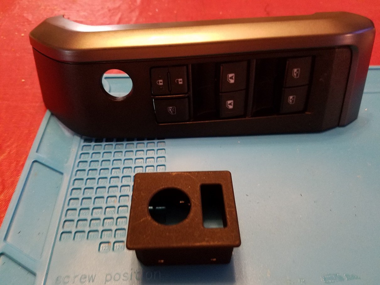

    My attept to cut the switch pocket in the bezel did not end well. I spent the better part of the afternoon, with a razor blade and a dremel. I could have lived with the cut edges. But, after the hole was cut and the latches fitted, The fold switch was not centered to my liking, so I went with the included bezel. I will include one pic of my first attempt.

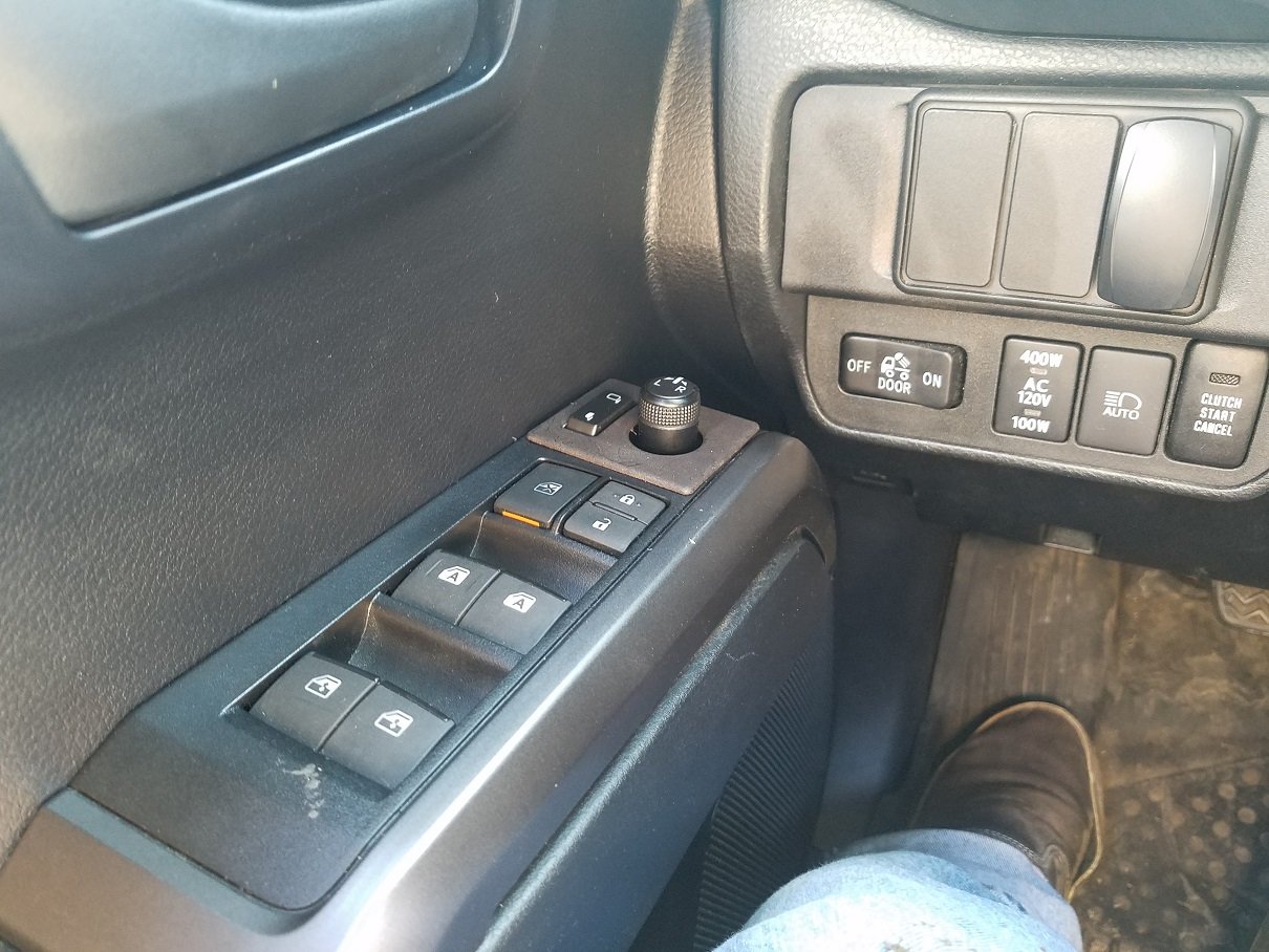

    I measured the included bezel and drew up a little template. I then found the placement I liked best. I cut the opening a hair too small to start so I could adjust and shift at the end. It does sit a bit forward, and therefore does have a slight overhang, but that's in the front and I won't see it. I could have moved the template back a little, but I was already a little close to the window control switches for my taste.
    20190714_162548.jpg Notice how close the switch housing is to the attachment clip on the right side of this picture. I should have thought about push it back a bit.20190714_162519.jpg
    KTJO 4x4[OP] likes this.

    OV Tuned, S&B Intake, MBRP Dual black Cat-back, accumulator delete, URD SS, 2LM, SSO Hybrid bumper/Warn 10kSynthetic, Custom Car Grille, MESO Ultimate Turn Signal in KTJO Power Folding Mirrors, Genesis Dual Battery, BHLM with LED upgrade, Fog delete, Geko Bed & Underhood lighting, Rear camera anytime, Nav Block Override, 400W anytime w/ interior outlets, USB charging stations, DE-badged, TVD blackout kit, HiLux interior door handles, Hybrid SS/Delrin Shift Knob, Cali-Raised bed Stiffeners, Ultimate Tailgate Seal, "El Dorado" Dual-quad horns, Diamondback HD cover, Mobtown engine/trans skid plates, RCI control arm skids, JLT oil catch can, Meso overhead Hex rack.
    On to install in the vehicle.
    This is where that alignment tab is supposed to sit. I had to clearance it a bit due to where I mounted the switch housing.
    After that it was all good.
