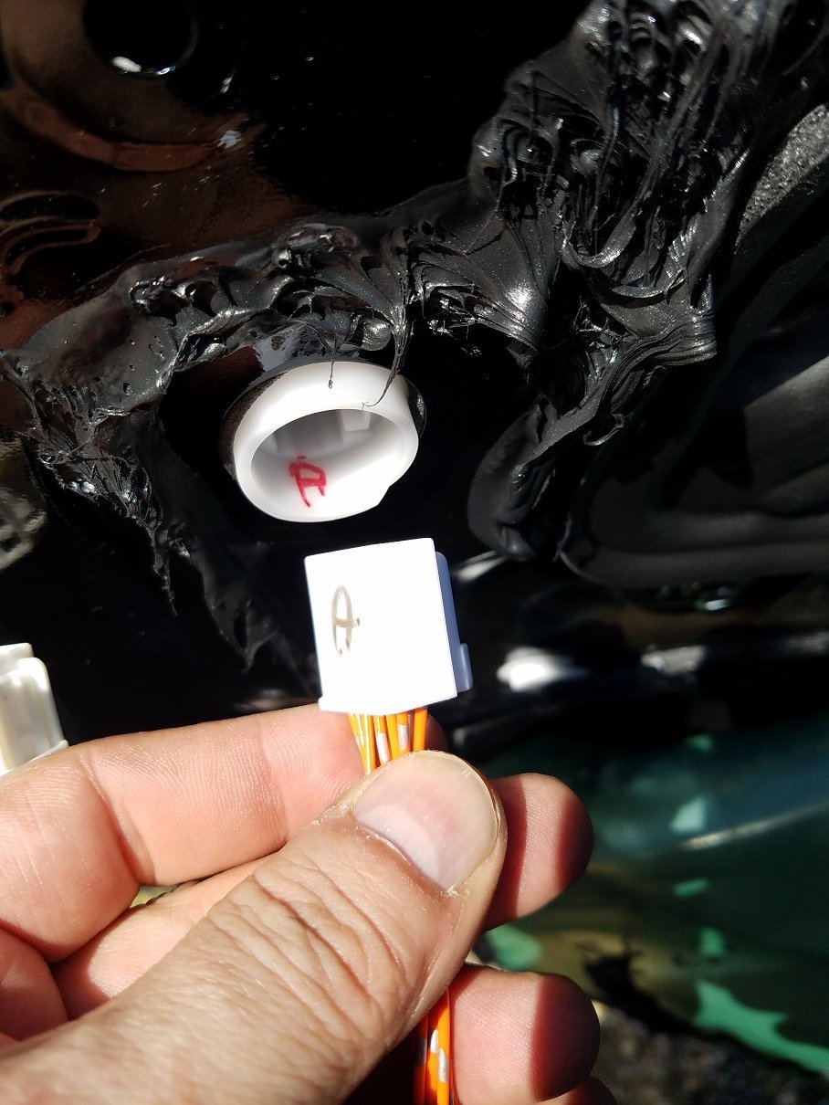

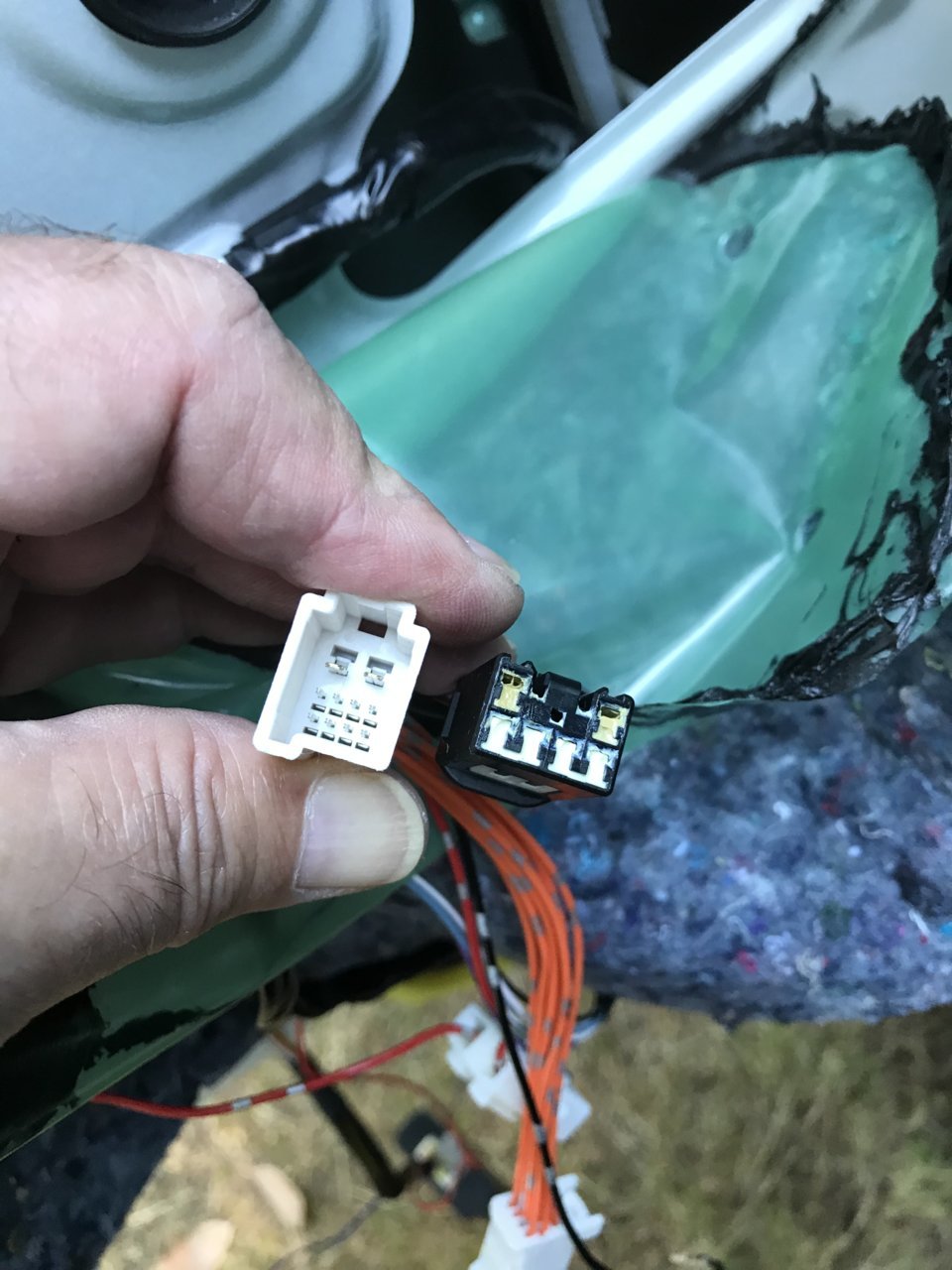

    I have a question for ya, during your Harness install on the driver side, did ya find any male connectors that don’t match up with a connector on the door?
    Looks like you have a Off Road/ i have a SR5 I don’t know if there’s a difference. I found one that match. Thanks for any help. Nice job on folding mirror mod.

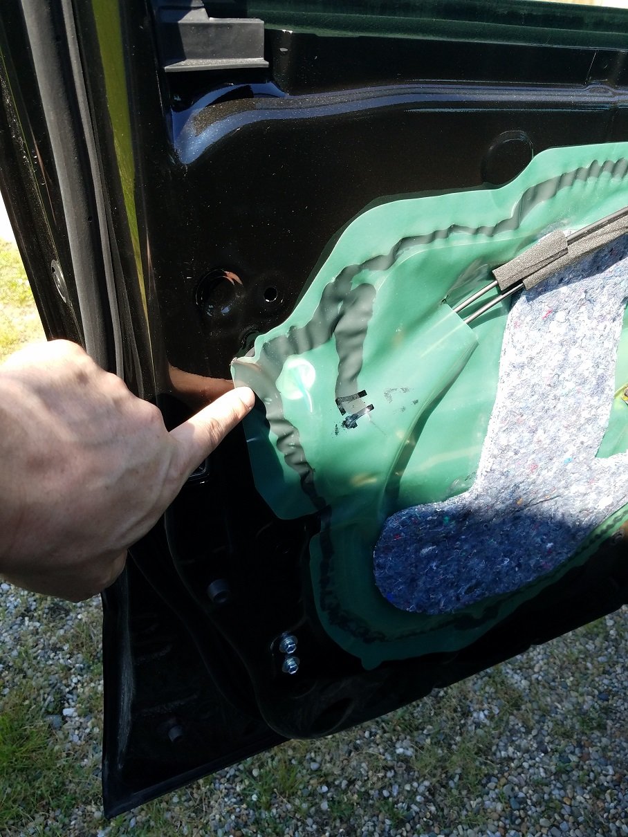

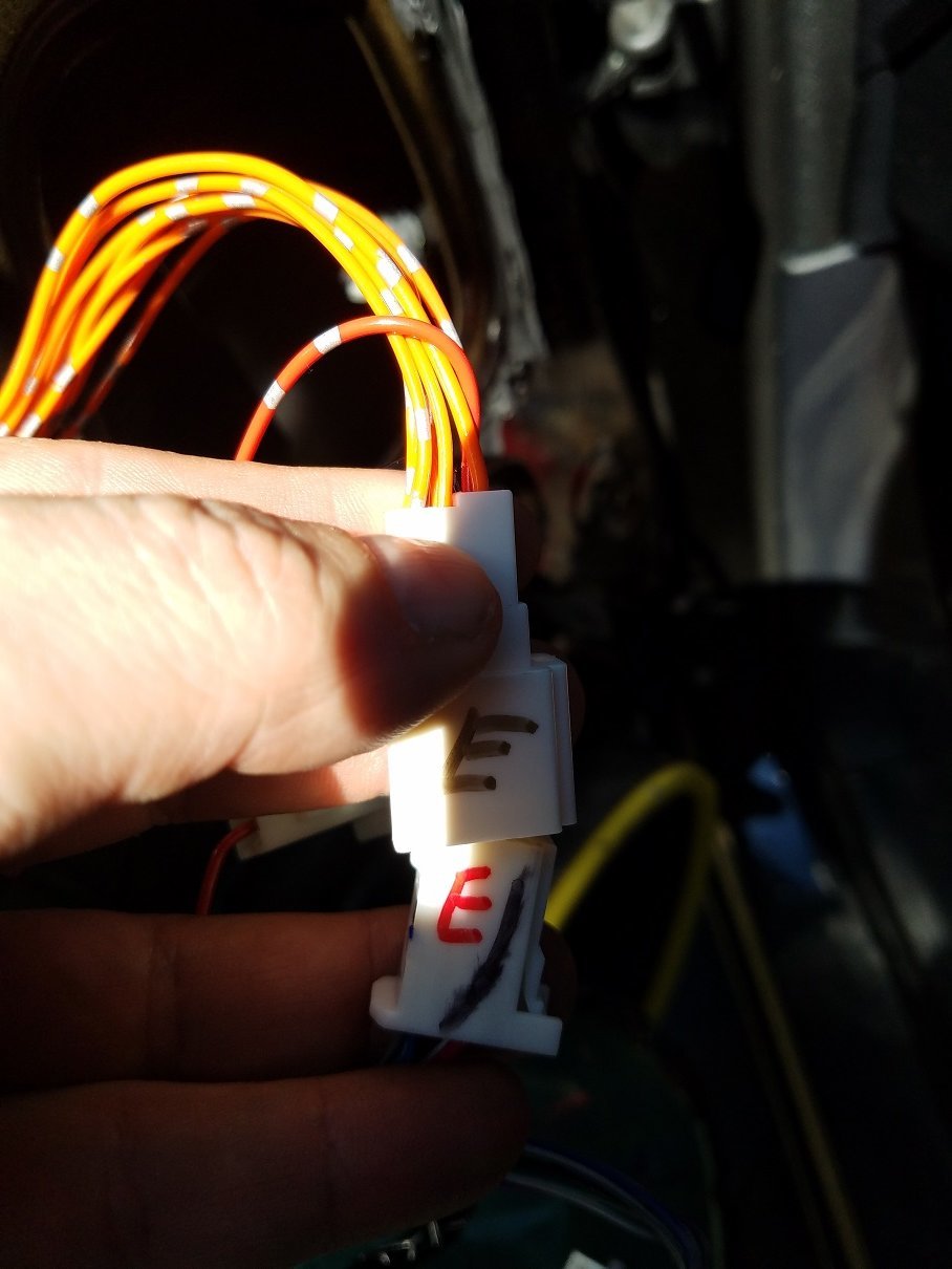

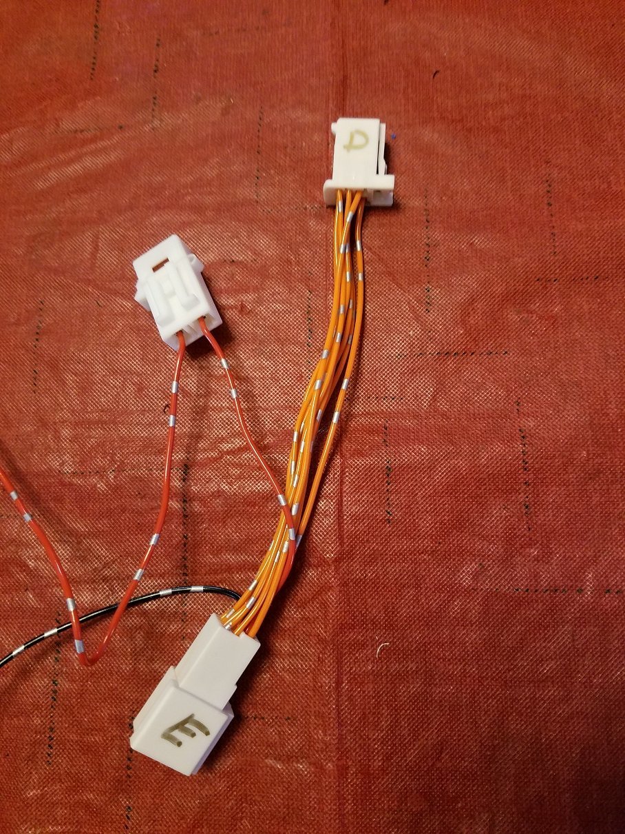

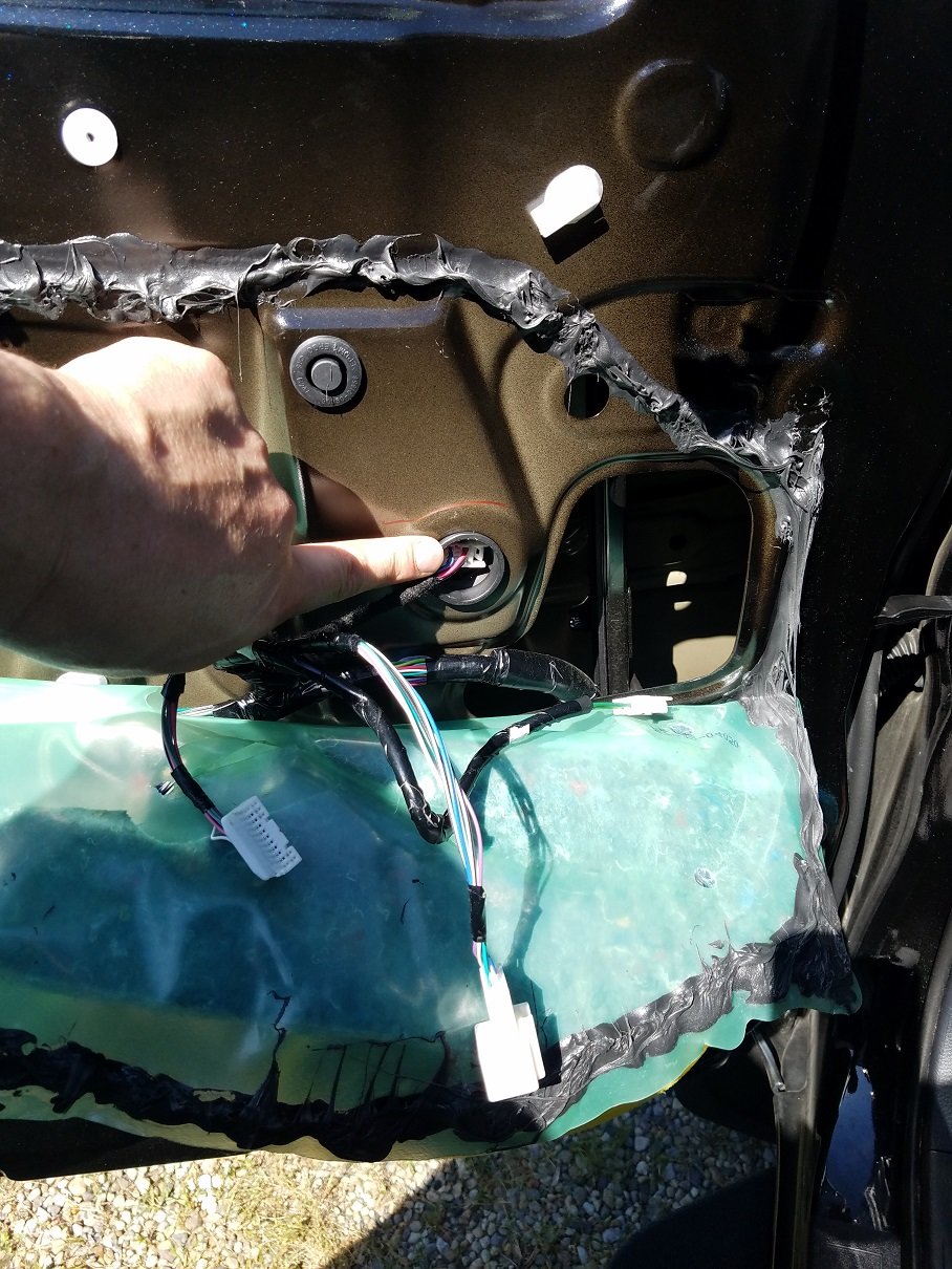

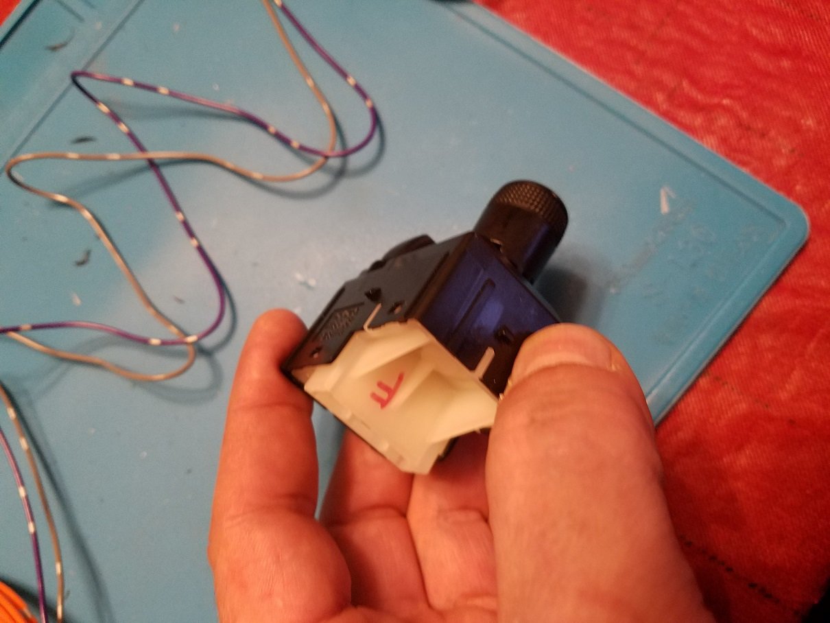

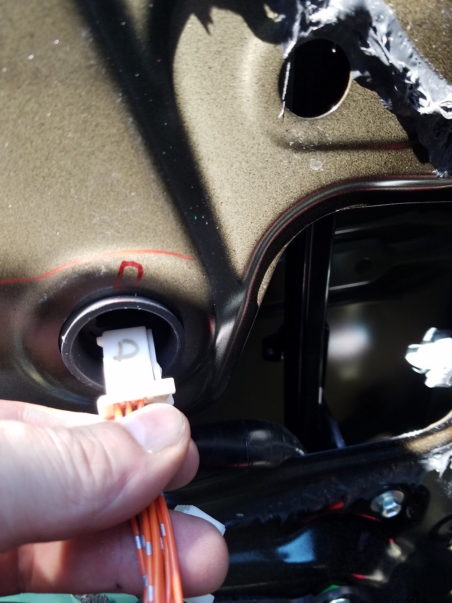

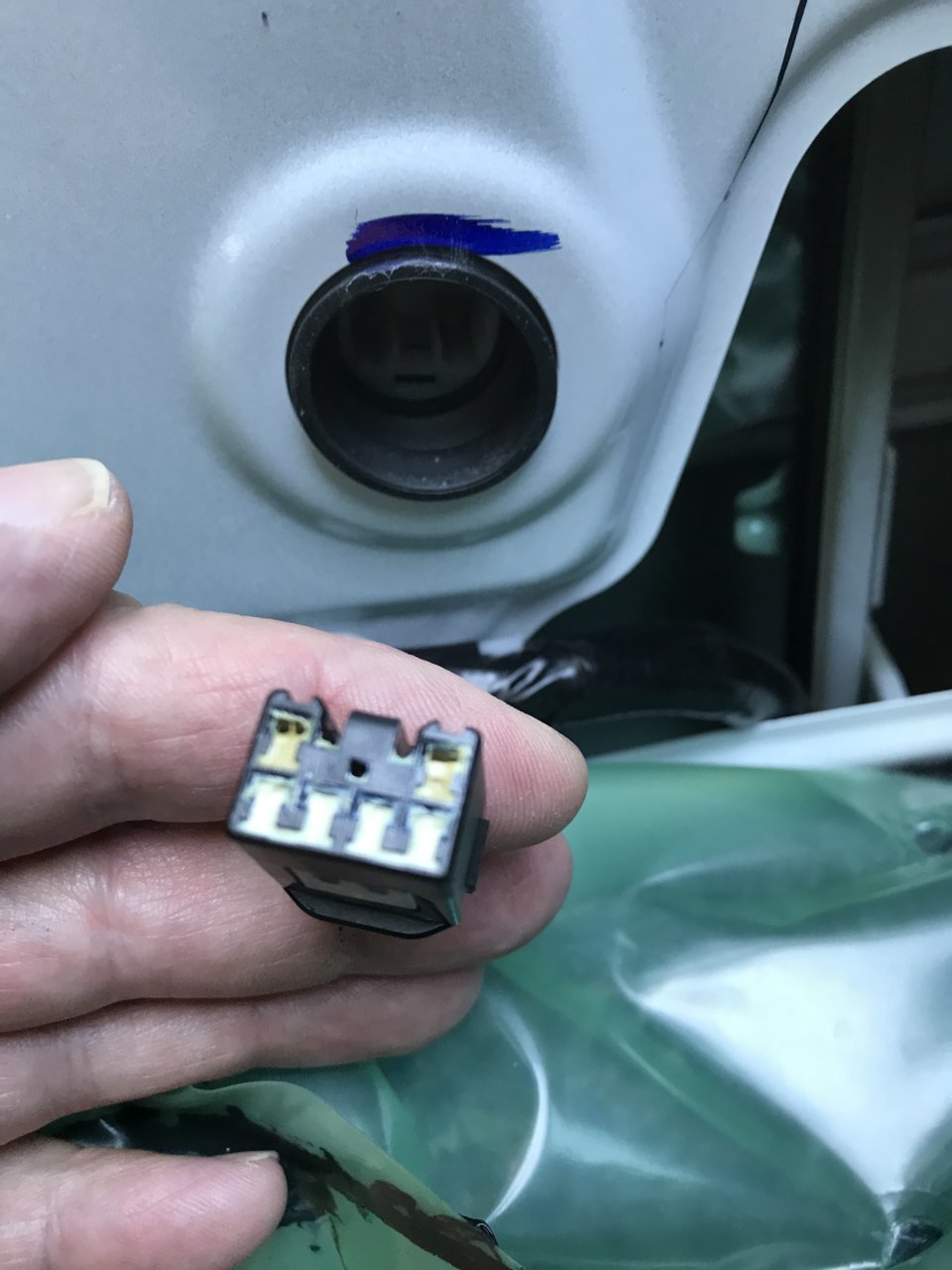

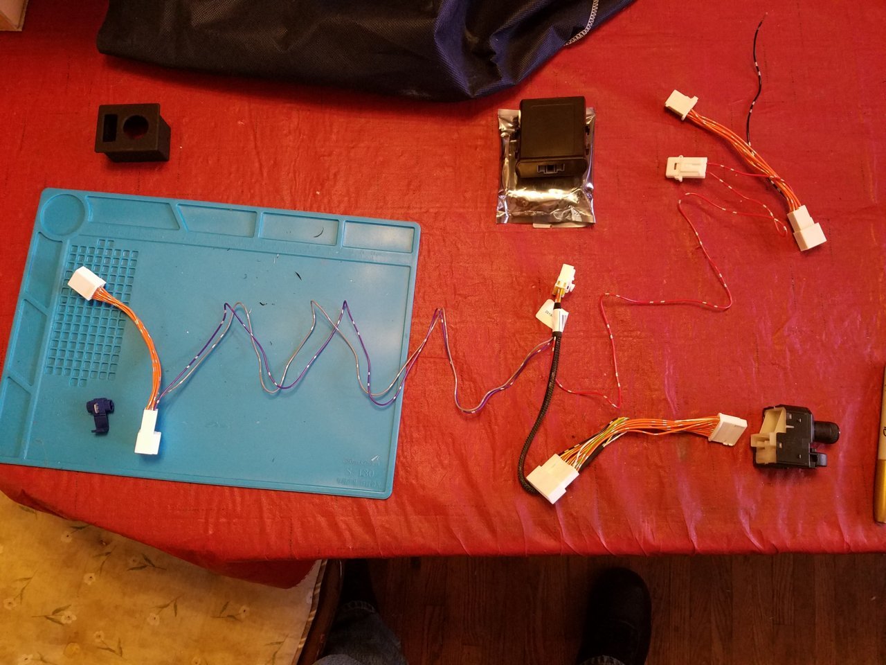

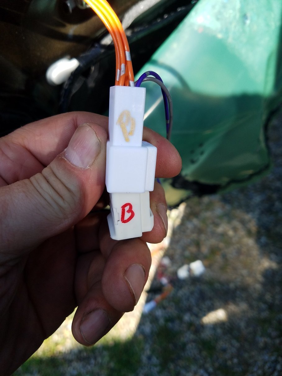

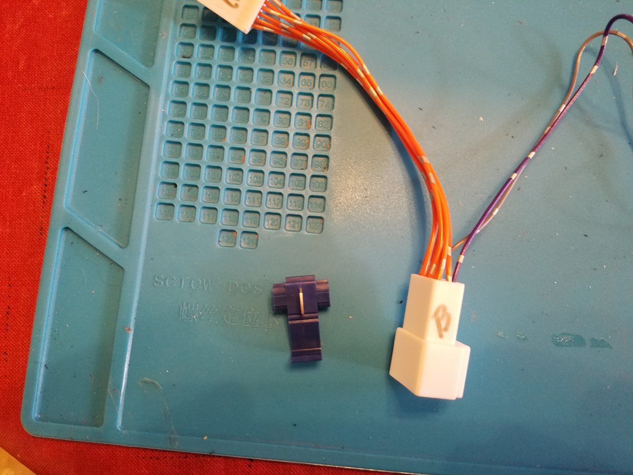

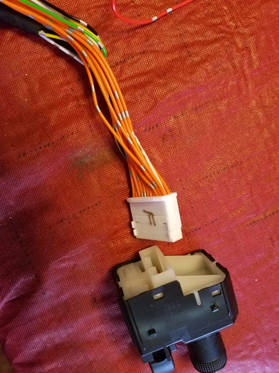

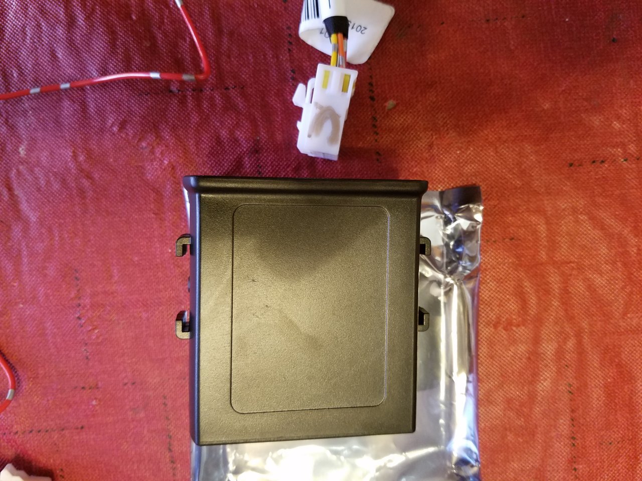

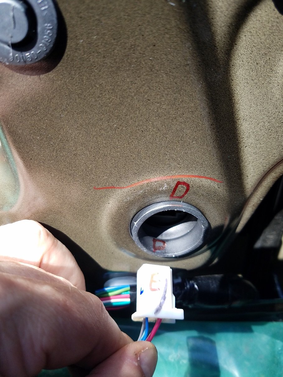

    I did not find any unaccounted for connectors in the door. But this may help you out.
    I laid out the PNP harness on my table and started labeling every connector left to right A, B, etc. Then I went to the door panel and labeled the vehicle connectors in the same manner but with a different color. A/B being the door lock, C is the control module. See pictures. From your picture, it looks like what I labeled D and E. It mates to a plug in the front of the door above the speaker.
    20190712_192054.jpg 20190712_192139.jpg 20190712_192151.jpg 20190712_192202.jpg 20190712_221239.jpg 20190713_102217.jpg 20190713_102730.jpg 20190713_110959.jpg
    20190713_104920.jpg 20190713_105402.jpg 20190713_111200.jpg 20190713_111218.jpg
    Waterboy504 and SK808 like this.

    Thanks brother, i appreciate the photos, great job. I’ll take a closer look. C70D463F-768F-4808-880D-E3C96262C40E.jpg
