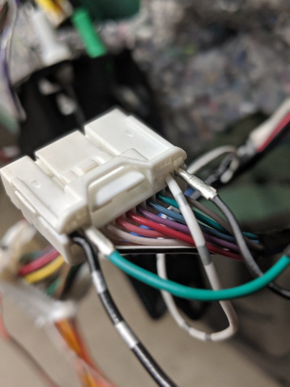

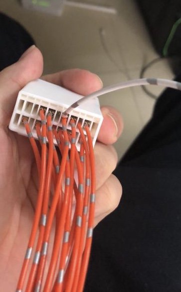

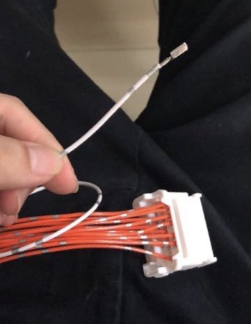

    SNEAK PEAK:
    Plug-N-Play Power Window Regulator Master Window Switch Harness
    As for the last wire, my Plug-N-Play Power Window Regulator Master Window Switch Harness will Connect directly to the Factory OEM Connector inside the Door in order to communicate with the Factory ACC. The ACC Wire connects directly to the the Factory OEM O1 Connector. This would be Pin #13 in the OEM Power Window Regulator Master Window SW Connector and it will then have an OEM Terminal crimped on the other end that will need to be inserted into your OEM O1 Connector pictured below.

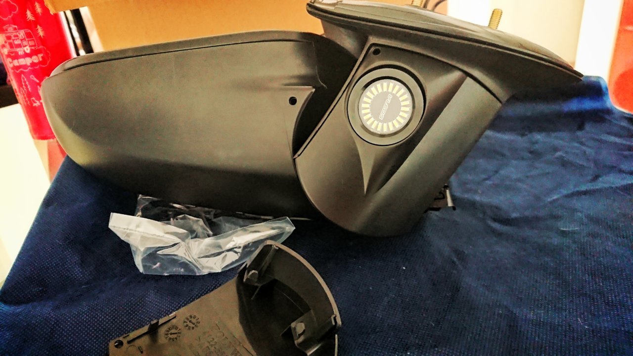

    Going to finish installing everything on Sunday.
    Just wanted see how the puddle lights sit.
    Not much of a gap, but it is there, about the same as with my OEM.

    Looks good. All the clips engaged?

    The outer four clips all engage.
    No center clip anymore.
    The center clip broke when it snapped into my OEM mirrors.

    You had a gap even on your OEM? I put a set on an OEM set and I don’t remember seeing a gap at all. I’ll take a picture of my camera pods I’ll be offering. You guys will just have to buy my camera pods and install my system and then mount your puddle lights somewhere else ;) :rofl:jk side note: I think they still look badass!!!

    My OEM mirrors do not have power folding.
    My OEM mirrors are not capable with the DIY power folding kit.
    These power folding mirrors were built using aftermarket mirrors as a base by @KTJO 4x4 .
    Since they are the only ones that match our mirrors while being compatible with the power folding motor.
    Thus, if I want power folding mirrors with puddle lights, this is my only option.
    Some people have a nonexistant to large gap, cause of a variety of manufacturing variables.
    One thing that I have notice, on the driver side, the puddle light is pressing against the wireloom and the plastic frame or the hinge assembly.
    When I adjusted the wireloom, and press hard I can get everything to set.
    But the gap is most likely a result of the puddle light getting pushed on, in my case.
