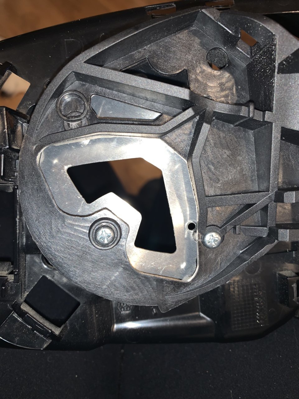

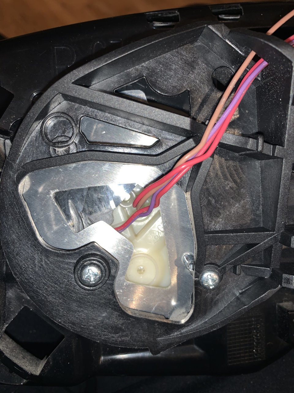

    I received the Adjustment Plates tonight!!! :bananadance: Great News!!! They are perfect!!! I put one of the mirrors together just to make sure and test them out for everyone before I send them out as replacements. Here are some pics. In the first pic you will see that I shaved off the ends of the screw. I originally used all 4 Screws on the inside to connect the Adjustment Plate to the Connection Plate. However, when I Installed the Actuator onto the Adjustment Plate, noticed they bottom left was sitting a little on top of the screw so it wouldn’t sit completely flat. I couldn’t just leave it. Some of you probably could have, but my OCD kicked in. So I just removed it, swampier the bottom two screws from the insider and went from the Outside in, and then shaved off the ends. I actually think this looks the best.
    i believe these are now ready to ship out. So, if you are someone that would like a set of the adjustment plates that was on the first order, please let me know as it has been a little bit. I obviously have the list people and I will be checking each of former conversations to see if we have confirmed this already or not. Thanks again for being patient.
