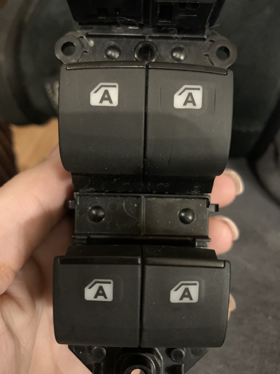

    I have the acc wire I found one I could use. That’s fine. What I am saying is the adapter harness connectors were way bigger than my factory connectors so they didn’t work. No where inside my driver door was there a connector of that size.
    My truck is a 2016 access cab with tech package.
    Give me a second I’ll get a pic.
    KTJO 4x4[QUOTED][OP] likes this.
  19. Jan 2, 2020 at 9:30 PM

    If you wouldn’t mind sending me pics through PM I’d like to see what yours looks like because on my diagrams it all shows that it should be plug-n-play. So if it’s not, I could always have something made for the 16 models

    If I saw your connector right, I think your connector is the same as a Toyota Hilux and it is the exact same as the Master Switch Panel I have from the Toyota Hilux, but I’m jealous because I wish I could have yours. Lol because you could use this
    And I can’t for my Auto Window Mods
