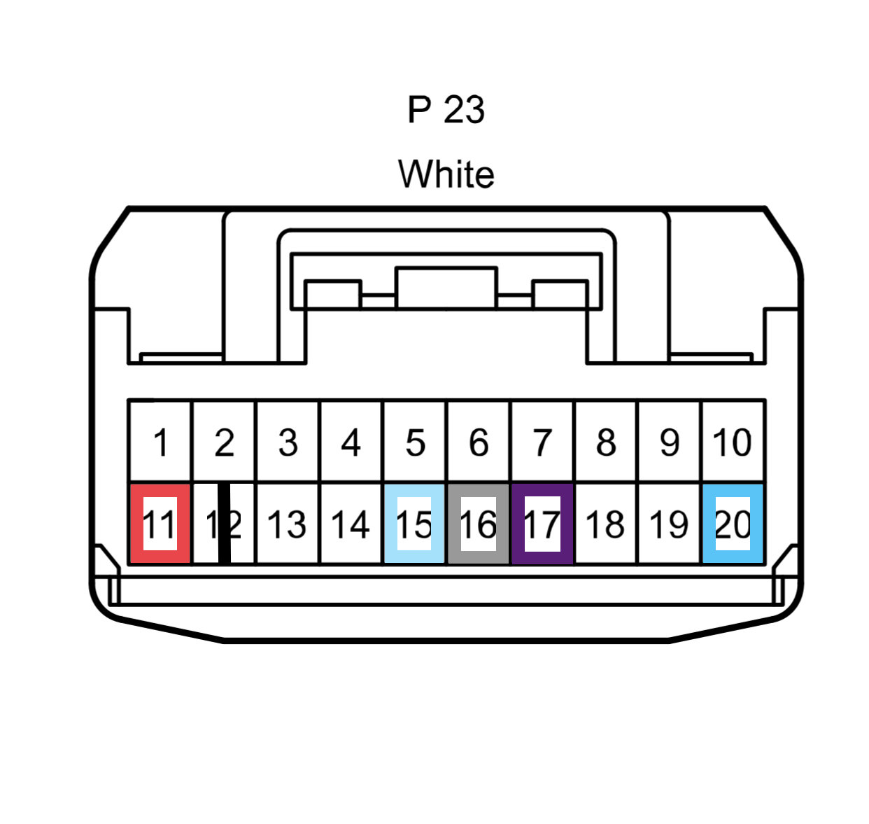

    @erok81 Ive got an idea, you can tell me what your connector is and I can convert mine to what yours is :bananadance:

    Ha. Want me to grab some part numbers?
    On a side note I’m pretty sure mine is working fine now. No issues with the kit except my connector difference. I’m pretty sure that I forgot to connect a plug inside the mirror.

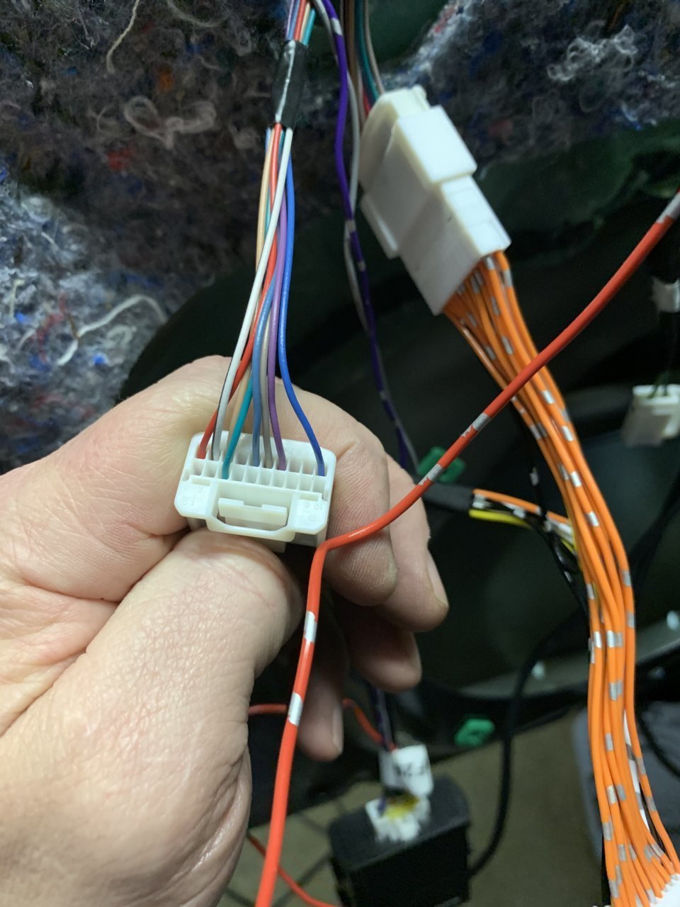

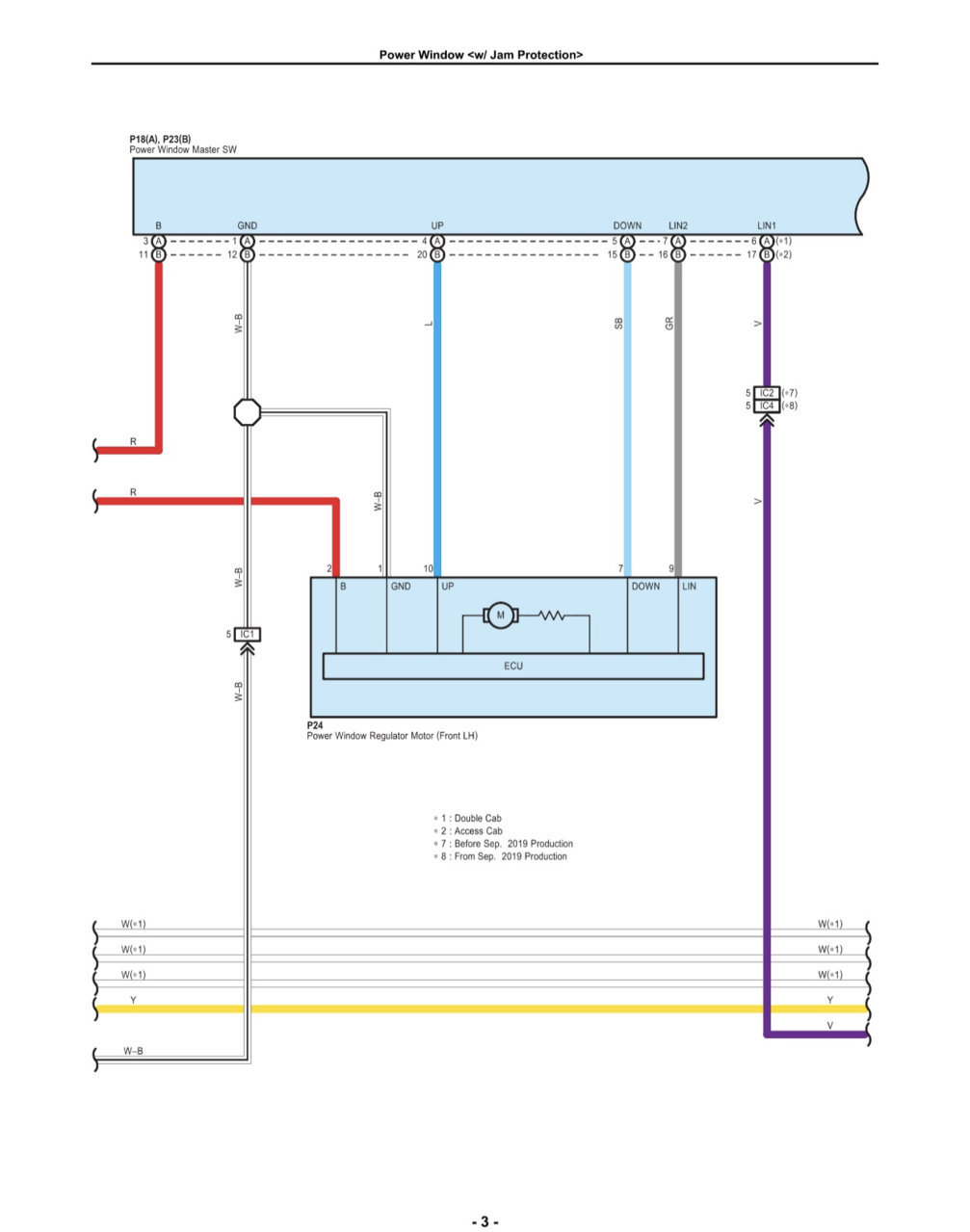

    Yes please. Thank You!
    Here is your wire diagram btw. This is the only one I have on my phone. I don’t have your Pin #3 and #13 on my phone. I’d have to get it off my computer, but I’m pretty sure it’s your Lock and Unlock Wires. I’ll figure it out maybe tomorrow if I have time just so you know. I need the connector part no please. If you actually can get me a pic of the front of your connector, that is what my vendor needs. The picture you posted with the wires is from the backside, so I need the other side angle if you wouldn’t mind.
    11 = BATTERY
    12 = GROUND
    15 = DOWN
    16= LIN2
    17 = LIN1
    20 = UP
    Just because you don’t have a wire in those locations doesn’t mean you can’t add a wire to those spots. You should test those other locations and see if any of them read as ACC locations. I’m glad your mirrors are working now, just a thought. I’d love it if you could definitely send me some pics. I wouldn’t mind at all seeing what I could do with this other master switch panel from the Hilux. It would be nice to have to one touch for each on of the buttons. Not a necessity but something fun I could mess around with for sure. Especially now that I figured out which connector it is that goes in it.

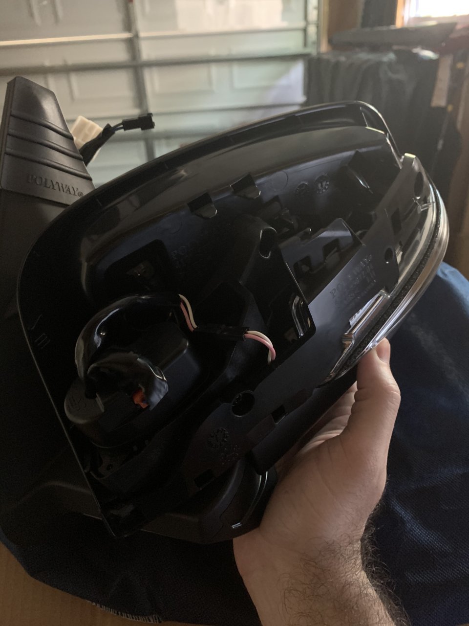

    Arrived today, woo! Can’t wait to get them put on. I do have two questions tho, since I have the SR5 I wasn’t sure if the blinkers on these would actually wire up and work - did I get the right set?
    The other issue is my current mirror was smashed, so I don’t have the housing to swap onto the new ones. Are the plug and play ones supposed to have the backing as well?

    Unless you tap into your turn signals from somewhere else in the truck, I don't think those blinkers will work.
    Since you have an SR5, I think you have a different connector in your harness in the door panel.
    I just checked my unpacking pictures, (post 462), and mine did not arrive with the upper housing either.

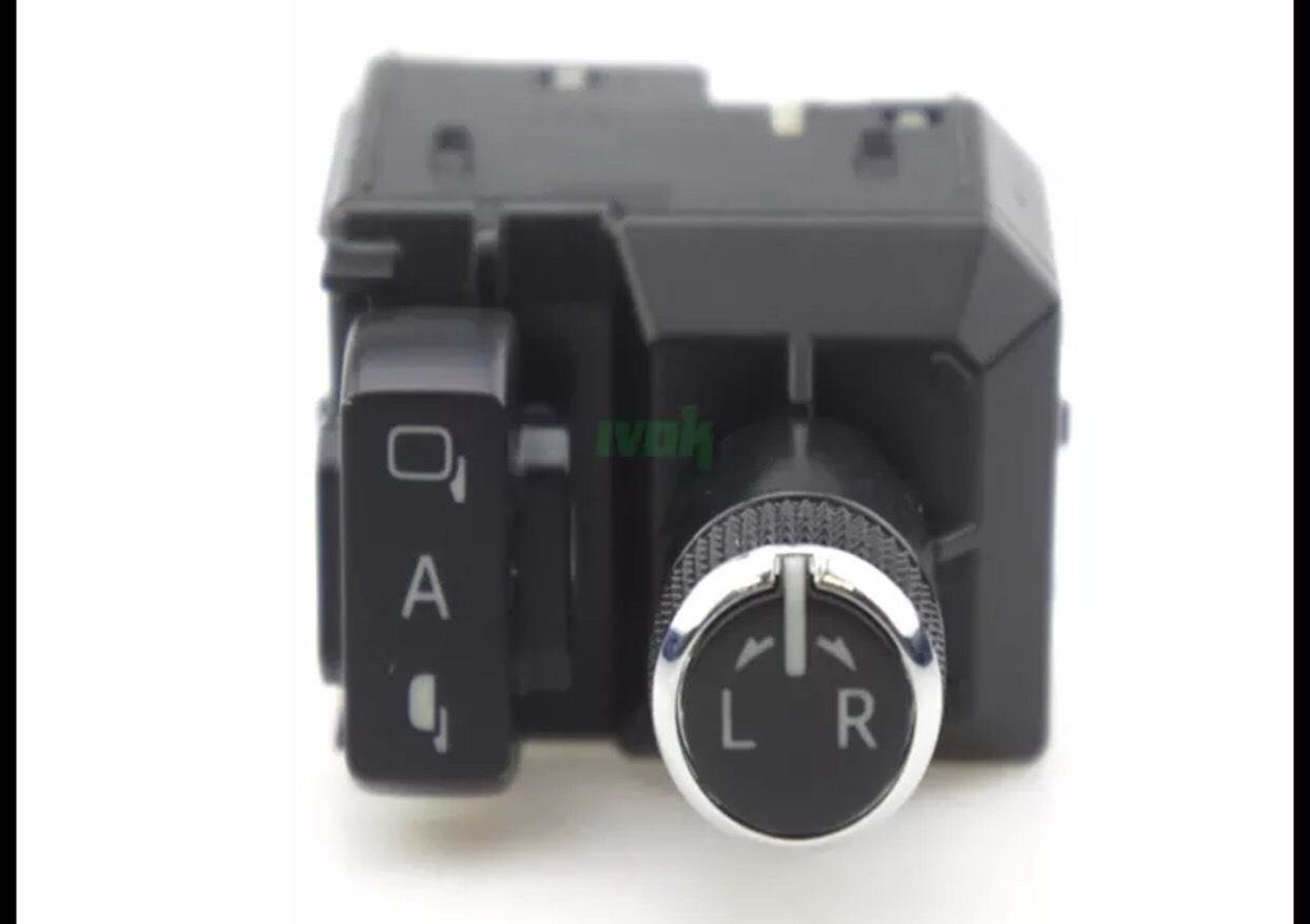

    Katie, Have you had any luck testing this switch? I recently ordered the DIY Kit and live in Canada, so we do have issues with ice and snow freezing mirrors. It would be great to be able to disable the auto fold of the mirrors during ice and snow freezing conditions.

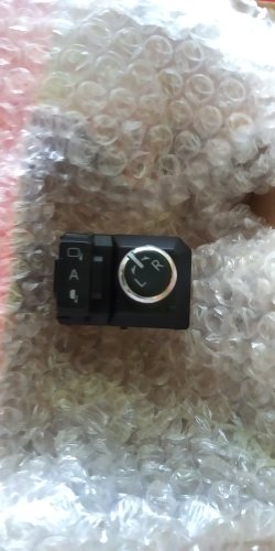

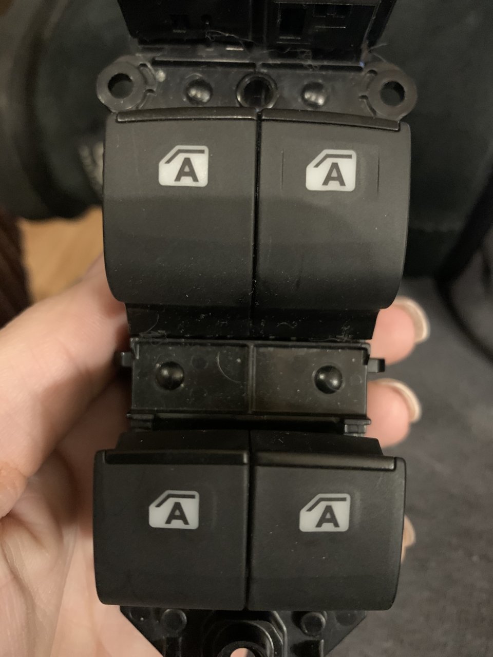

    Actually I’m kind of bummed. The guy that said he had the LHD shipped it out to me and it ended up being the same one I currently use. However, my plan is to convert the RHD one to our truck. Now that this kit is complete, I can go back to that switch. If you remember right, I originally started with that one and I only had to figure out the unfold part of the switch left. Everything else was done. So I’m almost there. Once I get it, my plan with my vendor is to have them make a mold of our door switch panel and it will be offered with the kit since the switch obviously mounts the other direction. You will not be able to use your current setup at all. However, it will be way worth it in my opinion to have the Auto Switch. I will have both Kits available just in case customers want the non-auto package, but I just think that it will be something that I will be offer in this form. Please let me know your thoughts. Yay or nay? Likes or Dislikes?

    I'd deffinalty be into having this other setup with switch and bezel. I was in -18°C this weekend and made sure of free movement to prevent damage. Looking forward to try this out!

    Well thanks to @ib134866 we may be back in business again with the hopes of the LHD Auto Switch. He found a different supplier that has the Switch.
    I have already made a purchase and it is processing. If in fact I can configure the auto feature, my vendor said that he should be able to source this switch for me. Fingers are crossed for us one more time that this one will show up and be the correct one!

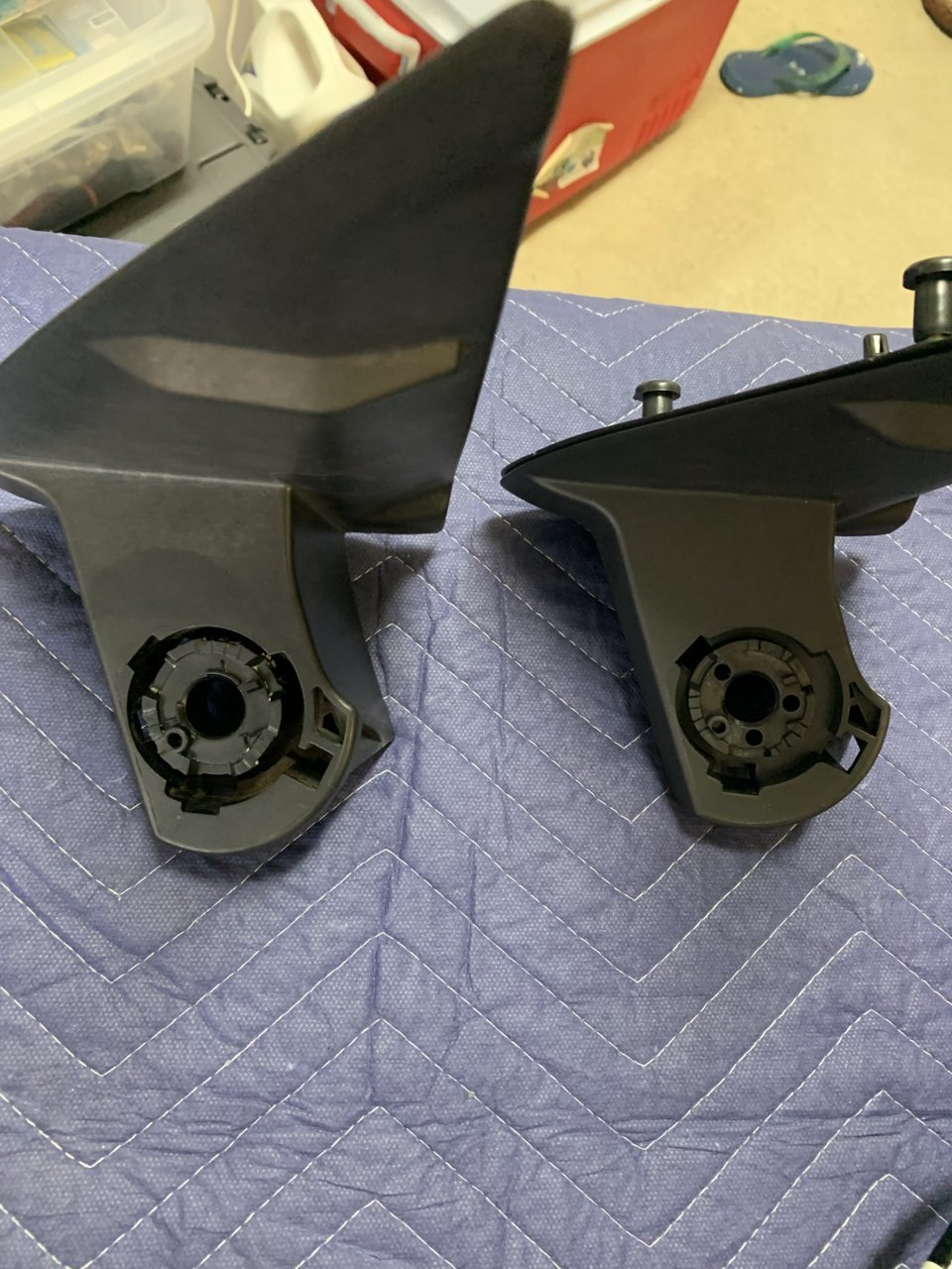

    I know we ended up talking after this post, but I was just going through the thread to try to snag some things for the website real quick and I saw this post. Your statement, "there’s enough of a difference to prevent engagement" made me actually laugh out loud. This picture specifically got me.
    I think you could have made it work, don't do you?? haha jk ;) Just some elbow grease. I can't remember, did you end up drilling the three holes in your OEM or did you end up selling the MESO Puddles. I was surprised to see that the MESO Puddles were off a little on the Aftermarket Mirrors because I know he was getting them made he had a couple of aftermarket sets there. I would have thought they would have been tested on all of the mirrors. However, if you can only go with one, I would have selected the OEM Mirrors as well. Just a bummer.

    I made my puddle housing plastics to fit OEM Toyota mirrors only. The factory cap was 3D scanned for dimensional accuracy. I have had some feedback from customers trying to install them in aftermarket mirrors and there is a noticeable gap. Since These are molded, there’s not an easy way to change them to fit aftermarket. I have no clue why aftermarket mirror companies wouldn’t just use the same exact factory specs...but there definitely is some variations from OEM.

    Yeah I could have made it work if I cut some of the plastic. The groove was too narrow on the stock mirrors. No didn’t bother drilling the hole since it wasn’t fitting anyway. I still have the MESO puddles, but didn’t install them yet. One side (can’t remember which) wouldn’t clip in all the way. I’m planning to install it with RTV like 20tacoma17 suggested. Just haven’t gotten around to it.
