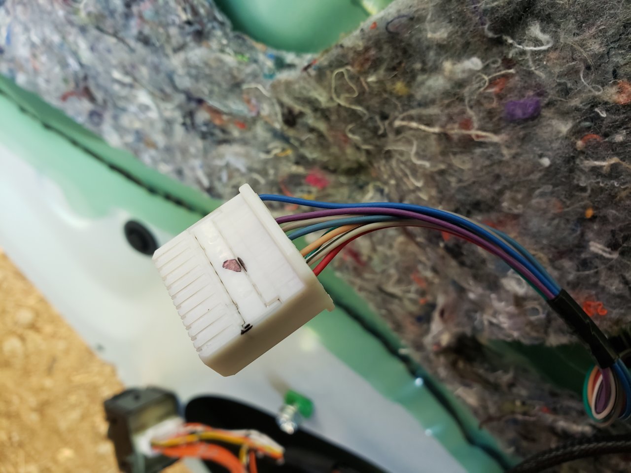

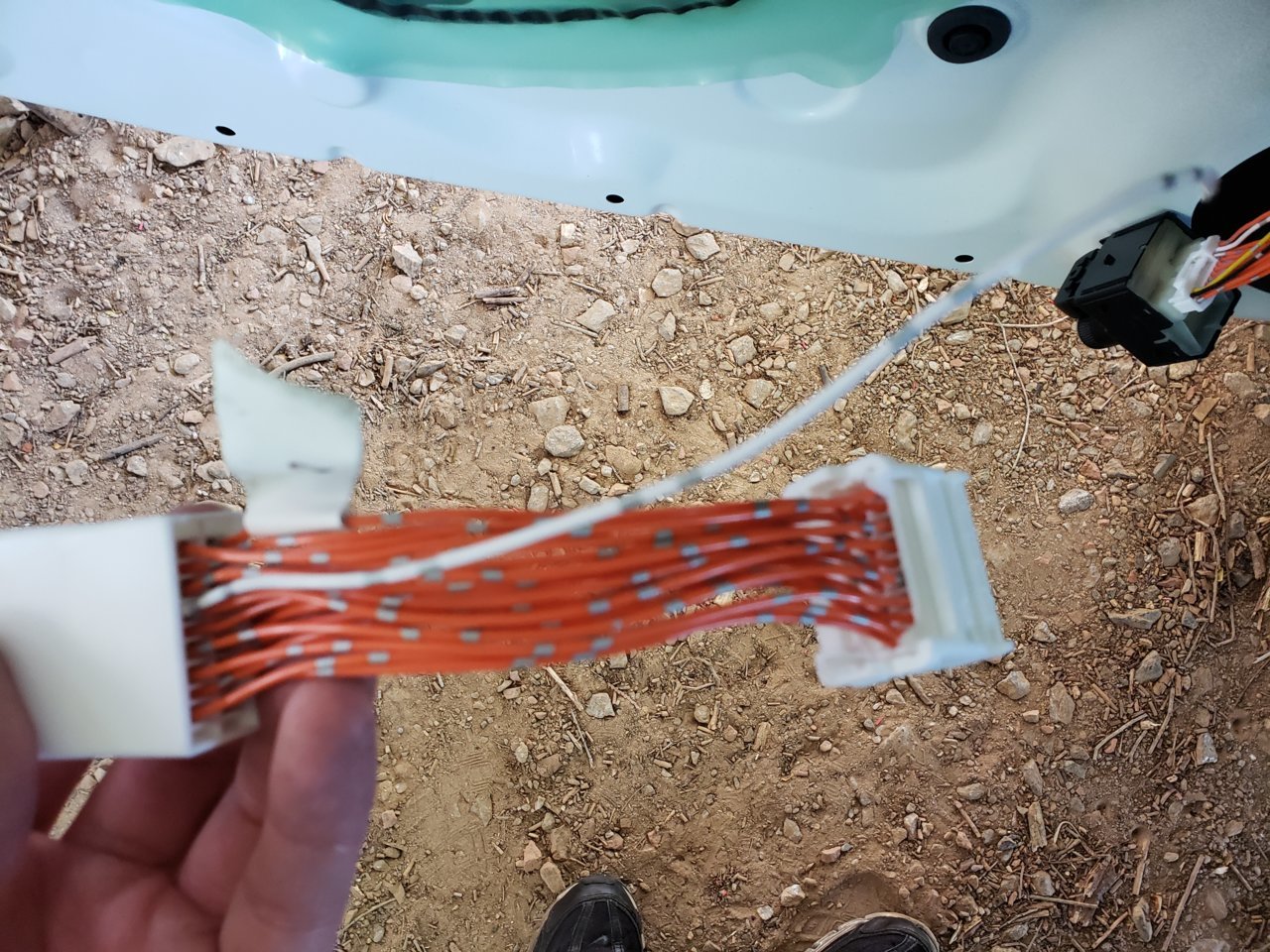

    20200511_163136.jpgcan someone tell me what this white wire does that is on the harness that goes into the window switches? I have an access cab and my harness is half this size.20200511_163124.jpgthis is my harness. I need to know what wire to tap into.

    If I recall, that white wire goes into an open slot in one of the OEM connectors or that would Be a different white wire.
    Might be different on an AccessCab though.

    Yes, that white wire goes into the OEM mirror control harness. But I need to know where to splice the other end, cut it off of Katie's harness, and splice it into my window switch harness.

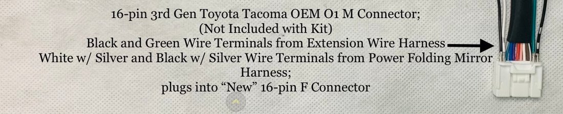

    Howdy,
    The white wire with the sliver band is connected to the +12V accessory of your vehicle. This wire will have +12v when the ignition is tuned on. The loose end gets connected to your existing power mirror cable as shown here:

    I believe it's his other end he is having issue with since he doesn't have the big harness block with the access cab. He can't use the plug and play harness adapters. Need to figure which one is the accessory wire on the window block he has I guess.

    Yep, the other end picks up the 12v accessory power from the power window harness.

    Thanks for the info guys! I will try splicing +12v accessory power to that wire.

    That's what I needed! I got it working. I had to Frankenstein it by splicing two wires in different places as there isn't an accessory wire in that harness. Viva access cab!
    Thanks again!
