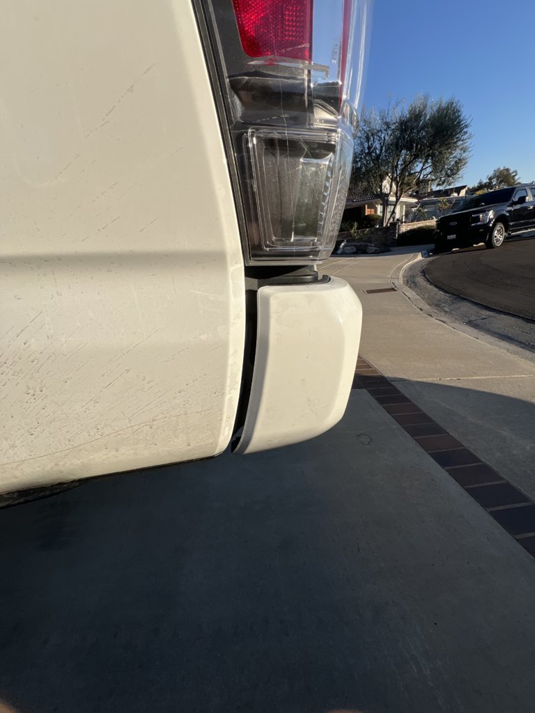

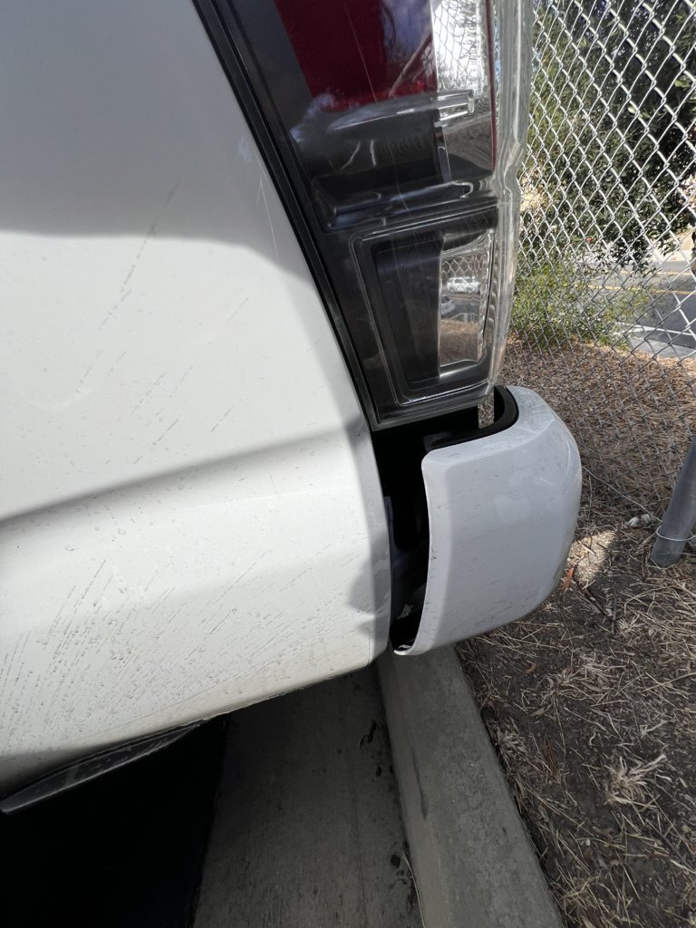

    IMG_5116.jpg The rear bumper alignment on all Tacomas are pretty bad, however I backed into a pole and my paint was fine but I was left with a super huge gap in the bumper. What i found helpful to re align is to take off the plastic where the license plate is and there will be screws on top. If you loosen all of them you should be able to get some play with the bumper and re align it. I have the before and after pictures linked into the post. Hope this helps
