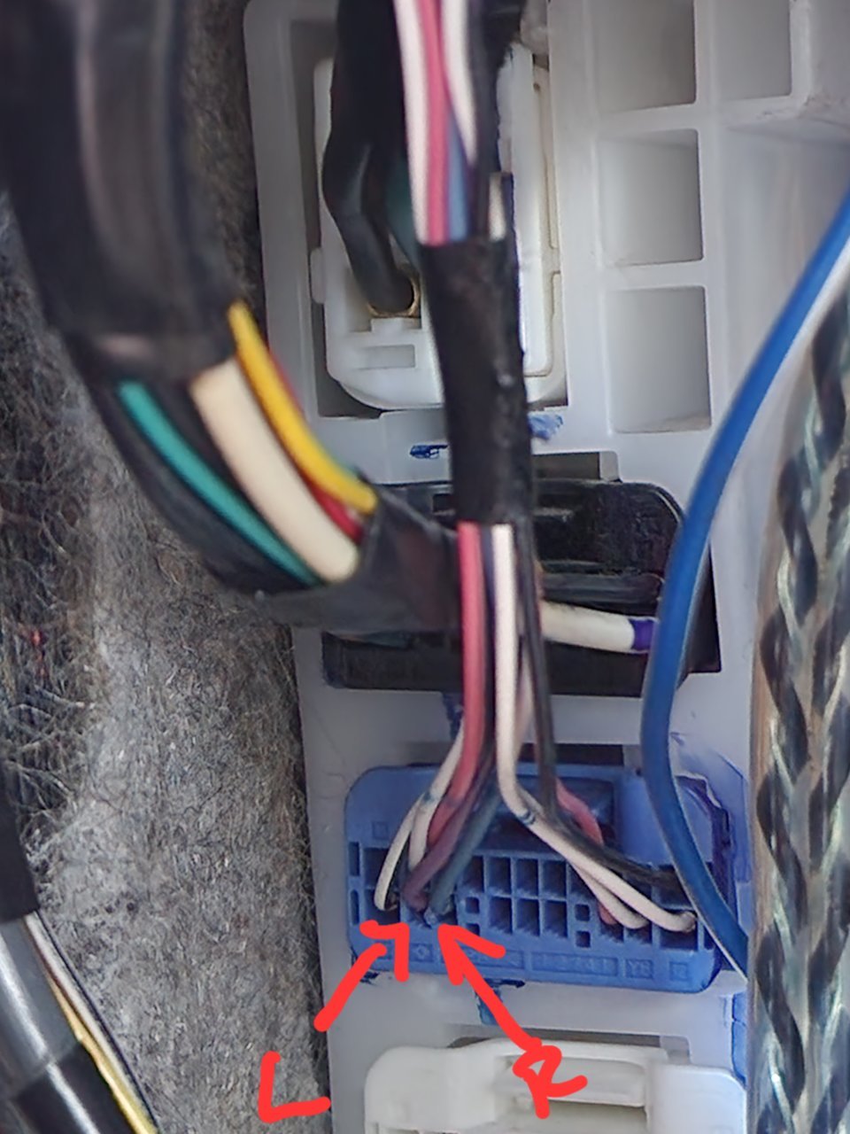

    Finally found the wires for the turning signals , left side under the fuse box, purple is left green(blueish) is right, now to find dome and reverse
  10. Jan 10, 2023 at 11:22 AM
    caribe makaira
    caribe makaira Well-Known Member
    Feb 13, 2011
    #51121
    11,741
    Caribbean, Puerto Rico
    05 PreRunner TRD Offroad AutoTrans
    Hood Struts, My version Fogs always ON, Map & Overhead Light Mod,
    Those are the towing (combined stop & turn) turn signal wires.

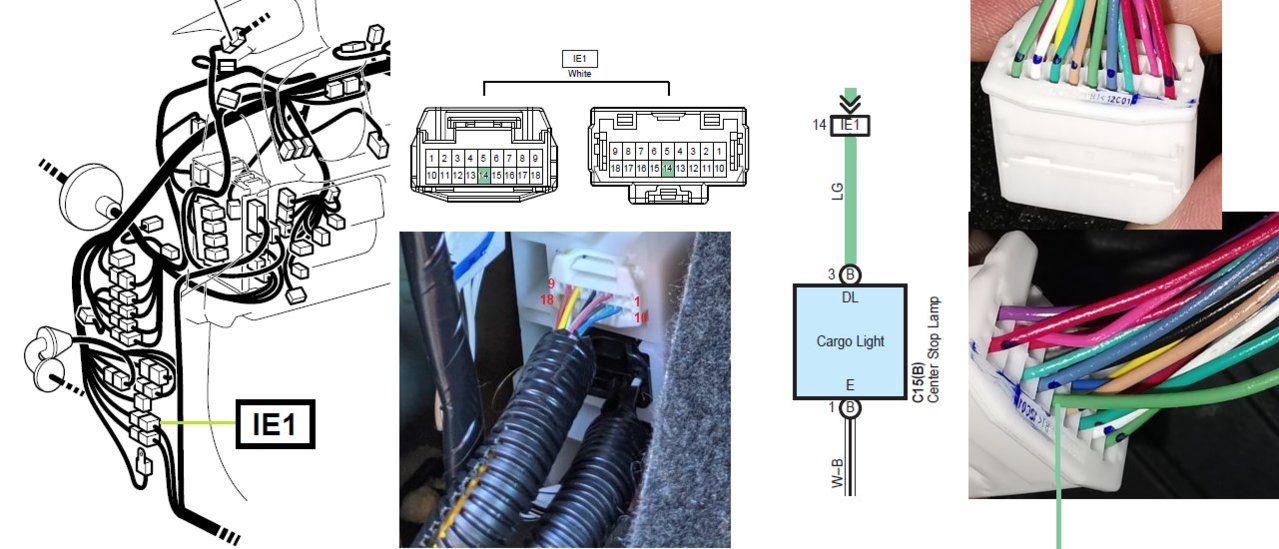

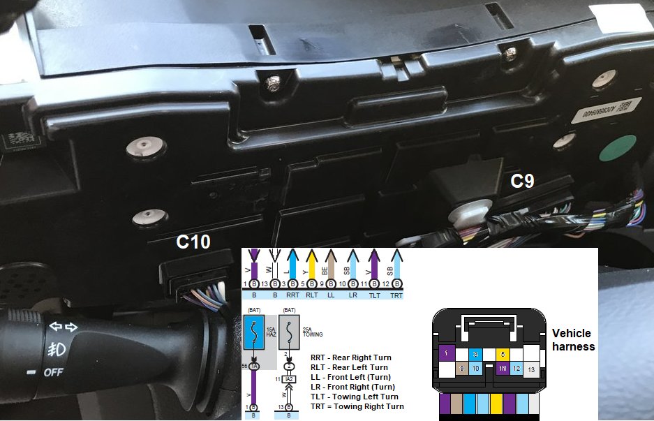

    @ecuarodz , for your door signals:
    Plug-and-Play Signal Mirror Harness for Base Models
    or this
    C10 located behind combination meter (gas, speed, etc.)
    For the Puddles, piggie back to the cargo lamp feed. (leaving cargo lamp on DOOR position)
    Use posi-tap, dual wire on one side (for L&R puddles) and tap side to lime green wire on IE1_3 connector.
    Posi-tap the running light for each side (door connectors)
