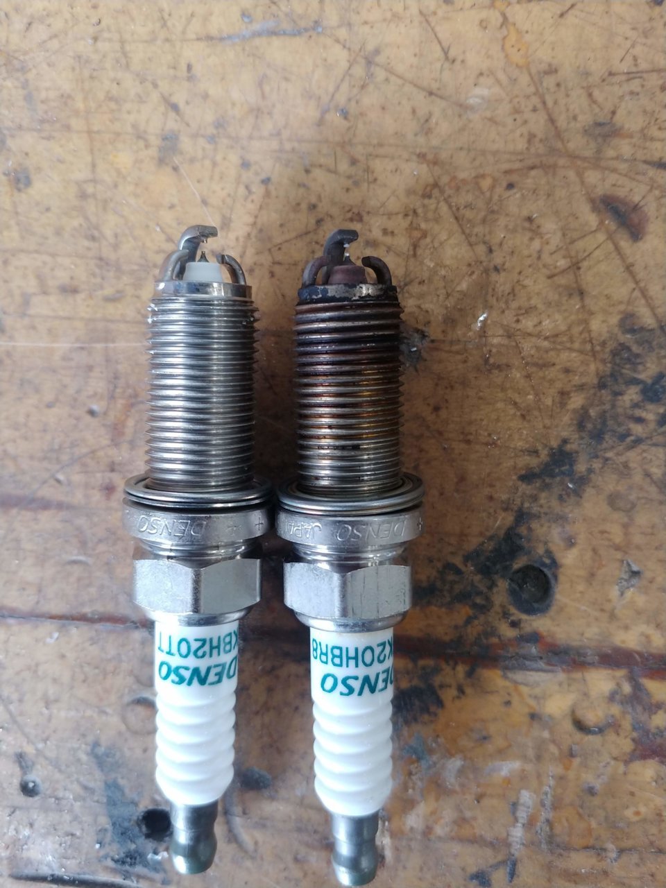

    From Denso FAQ:
    Should I apply grease to the spark plug thread?
    If a thread lubricant such as grease is coated on the thread, tightening of the spark plug increases when applying the same torque; this can cause damage to the spark plug. Subsequently, vibrations may cause the plug to come loose. Because of this, DENSO recommends not using a thread lubricant.
    Spark plug manufacturers already plate the threads with an anti-seize coating
    Torque spec is 13 ft/lbs dry.
    If you use additional anti-seize you should reduce torque by 10-15% or 11-12 ft/lbs
    I've never used anti-seize, but, I have always used a torque wrench.
    IMO, most folks who booger a head with spark plugs don't use a torque wrench and end up overtightening. In subsequent spark plug changes they use anti-seize in an attempt to avoid future difficulties in removal. When in fact, they have compounded the problem.

    From what I gather, per DENSO;
    IKBH20TT
    The "I" prefix denotes a 'standard' iridium plug. 60,000-80,000 mile possible expected service life, 30,000 mile recommended service interval.
    The "TT" suffix denotes twin tip.
    FK20HBR8
    The "F" prefix denotes a 'long-life' iridium plug; 120,000 mile possible expected service life, 60,000 mile recommended service interval.

    The stock gap plugs are 0.032”
    Those other “replacements” are 0.04”
