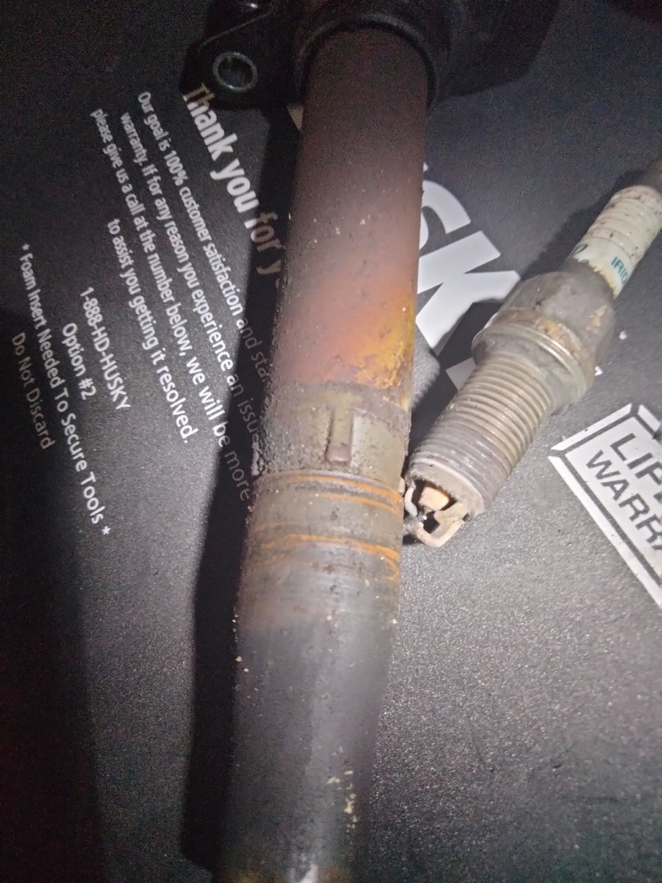

    This is the first plug and coil I pulled last night and.... As u can see they needed change lol. They They came out easy.

    i noticed your coil is pretty dirty, is that any indication of something, or just natural? Going to change mine next. - thanks!

    When the coils are browned and stained, this usually means that plug was not torqued to spec or had loosened over time indicating blow by gasses or extra hea. I pulled mine all and replaced at 60K and the coils all looked brand new and I reverse torqued the plugs and they were a hair over torqued, but torque accuracy is usually a bit less when using reverse. With that being said, I have not heard of any damage or issues as a result of a loosened plug. Just make sure the new ones are properly torqued and you should be golden. I did the whole job with recommendations from the forum and had NO issues and did the whole job in about a hour.

    Thanks for the insight- Sure enough, I had one coil that has a bit of brown when i pulled it out (the rest were looking great).... and sure enough, the spark plug from that one cylinder was looser than the others. I cleaned it up best i could (probably will replace that coil) and was sure to torque down the new plug as required... all other plugs were tight. This is the first change so i wonder how it got loose... had I not read your note, i would have been having a bit of a worry attack! lol
