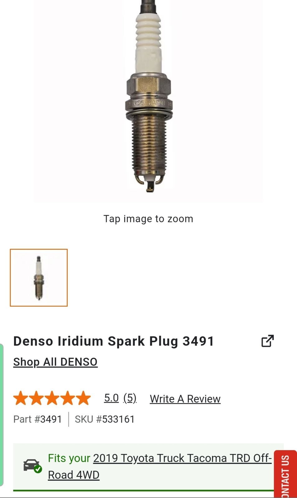

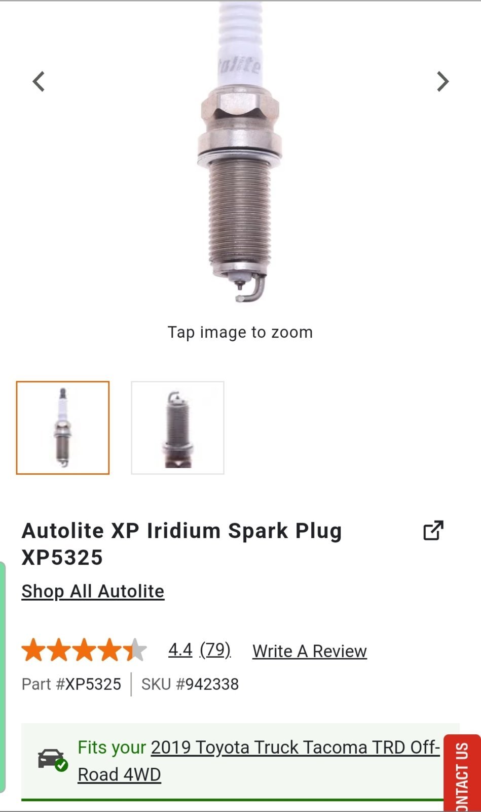

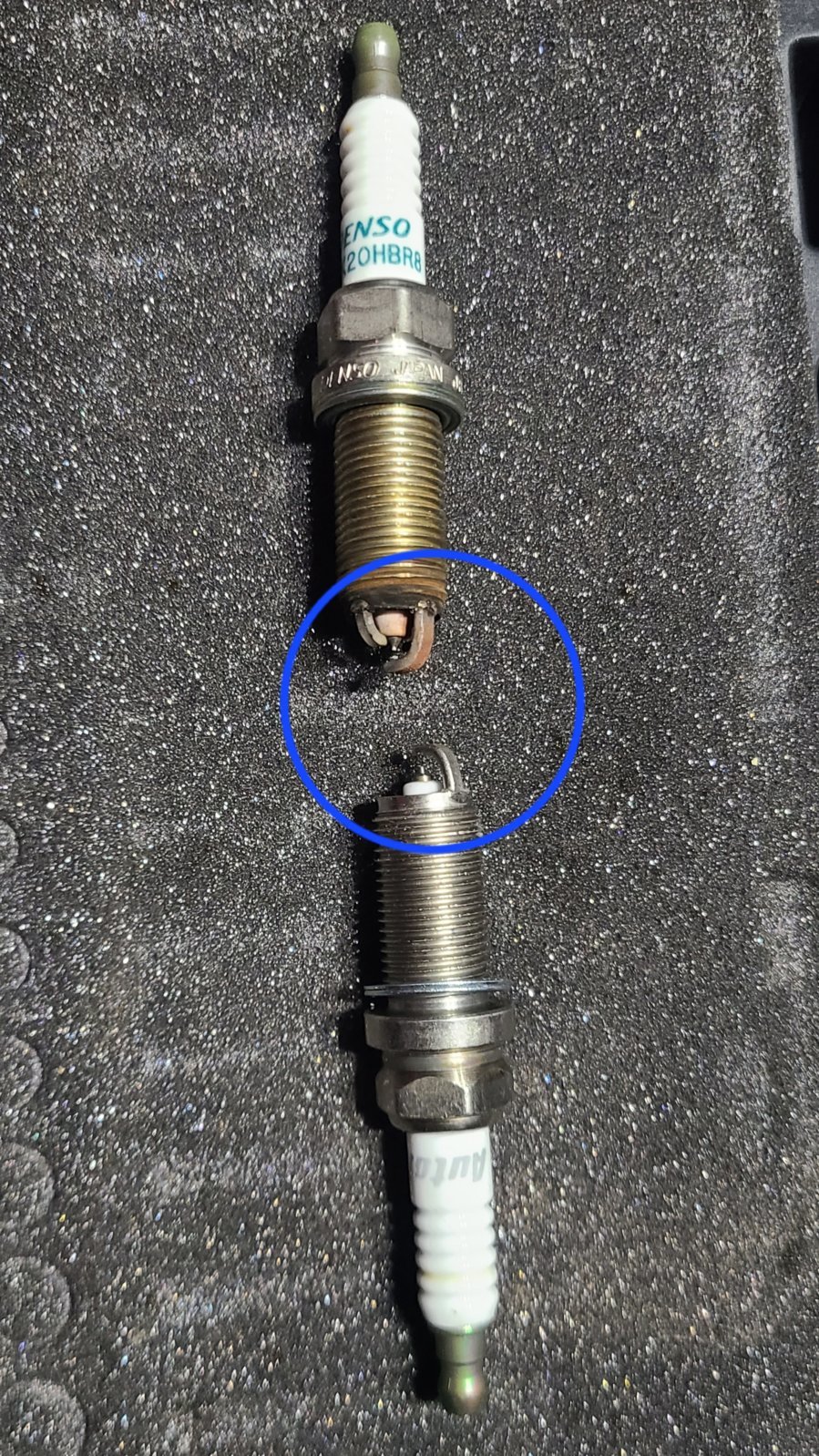

    Hello everyone,
    I'm replasing my spark plugs but I wondering if I can use a diferent spark plugs like AUTOLITE XP5325 or I need to us the DONSO 3491Screenshot_20240119_202906_Chrome.jpg Screenshot_20240119_202819_Chrome.jpg 20240119_194947.jpg
