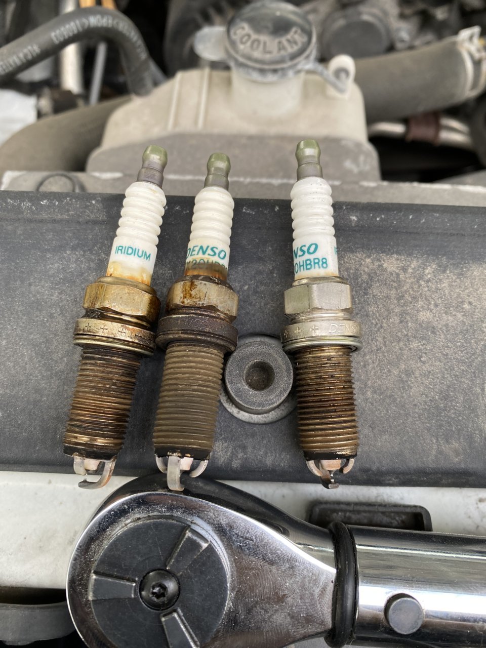

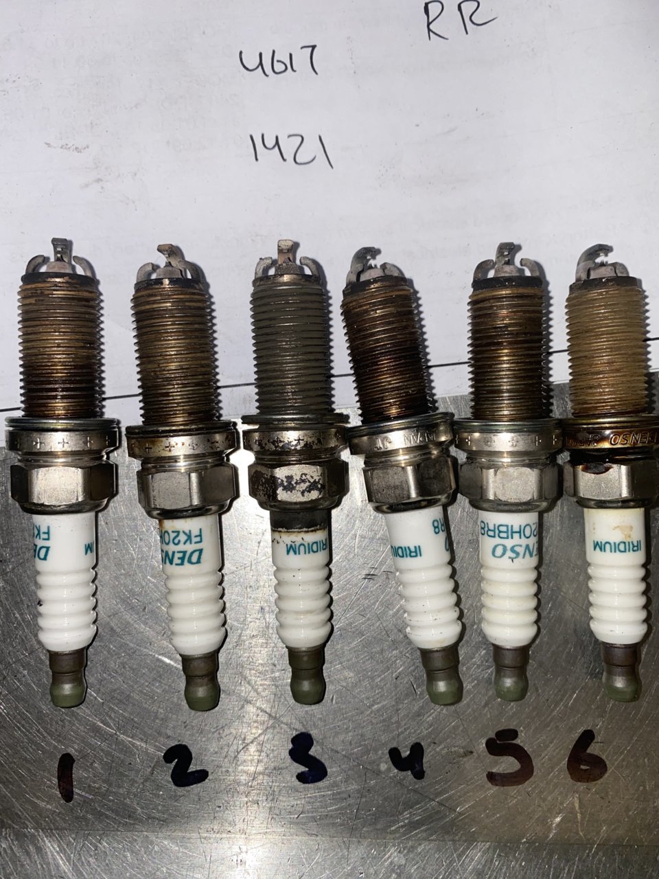

    413AF247-8A2E-4074-B9B6-F10D58D8ADCF.jpg 91463E37-780F-4E25-ADA3-8FD7A538201B.jpg
    I changed mine at 60k, mostly because the Service Schedule says they need to be changed at 60k to maintain the emissions warranty.
    However, two of mine on the passenger side were, at best, just over finger tight. As far as I know no one was ever in there. Ive owned the truck since new and the only thing Toyota did was replace the fuel rail under warranty.
    Heres the three from the passenger side, one looked clean, and two others were brown and the coil packs were brown also.
    Never been in deep water, never washed the engine bay, and never touched the plugs until today. No oil leaks either.
    Greg.Brakes.Tacos likes this.

    Eeks. That’s SFUS. Did you replace the coil packs? How’s it run now?

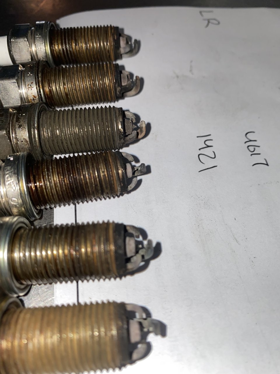

    100k update. Truck is at 158k right now. Plugs were last done at 60K. Something seems to be going on with cylinder number 3. Coil had soot like stuff on it, plug was worn and black. It’s possible I might have left it loose and it’s just carbon. Let’s get another 100k out of it.
    This time I also took way less stuff of from the drivers side, but did have to pry stuff out of the way.
    1F094E88-B9B1-4629-9FAF-6B623FE3C13B.jpg BE3A45FA-70E2-4B82-A0E5-1FF1CE073B6F.jpg

    QUOTE="ibexlatham, post: 26053960, member: 206438"] [/QUOTE]
    My #3 coil looked exactly like that. Plug felt loose, even though I torqued it to spec. This time I tightened a bit more, will recheck in about 20k miles and see.

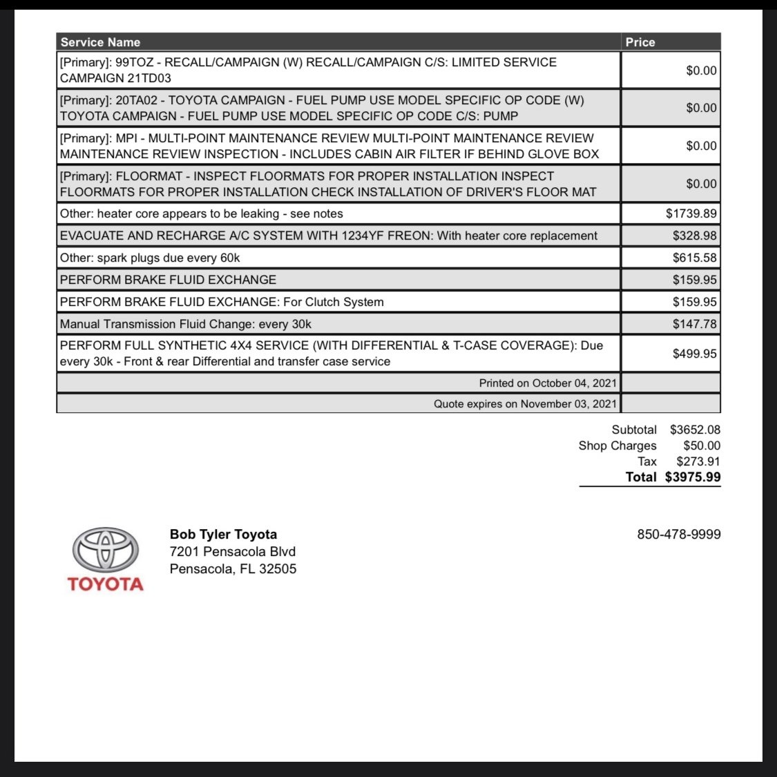

    oh my god those prices…. This is what I was quoted for when I went in for my fuel pump and third brake light recall.
    The “heater core appears to be leaking” is some complete bs. The tech told me “well I saw some residue and had to add coolant to the system so that’s why I quoted to replace the core.” I denied everything on the list. Changing the fluids and spark plugs myself.

    This new data is interesting. Hearing them loosen after folks have serviced them might lead back to that weird detonation loosening theory?
    I'd die on my own sword before I get close to paying half of that for a service.
    The heater core is worrying, but that can be tackled or done for much less at an independent shop.
