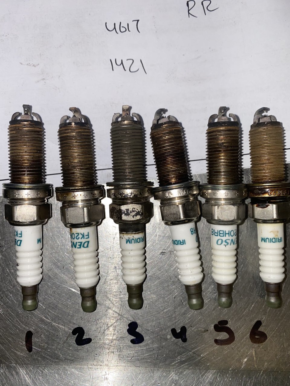

    so i just followed this write up and did the plugs at 66k on my 2017 sport manual.
    one thing to note is the intake support bar closer to the firewall holds the clutch line, so i just removed the two bolts mounting the bar to the engine, and let it hang in place.
    2 plugs on the passenger side and 1 on the driver side were finger tight, literally no ratchet on the extrnsion required. these 3 plugs had a gas smelling oily residue on the threads by the sealing washer and around the washer itself, and were slightly black at the electrode. the other 3 were the opposite, looking reddish/whitish with no black anywhere.
    happily, once all were replaced, my test drive yielded a shockingly quiter engine. i swear there is a rattling sound that seemingly creeped up on me that is now gone. no codes, no mil light. same mileage as always.

    2016 Toyota Tacoma TRD Sport
    This time around I did the plugs at 100k and cylinder 3 was loose. I know that I torqued all of them to spec.

    On my second spark plug change some of mine were loose as well. I torqued them all to spec. I went right over spec this time. We will see what happens at 180k
