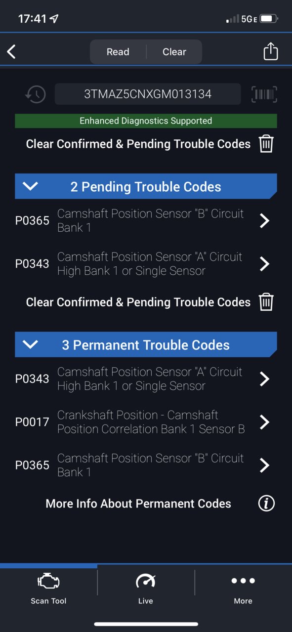

    Update:
    Was able to borrow a friends BlueDriver OBD scanner tonight. I attached a screenshot.
    So weird. I also called up another friend who is a Toyota tech and suggested going through all the connections again (coils and cam sensors). I did the above suggestion with no change.
    A separate friend who is a mechanic suggested swapping the cam sensors (pass to driver, Vice versa) to see if the code follows the sensor or not. Which could narrow the issue to wiring.
    So I did as suggested and moved the cam sensors onto opposite sides, cleaning the gunk/oil off of them before installing. I did notice the cam sensor which originally was installed on the passenger side was cracked near the bolt hole. It may have been from me inadvertently over-tightening the bolt.
    After that was complete, the truck started right up but had a different idle, cycling from 1,000 to 500 rpm’s.
    A new code (P0015) emerged from the scanner.
    We cleared the codes. Key off/engine off. Then started the engine again and……
    NO CODES.
    I am completely dumb founded and lost as to what caused my issues on Friday. I took a drive for about an hour and truck ran normal, no issues or codes.

    Tagging @MOC221_ because I think he had the CPS circle jerk going on with Ginger 1.0?
    From what I recall, the 2016 CPS was a bit sensitive and prone to failure. There was Service Campaign or Recall because of it. From my other experiences, I know that CPSs in general can be sensitive to messing around.
    If @MOC221_ doesn't have a better idea, I would either search and inquire about the Recall, look up the CPS diagnostics in the Service Manual (see the link below), or just throw the part at it?

    I had an early 2016, and yes Toyota had a recall WRT the crank sensor at one point due to issues with some trucks stalling and/or running rough. If you read through the documentation, it appears Toyota theorized that some timing rotors (bolted to the crank inside the bell housing) were made with anti-corrosion coating that was too thick. They came out with a new sensor to compensate for the issue.
    I never had a CEL/stalling problem nor got the recall notification myself, but bought the updated part (about $150?) and installed it for piece of mind. Upon further research of my VIN with the dealer, it appears that my truck was built literally a week or two before the crank timing rotor problem began.
    Anyway, that's my story WRT the CKP issue.
    It seems @JasonT87 's problems were all centered around the cam sensors, by looking at those codes and his description of what he did during plug maintenance.
    Edit: BTW, not a shot at anyone but I've had the plugs out on the 3rd gen V6 and I didn't have to touch the cam sensors (maybe unplug connectors in the way momentarily). Made up a coupla new swear word combos doing the driver's side bank, but the buggers came out without incident lol.

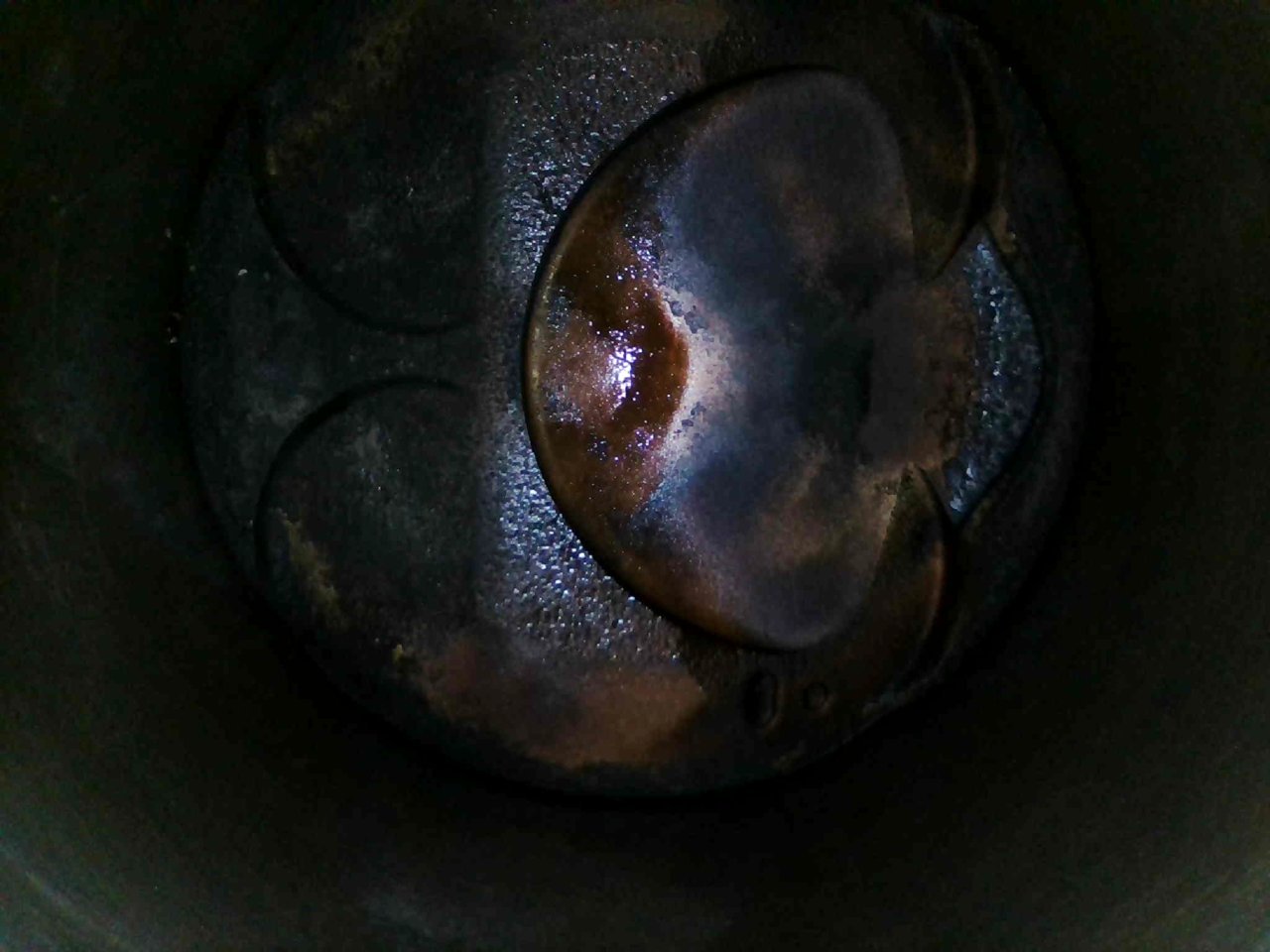

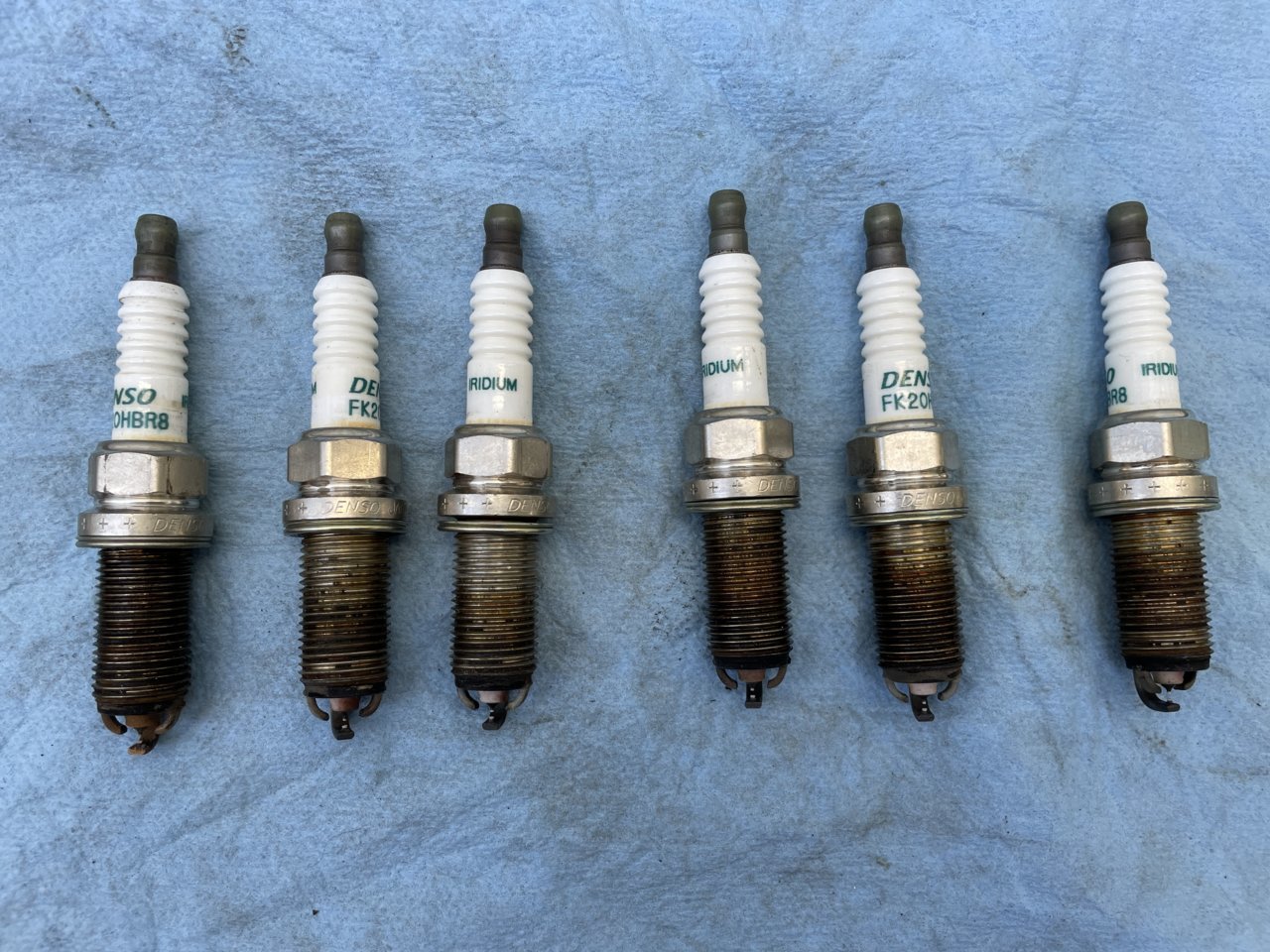

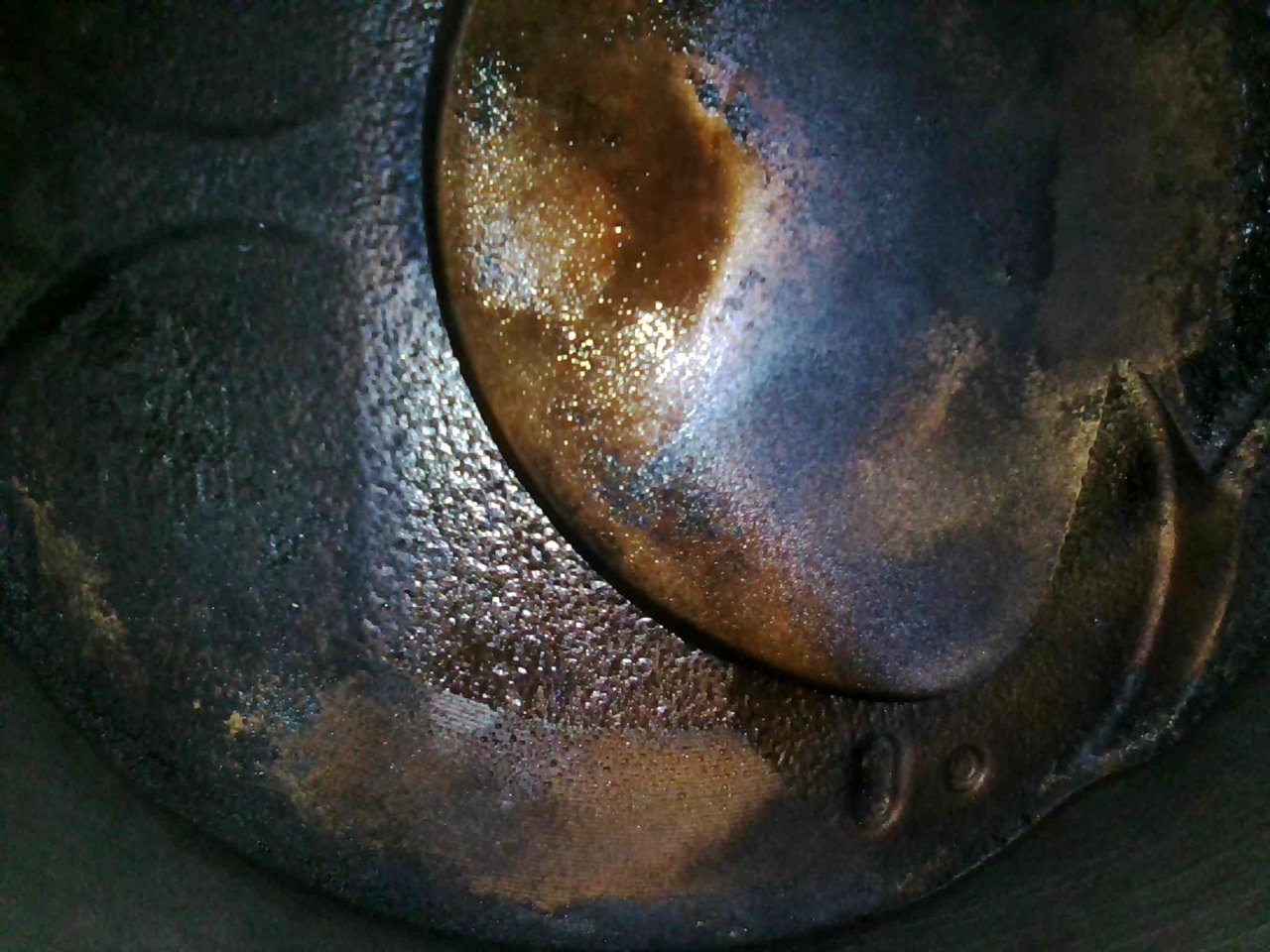

    Just swapped my plugs yesterday at 66k. Checked them at about 30k due to the loose plug reports.
    They looked pretty good and the primary task was not that hard, but I did hose myself during that check. The rubber retainer piece came out of the socket apparently when doing the right front plug. It was semi melted and seated hard around the plug. The socket could not get a bite. I ruined a cheap set of dental picks getting it out.
    Regardless, paying $400+ for this at a shop is 100% robbery. The plugs were $71.40 delivered from oempartssource.com.
    Also, scoped the right side bores and was happy with what I saw. These are the right middle. The front and rear were too close to TDC to get good snaps.

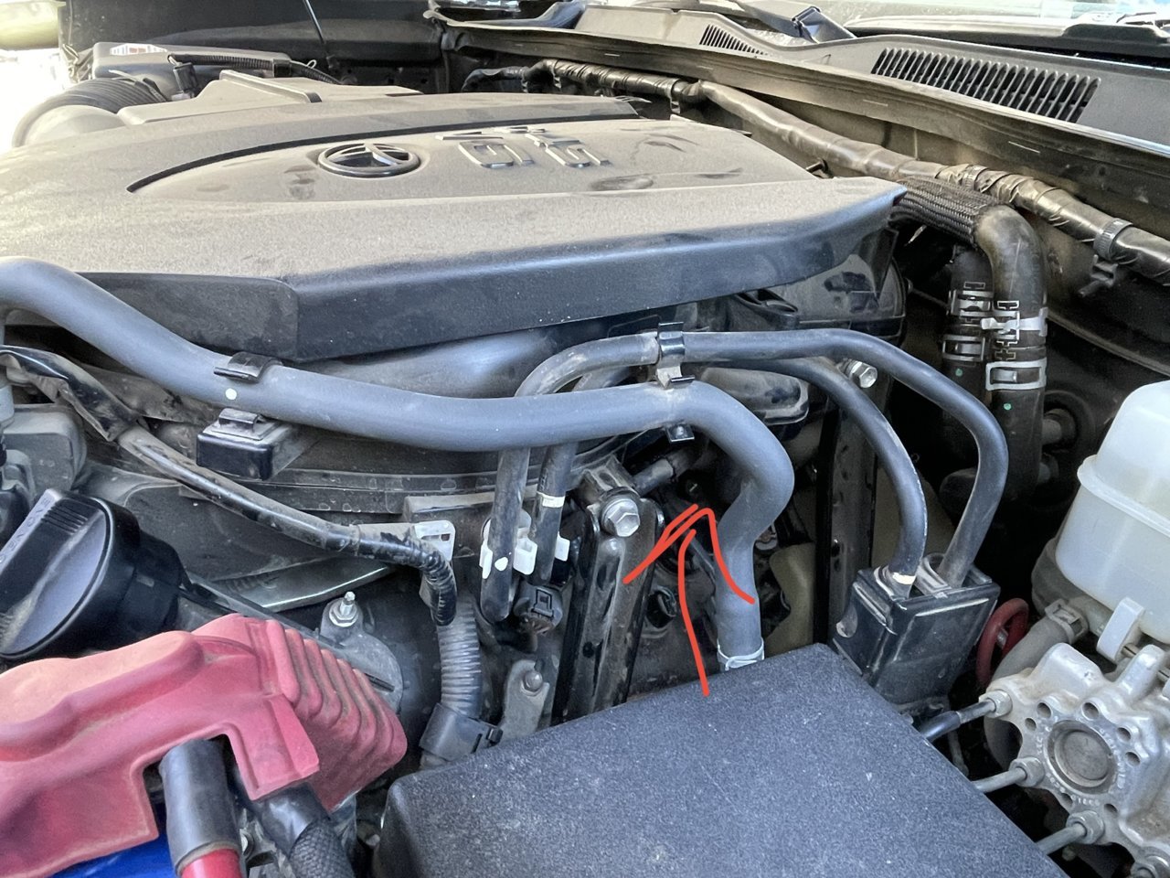

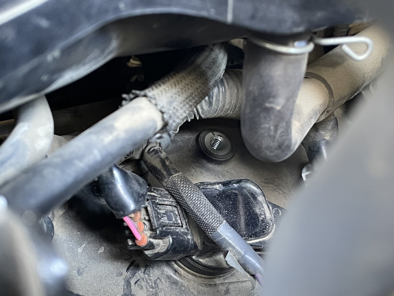

    Just replaced mine at about 97k miles. Took me a little under 2hrs. The coil packs all looked brand new and the spark plugs still had a lot of life left. Still glad I changed them anyway though.
    D0997B1B-2E0E-4C74-B83C-52B119CFC9E5.jpg 9D3A3EF8-6A99-4479-82D7-B78B7D8F106D.jpg 748E140E-1ABD-402C-9F35-F69650CD48D4.jpg
    I did find an odd thing though, it looks like I’m missing a screw (haha). What goes here? It’s by cylinder 5 (middle driver side).

    There are some extra inserts in the valve covers and intake plenum.
