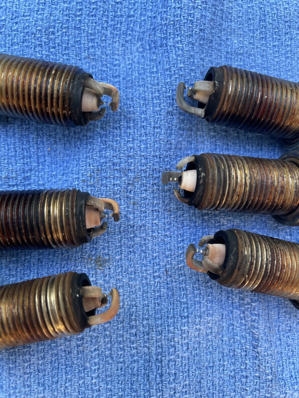

    Changed the plugs yesterday. 52k Miles. I did the PCV valve as well. pretty straightforward. just took out the top bolts of the plenum supports and loosened the bottom. Nothing out of the ordinary coils and boots were pristine. all the existing plugs were torqued.
    It took all of me to resist slapping some anti-seize on there, because that's my thing.
    Followed all the info here and in the posted videos Thanks!!!
    Obligatory spark plug shots.

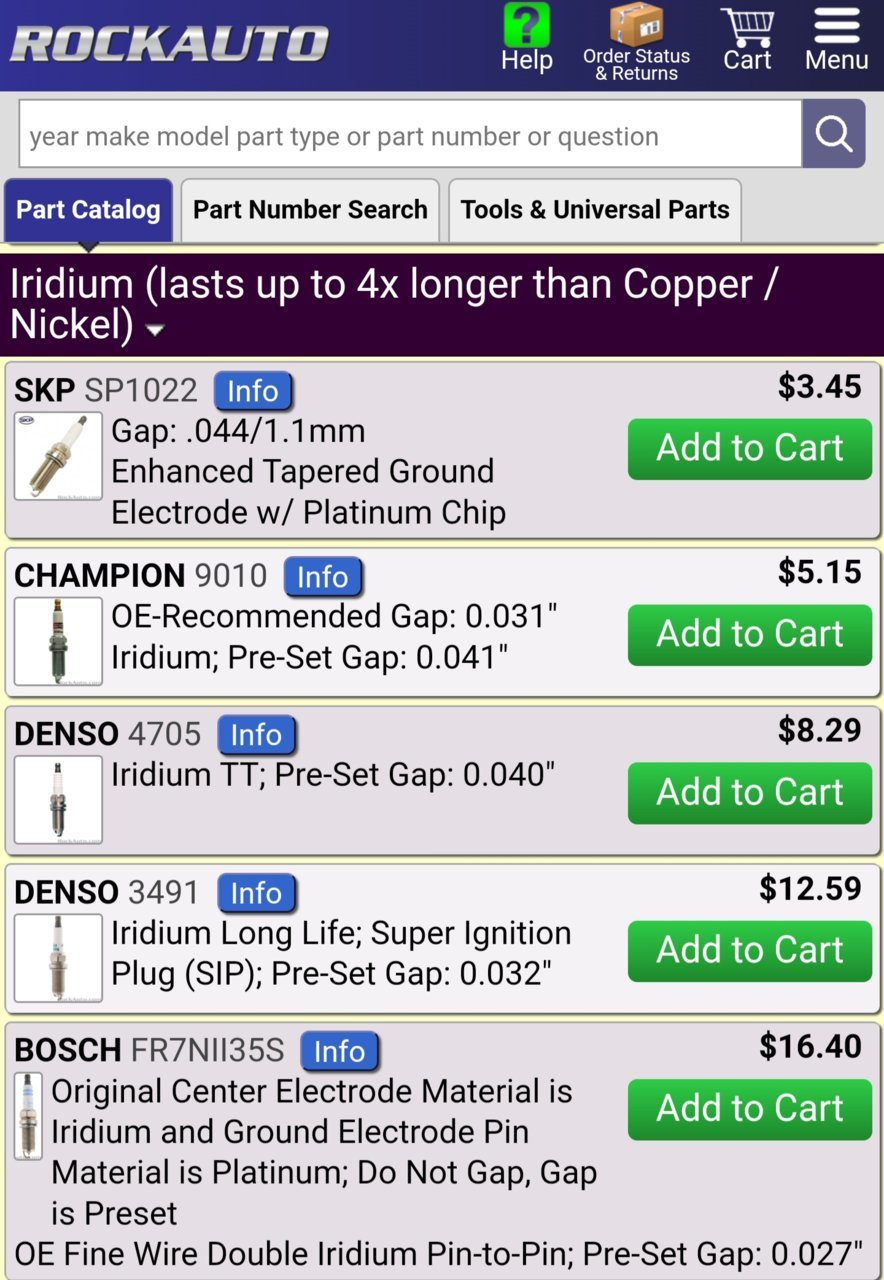

    Is there a downside from .040 vs .032
  15. Jul 5, 2023 at 5:59 AM
    #335
    joba27n
    joba27n YotaWerx Authorized tuner
    May 27, 2021
    #366948
    1,046
    Nolan
    Alberta
    2021 Gray TRD Sport Tacoma MT
    YotaWerx Stage 1, Bumper light bar, Hood wrap, Roadmaster Active Suspension, Durobumps.
    I'm running the twin tip plugs with a 0.04" gap presently, nothing really different i've found with running or driving. Maybe a hair smoother, can't say. I changed mine at 117'000kms and didn't really expect power gains mostly they were cheaper but still quality plugs. I plan to run 100'000kms intervals.
    To answer your question in theory though a larger gap produces a larger spark but for a shorter time. Advantages are that provided the spark isn't "washed" out (which I doubt unless you're boosted) it can ignite the charge more simultaneously which in theory provides more power and fuel economy. Cons are since the gap is larger the coils will be working harder to produce the voltage to jump the gap and the plugs wouldn't last as long because too large a gap from normal wear and the coil wouldn't have enough juice to jump the gap/the spark will be "washed" out
    Advantages of a smaller gap is longer coil and spark plug life due to vice versa of above along with better tail pipe emissions due to more complete combustion (i know that sounds kind of contradictory to above... hear me out) because without going too far in depth, basically the coil will spend x amount of energy no matter what for each cycle. Some is spent on starting the spark and the rest on maintaining the spark until it's out of energy for that cycle. The smaller gap will have a smaller spark but the spark will last longer, giving the unburnt fuel from combustion a longer opportunity to burn. Cons of a small gap are the opposite of the advantages of a large gap.
    again I mostly picked the 0.04" gap plugs for cost saving without a quality compromise and again I plan to run 100'000km intervals so I doubt they'll wear to the point of causing a misfire by then. If you're gonna be 160'000kms(100'000mi) or more then i'd maybe just run the long life plugs to be safe so you don't end up with having to do spark plugs unplanned.

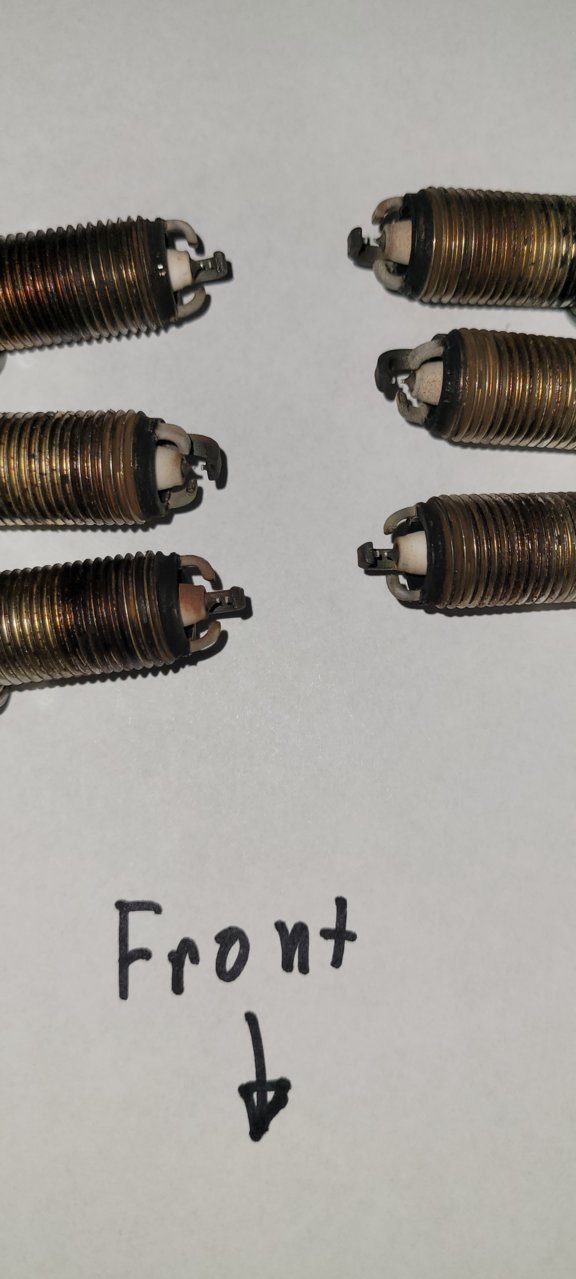

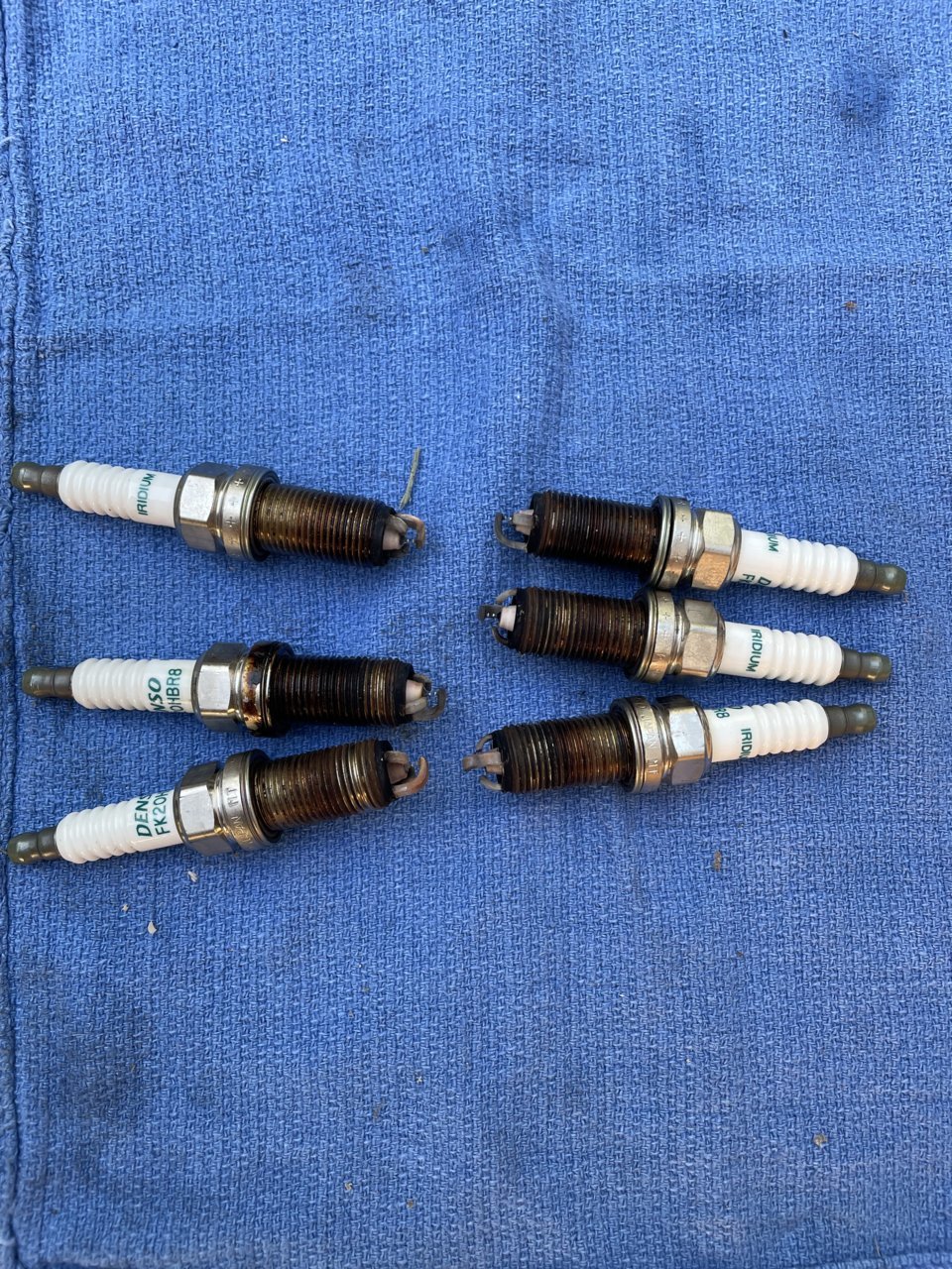

    Changed them out tonight. 61k miles. One of them had baked on crud on the metal portion, so unsure what that would be. All the coils looked new. Not a terrible process.
    The likes this.
  18. Aug 8, 2023 at 6:02 PM
    #338
    jerkwithkeyboard
    jerkwithkeyboard Well-Known Member
    Feb 15, 2016
    #178231
    981
    Western suburbs Chicago, ILL
    2016 TRD Sport DCSB Inferno 4x4, loaded /JBL/Tonneau Cover/ Roof Rack
    17" Black TRD rims Tacoma Stainless Steel Rear Tailgate Letter Inserts Brake light flasher Center LED 110v and 2-3amp USB plugs mod in back seat center 400w on all the time mod SSR-610-40 SumoSprings 32 INCH 180W CREE LIGHT BAR (5D ) AUXBEAM BedStep and Pop & Lock Power Tailgate Lock Blue LED glove box light (fix no light) Bed light Blue LED's Wired to turn on when Gate is opened Tempered Glass Center Touch Screen Protector Rear Camera anytime Navigation Bypass ( a must) Rexing V1 3rd Generation Dash Cam hard wired in OXILAM 912 921 LED Reverse Light 2000 Lumens TRD Pro Grill TRD Skid plate
    You get that when the plug is loose.
    if there not put to the right torque they wiggle loose after a while.
    people were checking after 30k and some were loose... i had maybe 2 if i remember.

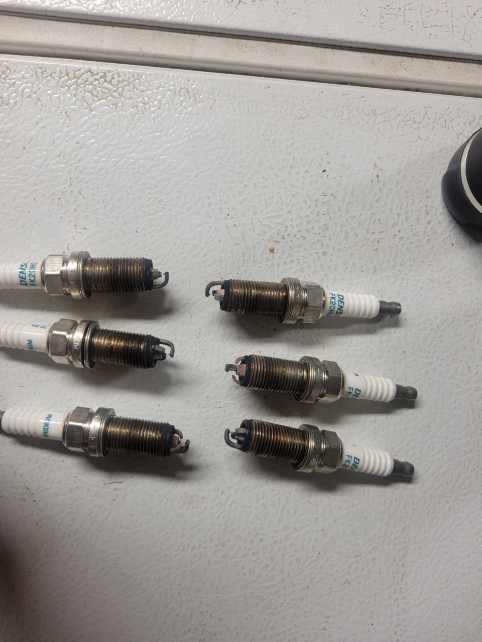

    I changed mine yesterday. No problems after watching 6 or so YouTube videos. None were loose.
