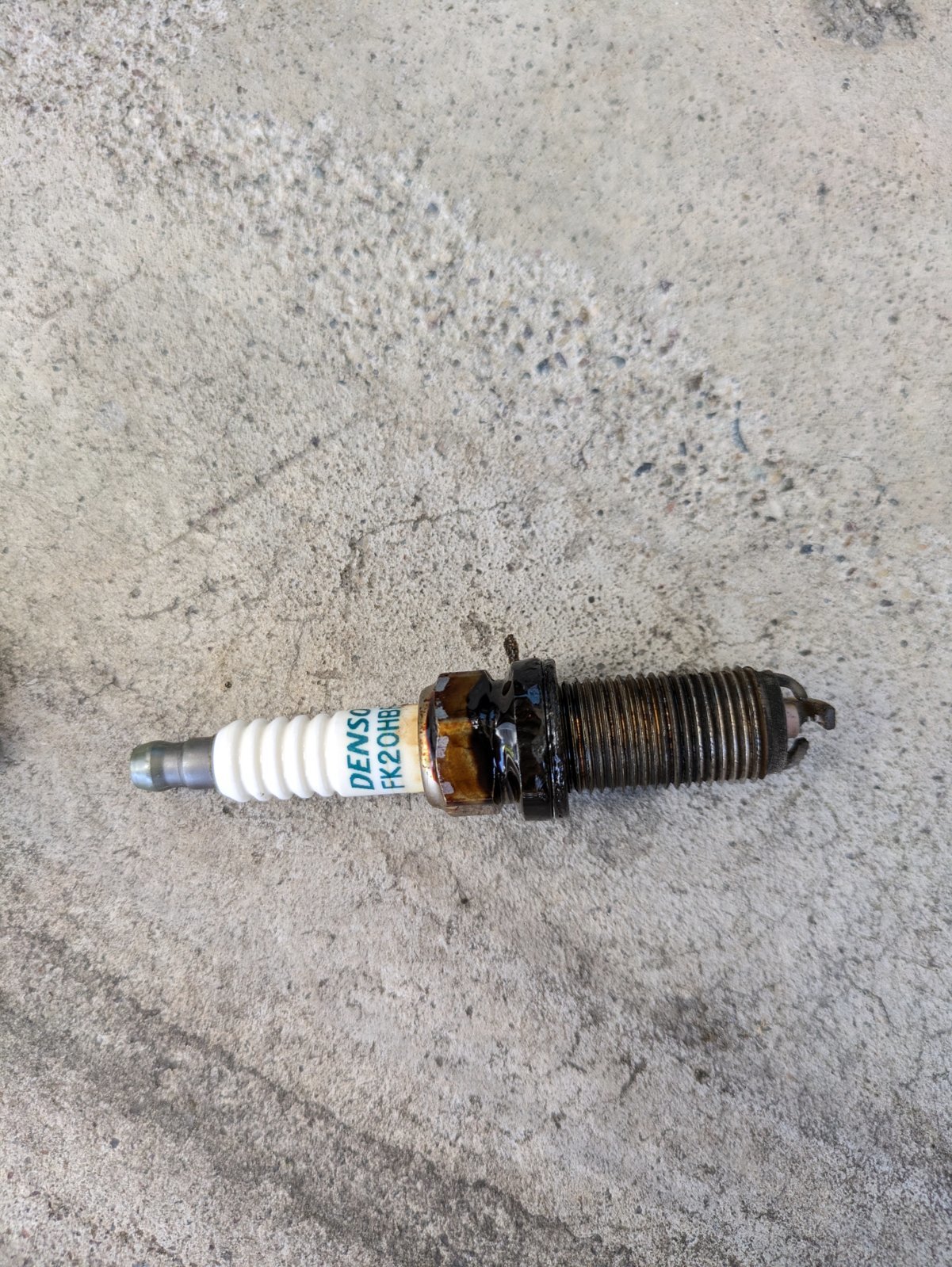

    Did this today at 79000 miles. Drivers side plugs were all pretty tight. Passenger side was a different story. All three were pretty loose, but #5 was the worst. Picture below. #1 and #3 didn't have any blow by.PXL_20231120_220719270.jpg

    That sure looks like a tube seal leaking from the valve cover.
  11. Nov 21, 2023 at 11:58 AM
    #351
    ihatemytruck
    ihatemytruck Smartass
    Jul 26, 2013
    #109078
    1,636
    Dave
    Southern California
    '17 Tacoma 4x4 off road DCLB
    I assume I would need to take the valve cover off to replace that seal, right?

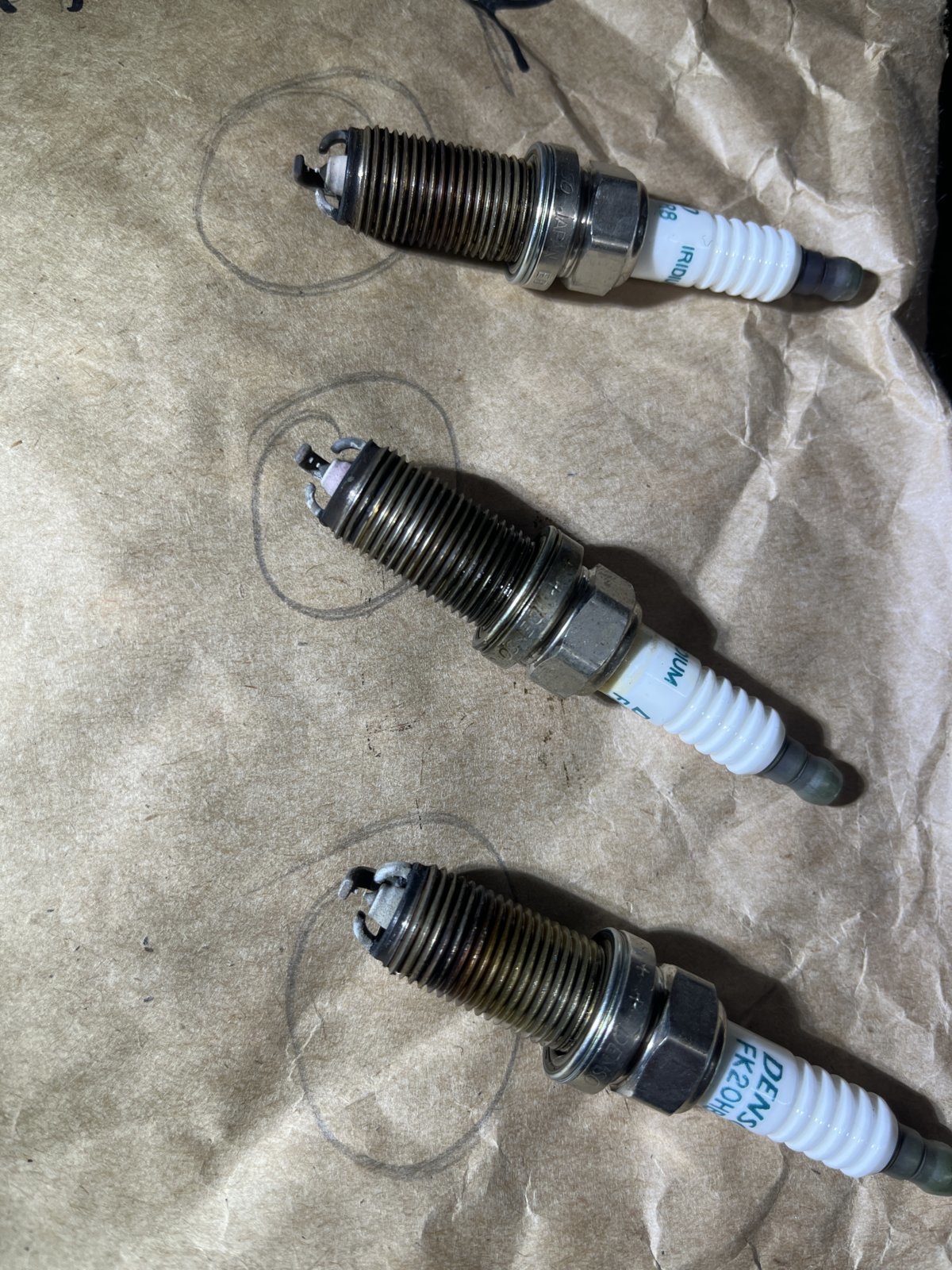

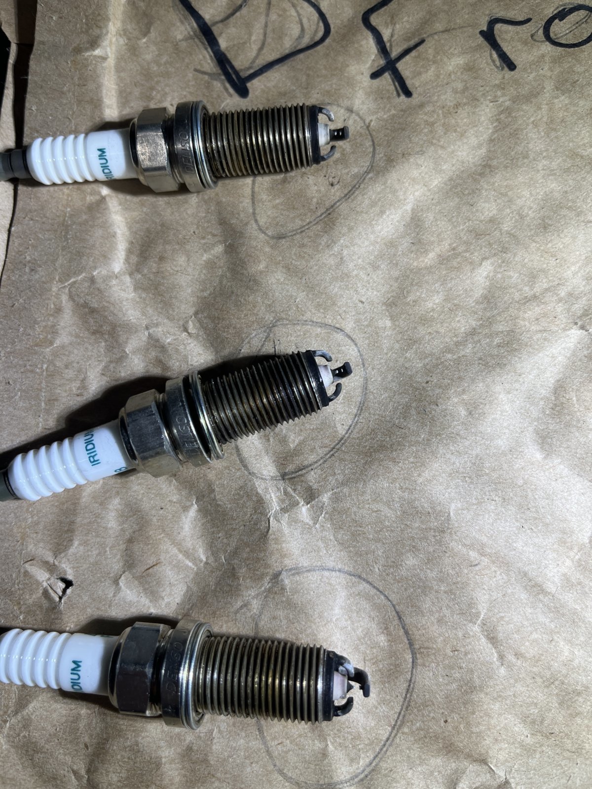

    Did plugs today. I bought truck used with 122000km on it. It now has 139000km on it. Looks like they may have been changed at some time but now I know it has new. image.jpg image.jpg
