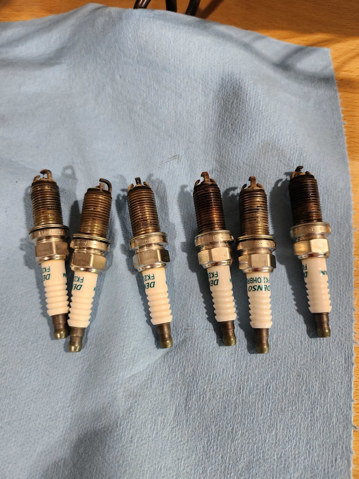

    Alright I found a couple of free hours today and decided to save the $200 and just do it myself. Took me about 2.5 hours but I took my time and took a lunch break with my 4 year old who was with me the entire time asking questions. Drivers side was a bit of a pain but once you get the hang of the first one in tight spaces it's not so bad. So I'll consider it time well spent and my little guy got to see what it's like working on an engine.
    When I started the engine right after the idle was rough and and it was revving quite a bit. Shut it off after 30 seconds and remembered I forgot to connect the hose to the intake manifold... Reconnected and alls good again! Runs smooth and accelerates smoother (at least in my mind) will see how fuel mileage is this week
