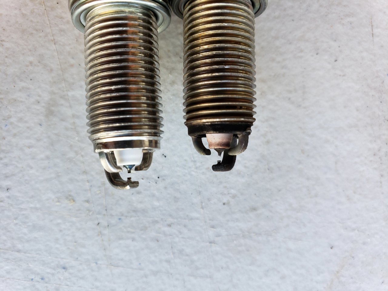

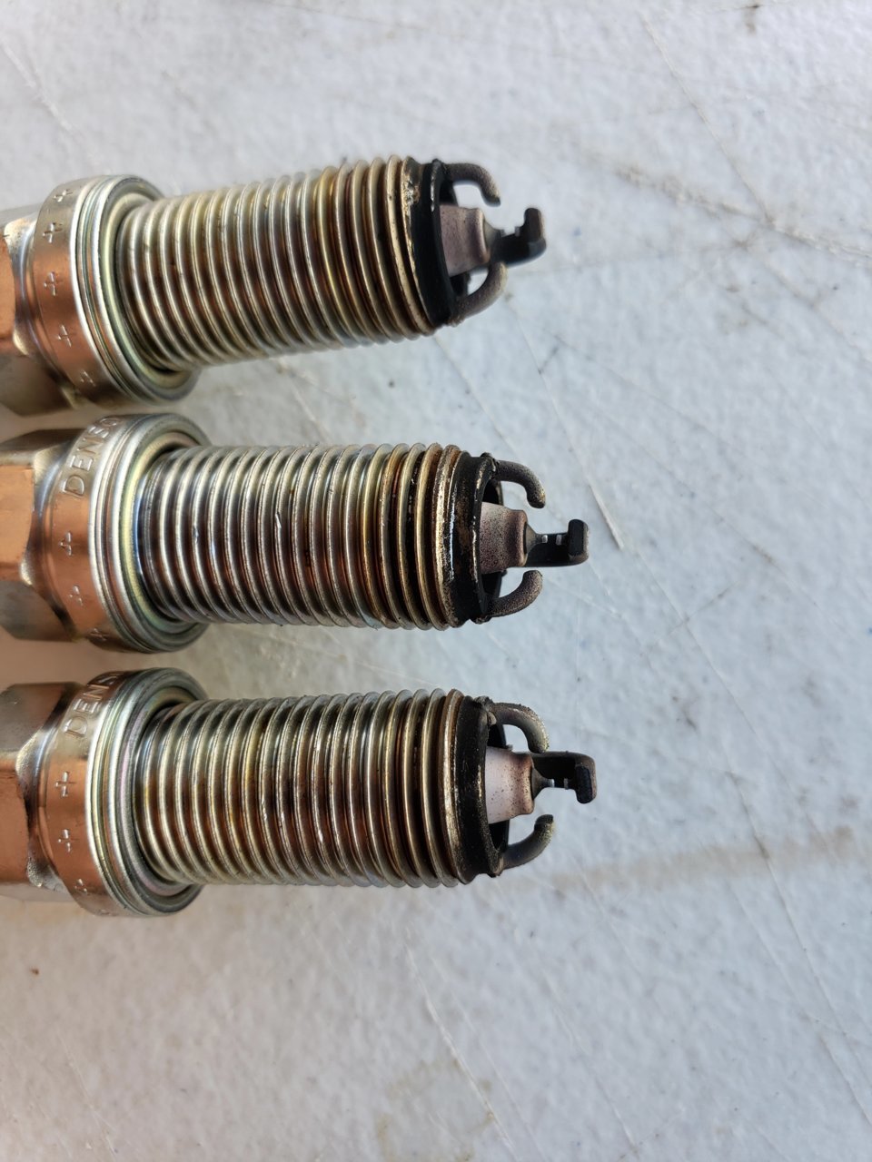

    Old vs new at ~62k. They look fine to me still but I'm no expert.20190713_073659.jpg7314641314979994968_PerfectlyClear.jpg 20190713_073742.jpg7044605849524422162_PerfectlyClear.jpg 20190713_073659.jpg7314641314979994968_PerfectlyClear.jpg

    One tool I don't see is a spark plug wire with a rubber boot . It really helps to install plugs NOT cross threaded to use one . With OUT one it is really easy to cross thread plugs. I think you did well, but any next times, and I know it won't be Uncle's for a very long time .
    So how many miles on them? How did they look ?

    Probably due to difference in electrode design.
    https://www.densoproducts.com/Denso-Automotive-Products-c1351.aspx
    https://www.densoproducts.com/learning-center/article/203/how-long-will-denso-iridium-plugs-last
    https://www.densoproducts.com/learning-center/article/780/what-are-denso-twin-tip-tt-plugs

    it was around 60K. plugs looked fine, but i changed em out anyway.
