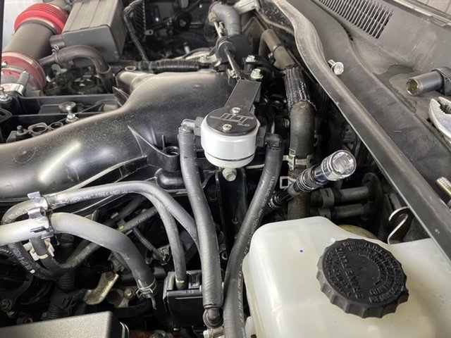

    I took the intake off. Really wasn't that bad. Just one of those deals where if you know what you're looking at, makes it go quick. Took me about two hrs. Next time it'll probably take me about an hour.
    70k
