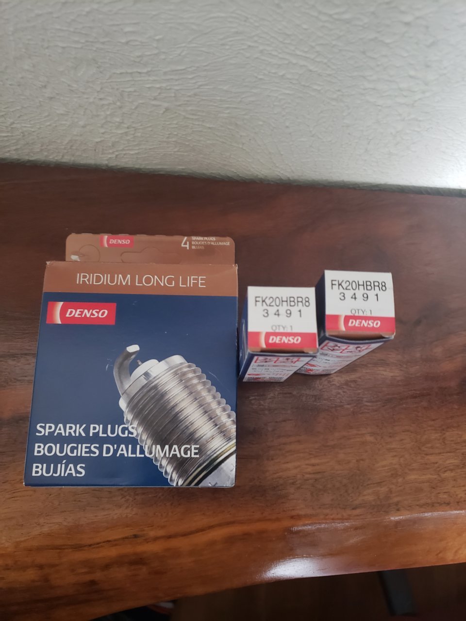

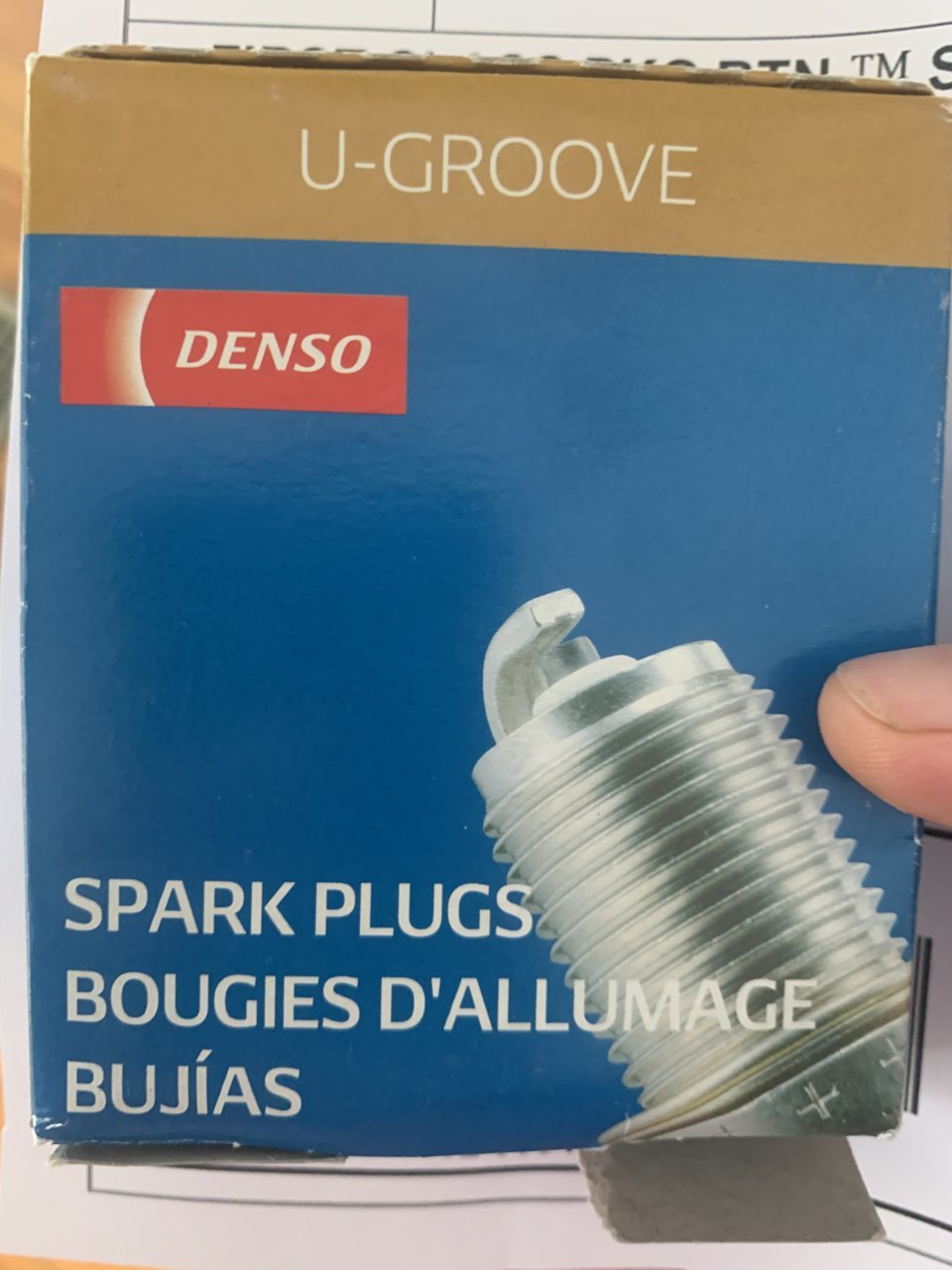

    PSA- avoid rockauto all together. They sent 2 of the right plugs and 4 of these random U groove plugs. Took forever to
    ship and can’t even send the right plugs. Next time I’ll be happy to spend the few extra dollars on Amazon.

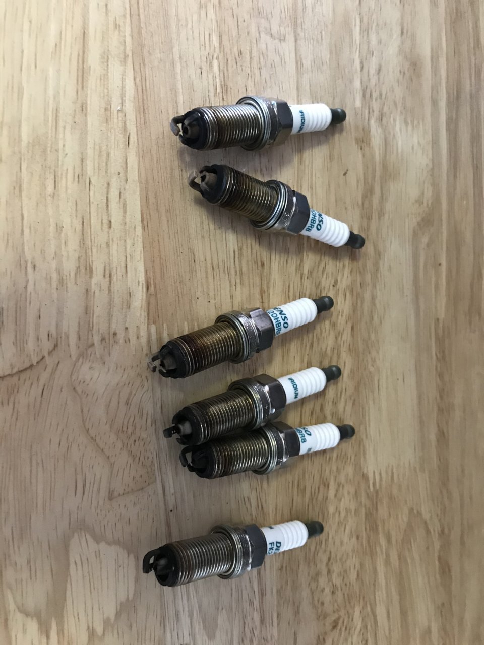

    Changed my plugs yesterday. I got the new spark plugs at that new Toyota off the 303 N. in Surprise AZ. 134 bucks. I am Mr. Frugal but after looking, and looking, decided pre gapped from the dealer and no shipping etc etc...ok I paid a premium for a little peace of mind. Thanks for all the information on here. The plugs look like they came out of an old 2 stroke. I am watching that "catch can" video right now. Hmmm, says I can't run that catch can in California, go figure.

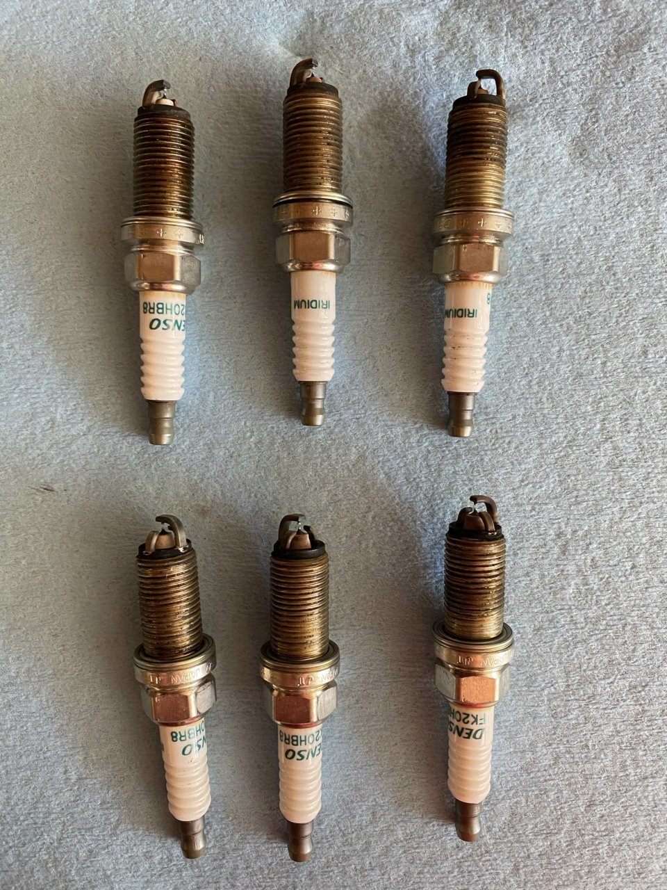

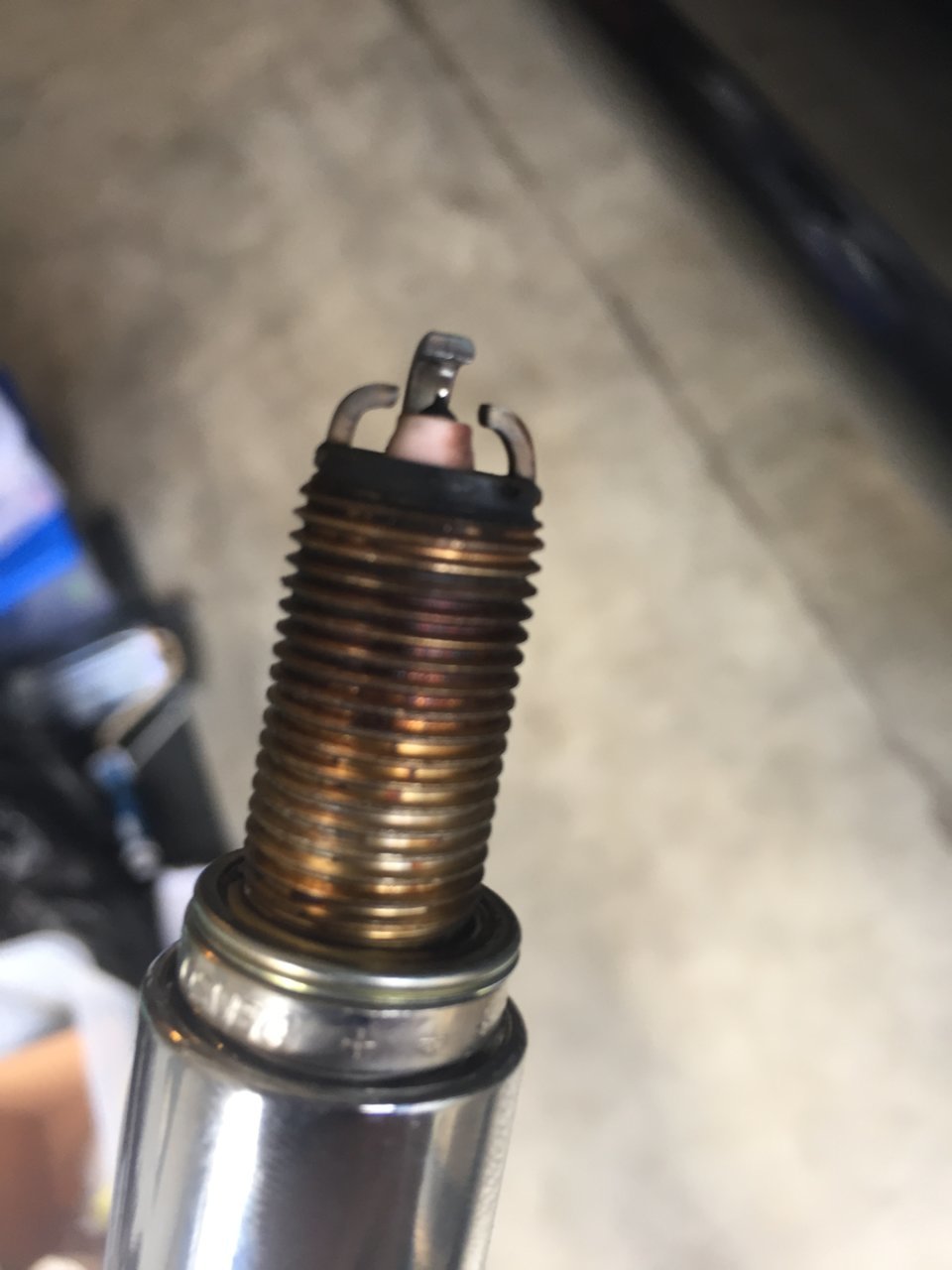

    2025 OR DC iF Max
    Truck running ok with loose plugs at about 20,000 miles. Removed all six to check tips, reinstalled and torqued to proper spec.9BE0027A-885D-4E04-AFDA-EA6BFF76FC75.jpg
    CaptainBart45 likes this.
