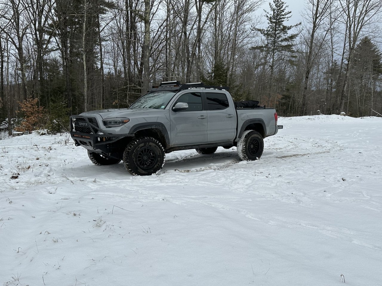

    This is how my truck sits. About 1 inch higher in the rear.
    Im sitting on fox 2.5 kit front and rear
    spc uca
    ironman4x4 leaf springs
    285/70/17 bfg ko2’s load range c @30 psi
    rrw RH-7 17x8 +0 offset wheels
    Alightment specs are
    Oem spec toe
    Oem spec camber
    4 degrees of castor.
    My truck does have some tramlining. What bothers me is the jerking in the steering wheel when going over potholes/ manholes. Very floaty on the highway.
    Also like to mention. This is a new set of suspension and this issue started when I had an eibach kit on.
    I appreciate everyones help, Thank you.

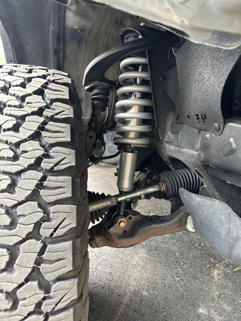

    Maybe take a peak and try to measure to ensure your steering rack is centred before the alignment but the downward angle of the tie rods with a lift will cause more toe change over bumps because the travel arc of the tie rods will steer the wheels more. Also 1* of camber POSITIVE will help but note the peigon toe may be noticable to you, fore warning

    I don’t believe my spindles are bent. Nor do i think this preload is maxed out. Also i have the sway bar removed for the day to see if it made any difference. Nothing noticeable yet. Do my tie rod angles look too extreme?

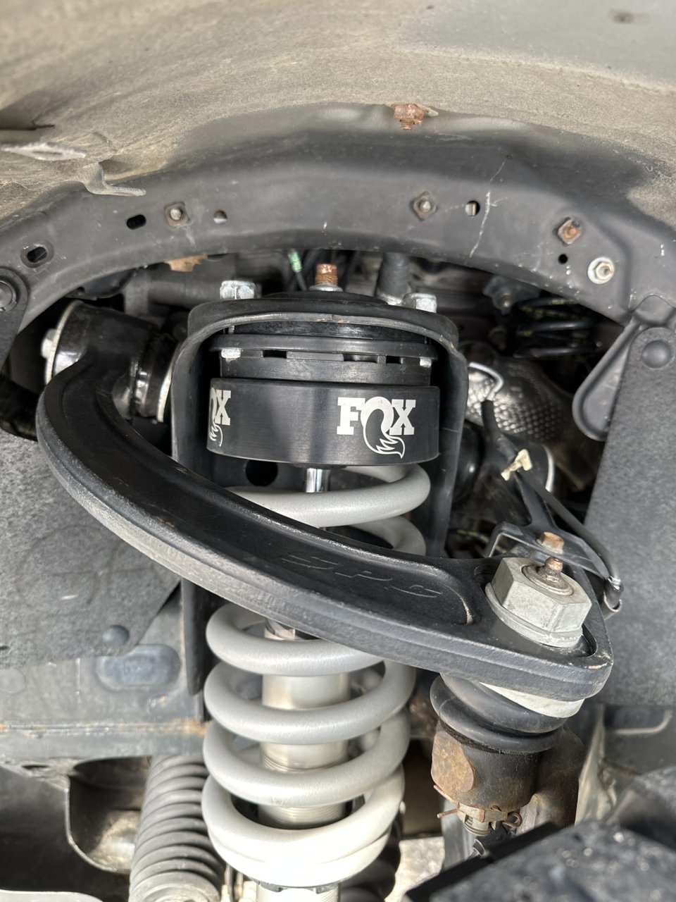

    Do you have a spacer lift on top of your shock mounts? Post a better pic of the top of the front shocks
  17. Feb 6, 2023 at 9:23 AM
    #37
    JoshC2219
    JoshC2219 [OP] Well-Known Member
    Sep 20, 2021
    #377566
    62
    Josh
    2018 Cement Tacoma Trd-Offroad
    Oversized tires
    I do. I have a 1/2 spacer on both sides. I have removed this and gotten a new alignment. Resulted in no change is driving characteristics. Just got a super loud clunk when i was parked and i turned to the drivers side

    It's not much your tie rod angles are extreme. Not ideal yes but unless you replaced it with a knuckle that would have the tie rod mount back in line with the rack thats how the angle will look. The big thing to take from looking at the angle is to picture that even though the tie rod is moving in a circular arc the ball joints keep the knuckle steady so the tie rod moving from a not level angle will steer the wheels more and if you for say hit a dip in the road and had a go pro on a car in front of yours rear bumper you would see a big tire steer

    To me, it looks like you're maxed out on preload, and the 1/2" spacer is essentially adding that much more in thread count. Fox 2.0 are for stock trucks with some leveling involved (edit: he has 2.5s). It seems you need a more robust solution for your needs. Just my two cents, and I'm not sure if it's the contributing factor to your situation. If you haven't seen, check Tinker's videos:
