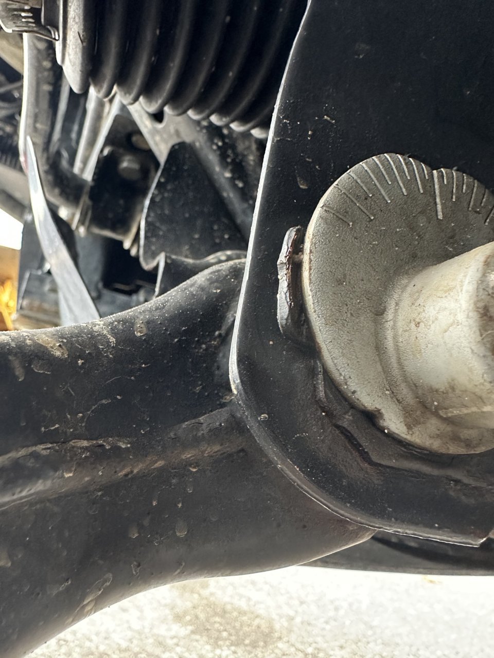

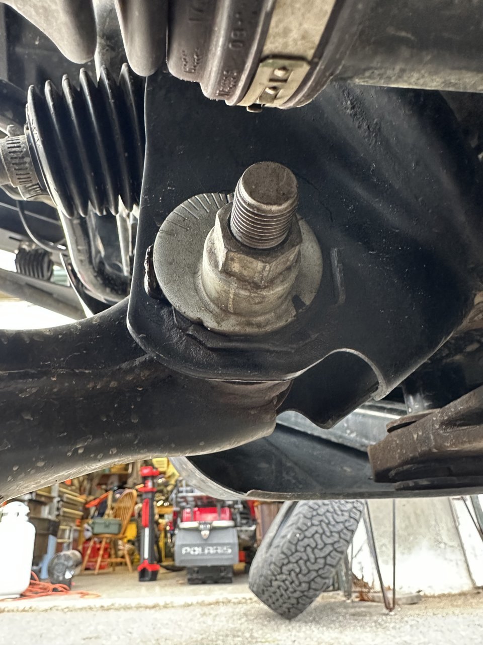

    thank you! I took a drive down to a local shop i heard about called rocko vehicles in ma. They took a look at my truck and recommended i dropped the rear by going to a lighter duty leafe pack. (Heavy to medium) which i did. That allowed me to remove the 1/2 soacer from the front of the truck. While i was removing the spacers today I notice my lca cam tabs are bent. Im going to have them install the total chaos cam tab gussets and re alignment the truck. (Note they are a spc dealer so their tech knows his was around them!). Im excited to see if this was the culprit all along. The steering wheel changing center/the wander and bump steer caused my the constant shiftin in alignment.
    9FDC28A9-7EE6-4F5C-AEE6-520037F5B4CA.jpg 222069F9-D3FB-4687-8CEA-5D76B9D8B4DD.jpg

    Wish I had some experience in welding so I could tackle this myself. Unfortunately im a little out of the comfort zone on fixing this one!

    I can't believe your alignment shop didn't catch that bent cam tab. Was there any reason for the heavy leaf pack in the rear? You're riding on what I'd consider the opposite of ideal; I'd think you'd want the #700 spring in front (because of the bumper weight), with a light-duty spring on the rear (unless you're loaded with weight). You have the lightest spring and 2.0 Coilover up front with the heaviest spring out back. :notsure:
    I personally have the MARLIN LCA BRACE KIT which you can read more about here. trail 4 runner .com has a good writeup and comparison to the TC tabs. Also, as another option, consider these compared to the TC tabs. :thumbsup: And, use anti-seize on the cam bolts. :rimshot:

    Any update if that was the issue? Think I’m having a similar issue. But looks like the shop bent the cam tab back. As it looks a little chiseled away. My bumpsteer is bad from low speeds all the way up to high speeds. And it’s predominantly on the driver side, jerking the steering wheel to the left every time.

    The truck is currently at a shop getting the total chaos cam tab gussets done. I will update when I get the truck back

    So here is an update on the situation. The shop ended up having to replace the lower control arms due to the cam bolt seizing in the bushings. They installed the total chaos gussets and installed new control arms. Also did an alignment. Wish I wasnt on vacation and didnt need my truck back when I got home. Would have saved myself 1000$ in labor costs. Anyway, if you couldn't guess that still didn't fix my problem! At a total loss of direction. Ive had 4 professional shops who specialize in off-road vehicles look at my truck. Im now at the point that I dont really care how much it costs. I am going to replace all the steering components at this point. Steering wheel doesnt come come back to center very quickly or sometimes not even at all. Power steering pump looks like it might have a small leak too. If anyone has any ideas before I lose my mind and spend all kinds of money id greatly appreciate it hahahaha.
