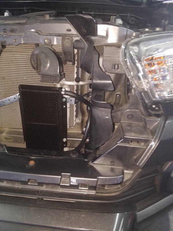

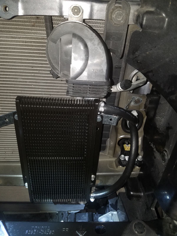

    I installed one on my truck about six months ago and I went with a B&M cooler. It was pretty easy to do. Once you decide how you want to mount the tranny cooler. The hose at the bottom right of the radiator (facing the truck) is your line out. You need to use that radiator connection with a new piece of hose and connect it to tranny cooler. Then take the other connection from the tranny cooler and using a new piece of hose to splice it with the hose you disconnected from the radiator. If you don't want to splice the hose then you can run a new hose all the way to the transmission (for me splicing the hose was easier). There is opening to the right of the radiator (facing the truck) and I used that to run all the hoses. i also used a piece of hose to line the opening so that there would be no issues. NOTE: Before you do anything pickup a quart of tranny fluid (ATF WS) from your local Toyota dealer. You're going to need that compensate for the new tranny cooler. Here are some pics of the install. FYI, I painted all the brackets black later.

    What did you use to top off the ATF? also how did you measure to know when its full

    I put about 3/4's of the quart back in. My cooler uses 1/2 a quart of fluid when the fluid is running through the cooler. We put a little more than the 1/2 because we lost a little bit of fluid when testing to see where the fluid came out of the radiator. We made a small funnel using the cap of a squeeze bottle and poured the fluid into to the hose that was still connected to the transmission. After we poured the fluid we clipped the hose so we wouldn't lose any fluid and then we spliced the new hose with the old hose. After we spliced we removed the clip and turned the engine on to test for leaks.
