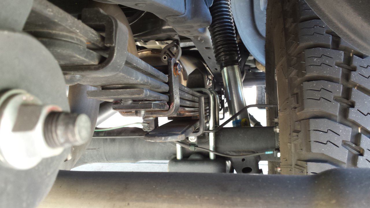

    What's the weight of the bass boat and frequency of towing?
    I have a wheelers 3 leaf progressive AAL and have the overload leaf installed for about a year now. Great ride and have about 200 lbs of stuff in my toolbox everyday but I don't tow hardly at all.
    Still level from side to side, paired with 885 springs and 5100s front and back to retain the factory rake. I also have a 1/4" spacer up front to compensate for lean.
