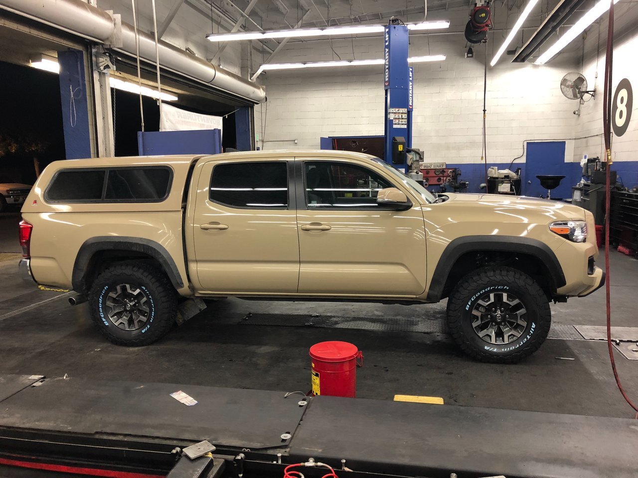

    Should I put billstein 5100's on or keep stock suspsension ??? Decisons Decisions >.......

    Always upgrade as stock stuff is usually basic, but to me right now you look to have some Bro Lean

    Where the front sits higher than the back, take some measurements from the center of the hub cap to the bottom of the fender flare. So which is highest

    The front of the truck looks higher than the rear.

    lifting the rear will require more than just new shocks. You'll likely need to go the route of a new leaf pack or adding a block, which most people on this forum don't recommend to say the least.
    My truck stance was similar to yours before I lifted. Now my rear is about 1.5" higher than the front when unloaded, which I personally like the look of.

    Thanks for the info ! I will most likely be adding a block in the back !

    Is the sagging only from the shell?

    Take measurements first, as that wall in front of the red bucket could be making things look nose high. I am perfectly level but in this pic the rear looks higher.

    nice truck! seems like your rear is sagging too much. I also have a cap and it doesn't sag like that... do you have cargo in the bed weighting it down?

    no, dude. add a leaf.

    Right, no blocks, and no spacers. Let's spend 33,000 + on a new beautiful truck and put a 50.00 suspension lift on it. Never understood that thought process.
