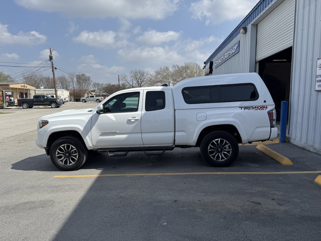

    Base truck:
    2023 Tacoma TRD Sport Access Cab v6 4x4 Long Bed
    First upgrade:
    Leer 180 camper shell (next upgrade: getting it painted)

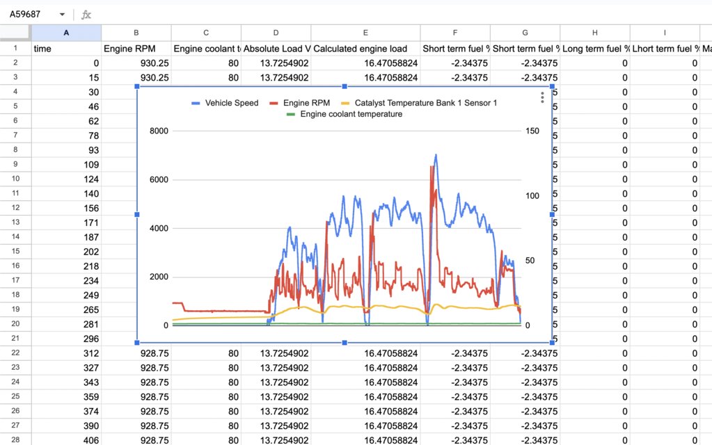

    Second upgrade:
    Tune by @Texoma
    Thanks, Chris!

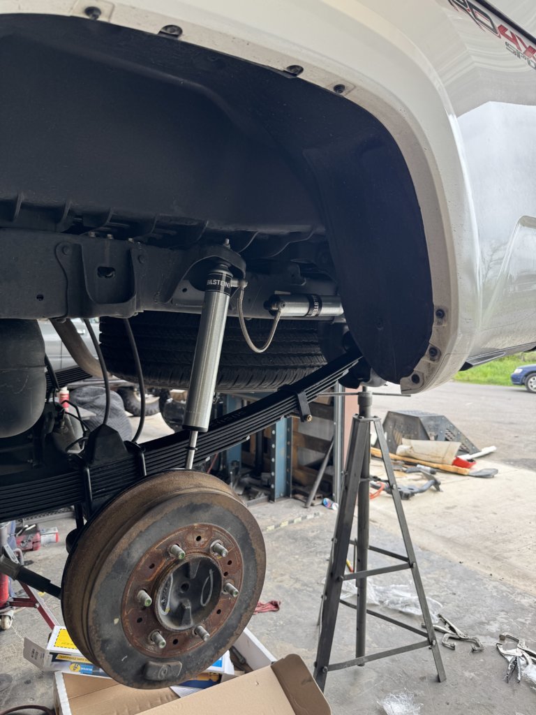

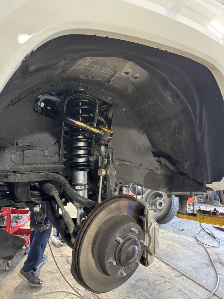

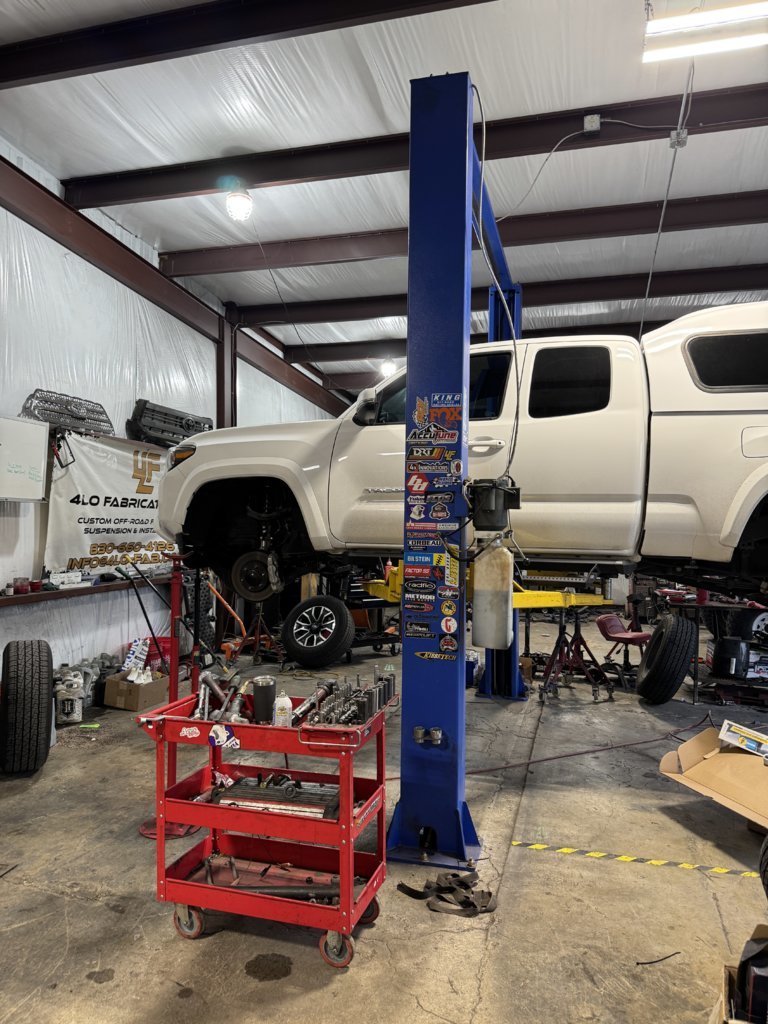

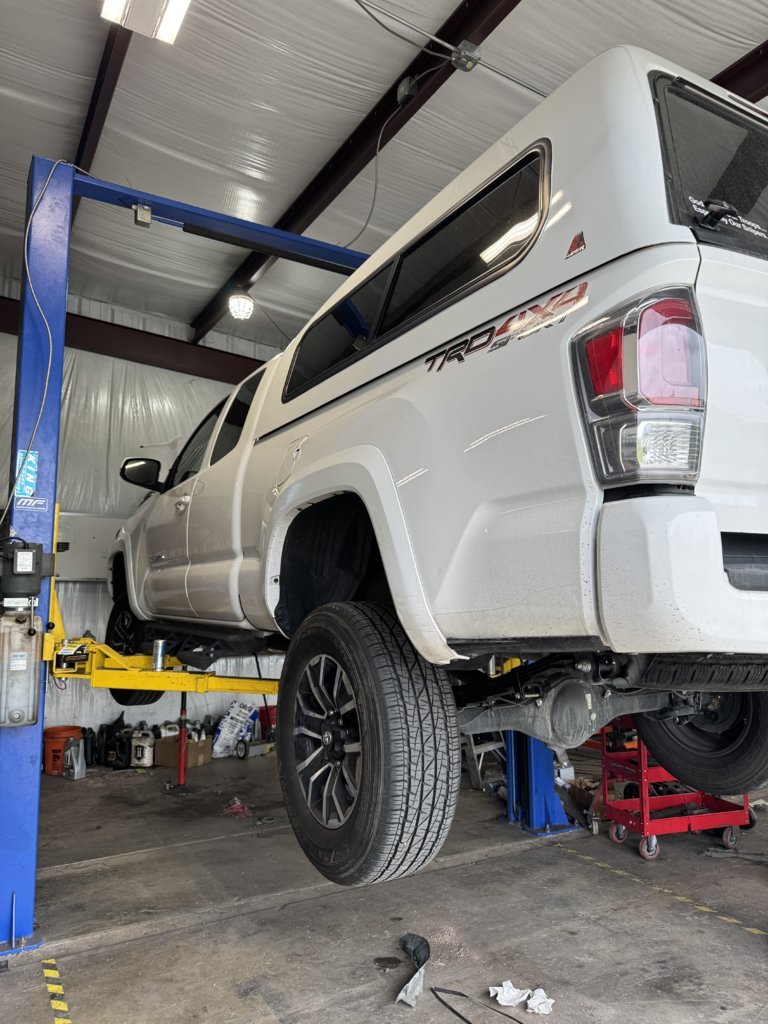

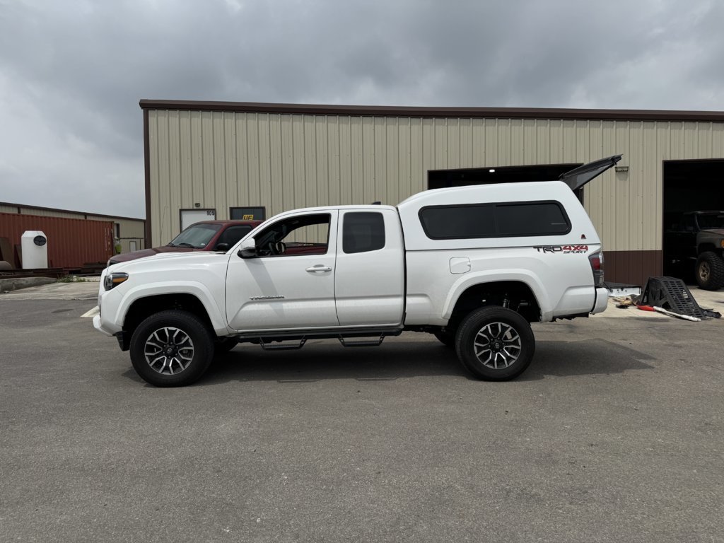

    Fourth upgrade: Suspension
    Bilstein 6112 / 5160 shocks + Icon RXT multi-rate leaf pack
    Thanks, 4Lo Fabrication!

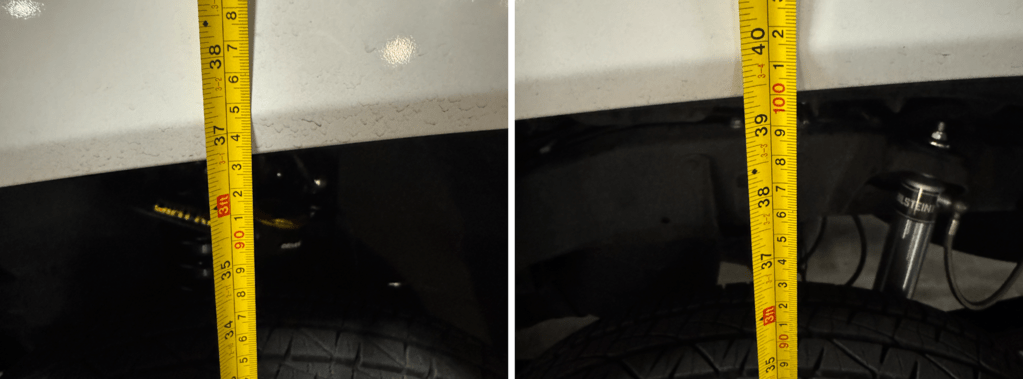

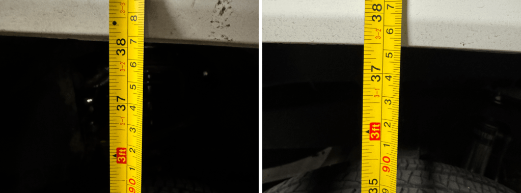

    6112s were set to 2nd from max circlip. Leaf pack was set to stage 3. Docs say I should have gotten ~2.25 in front and ~2.625 in rear lift. Failed to measure the ride height before so unsure of actuals, but I have documented how the suspension settled in over time which has been really interesting.
    Day 1 rake: 2.6875 in
    Progress photos:
    Rake measurements
    Front (floor to fender) = 36.6875 in
    Rear (floor to fender) = 39.375

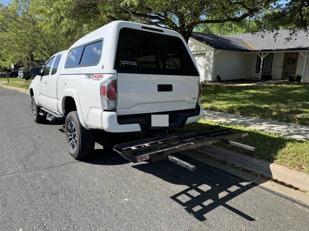

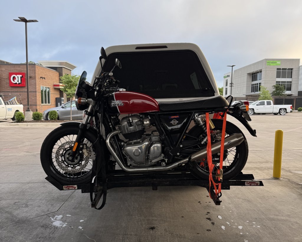

    Fifth upgrade:

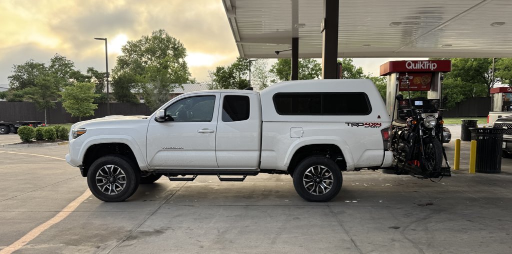

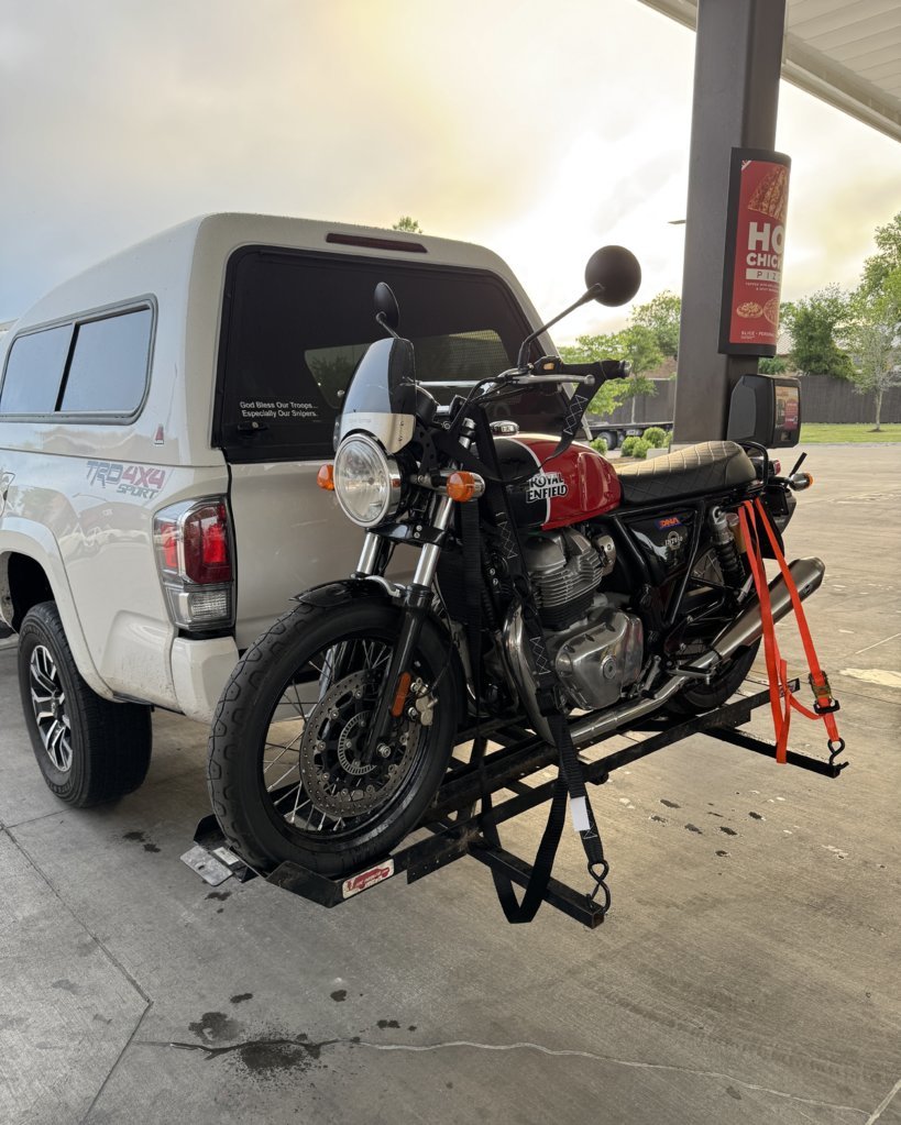

    JoeHauler Deluxe Cam-Loc Heavy Duty Hitch Carrier
    I'd been stuck on getting a trailer vs other options to bring my motorcycle with me. The Harbor Freight and Black Widow carriers just don't seem that well made, but I won't have guaranteed storage for a trailer at every stop. A nice guy from San Antonio posted this burly hitch carrier on FB Marketplace -- my lucky day. It's definitely broken in, which gives me confidence it'll keep on kicking for my trip and beyond.
    Rake measures -0.625 in with bike on the back and truck otherwise empty. Don't love the squat, but the Icon leaf pack is doing its job, and I think it'll be close to 0 when I'm in the cab with all my gear.
    Unloaded:
    Loaded:
    Rake measurements:

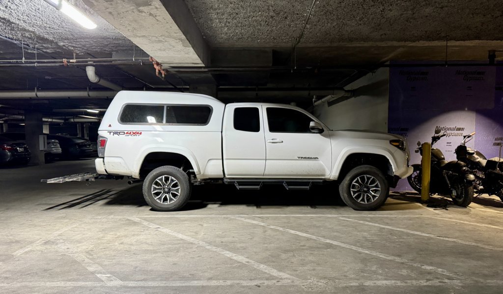

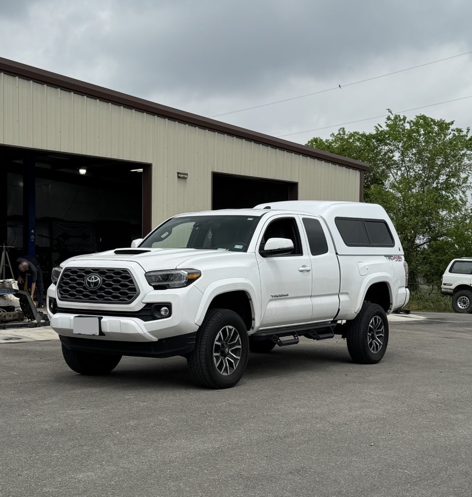

    Suspension update:
    The suspension has been settling in. Loading the bike definitely helped. We're now back to factory rake (~1 in). Pretty pleased with how it's sitting, especially with the camper shell up top.
    I've decided to run through the stock tires before going bigger, so this is the rig that will take me cross-country.
    Rake measurements:
