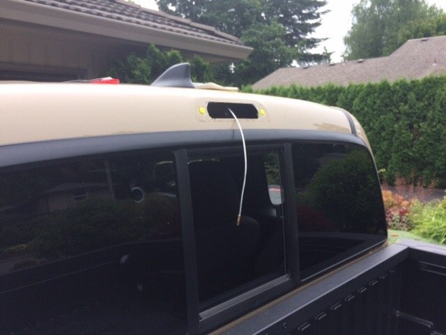

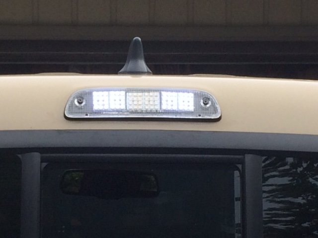

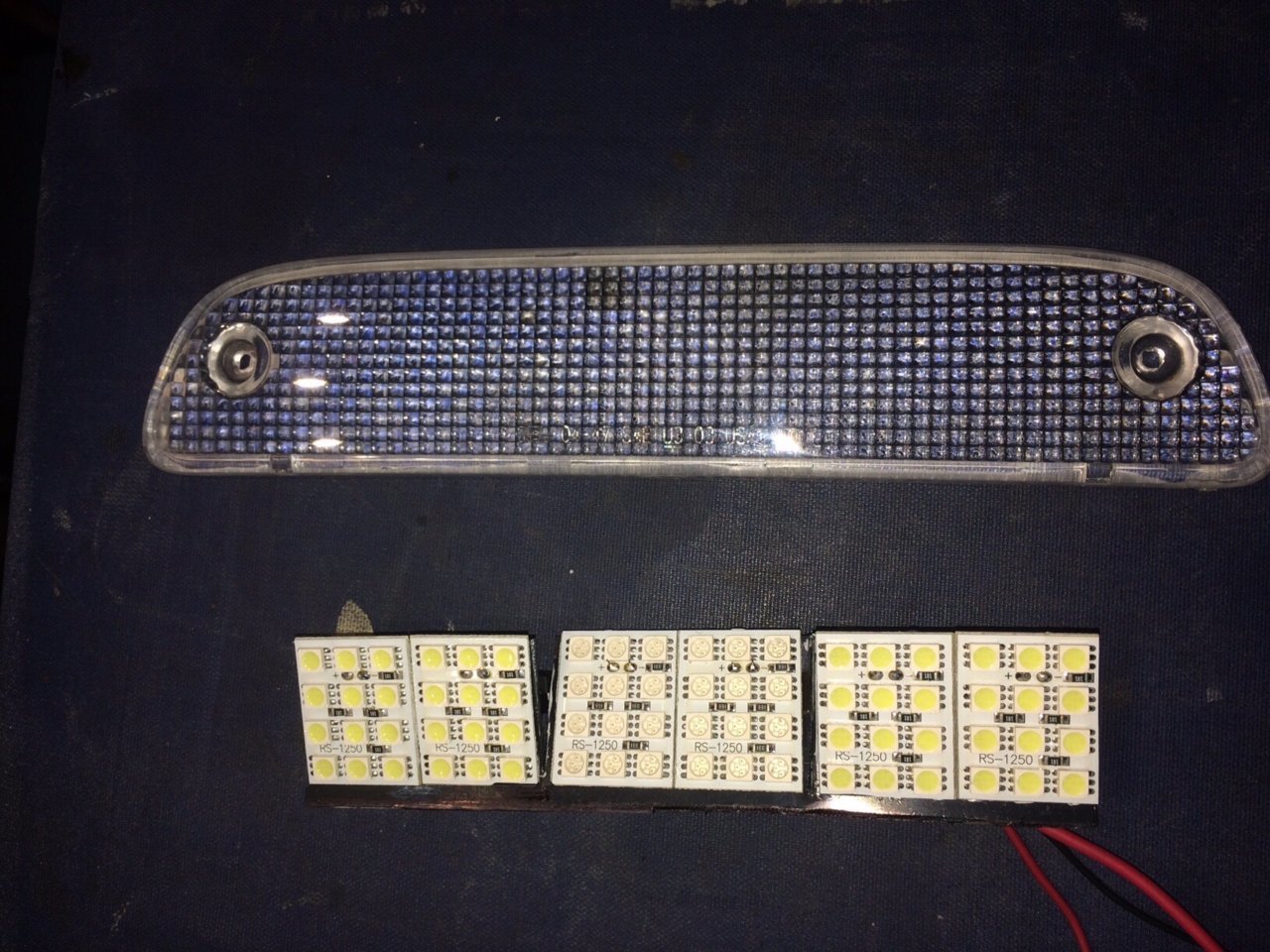

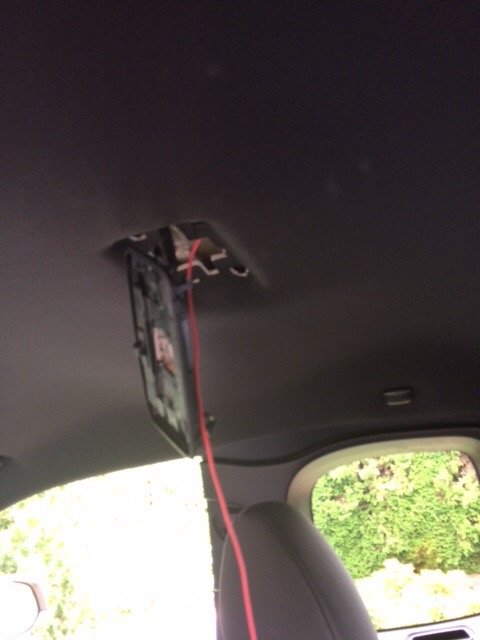

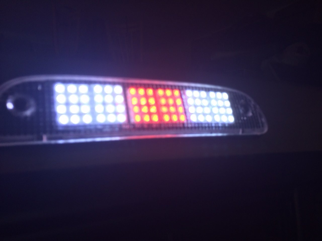

    Okay, bought four white led panels and two red ones off eBay, bought a clear lens from a company called Kleerz. Then I removed the old light and wired the brake light to the red led panels, then I pulled a wire from the dome light back to the brake and connected it to the white led panels.

    So you open the door or hit the dome switch and they light up. Basically the dome switch is the dash switch in the other Tacomas.
  11. Oct 15, 2022 at 5:36 PM
    Captqc
    Captqc Well-Known Member
    Mar 5, 2017
    #212458
    5,150
    Tigard, OR
    2017 Tacoma 4x4 TRD AC Off Road
    Yup, they light up when I approach the truck as they are tied to the dome light.

    Just a smidge of soldering I would imagine then.

    Super easy mod , just make sure you disconnect your battery before you connect any wires.

    Thanks. Glued the led boards in place I imagine no reflective backing needed?

    just be sure to spot check those led boards every few months. my boss insists on running similar discount led boards in the dome lights of the work trucks, and after about 4 months of hard use, the led's start burning out and/or the resistors start falling off from heat cycling.

    Yup, I glued the led panels in place. And to soundman98’s comments about the LED’s, I’ve been running mine since 2017 without failure.

    Last question. Resealing the light to the truck, where did get a gasket on the cheap?

    Bought a cheap brake light on eBay and used it’s gasket.
