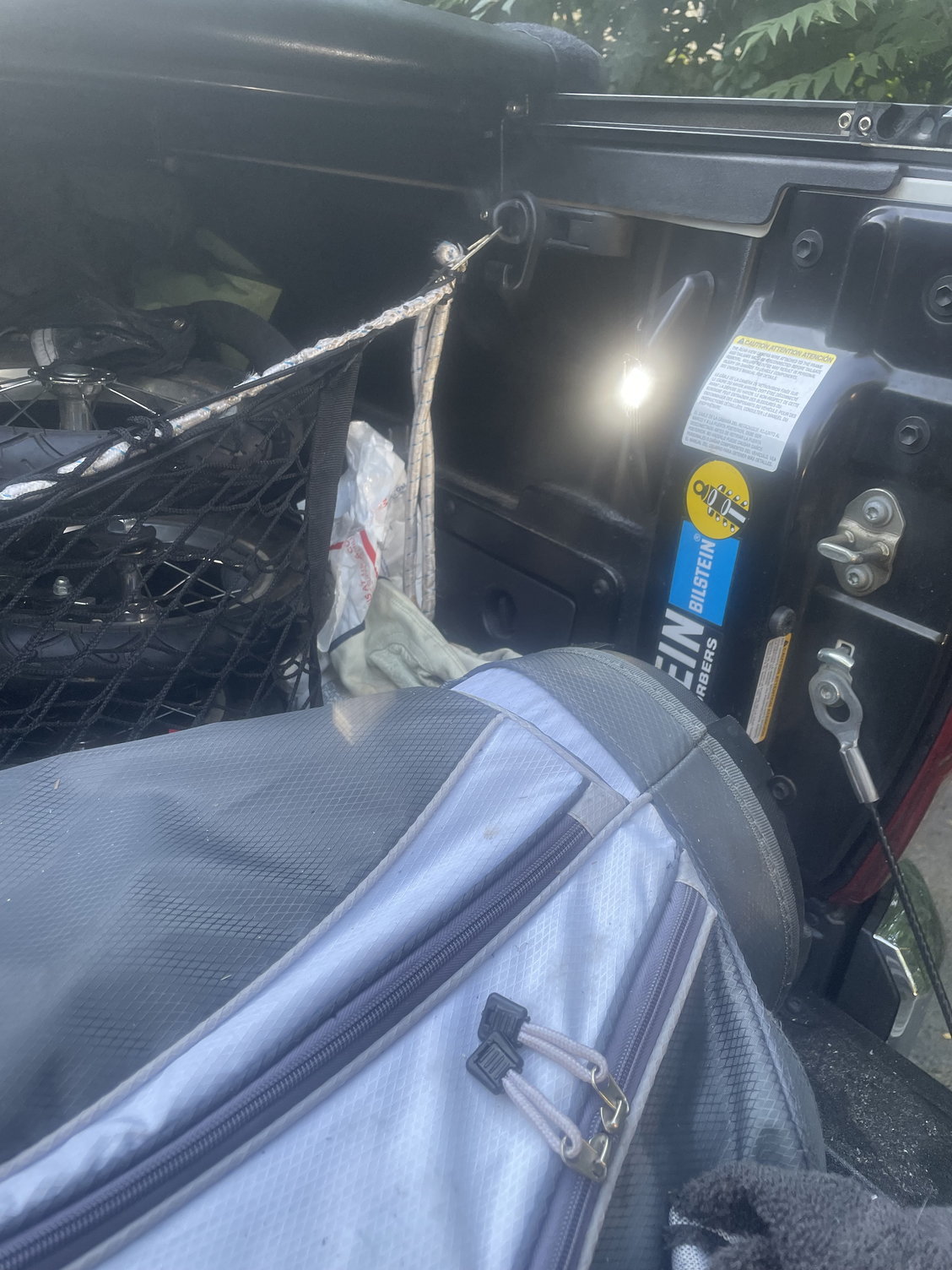

    Thanks guys! Prob just going to order some led strips or lights lie in the picture. Not looking to buy the one from the company that makes them for 2-300$ just so I can have a cargo light. Lol

    Your gonna need these two videos from you tube.

    Anyway the wiring is kinda simple you should only have a positive and negative leading to the fuse. Positive gets an add a fuse to a constant power. And the negative gets tapped into the blue wire coming from the oem switch. Very simple . This will have your bed lights exactly like the interior can lights. This is what I did

    Cool thanks. Good video. Was just going to wire up a toggle switch but maybe I’ll go this route.
