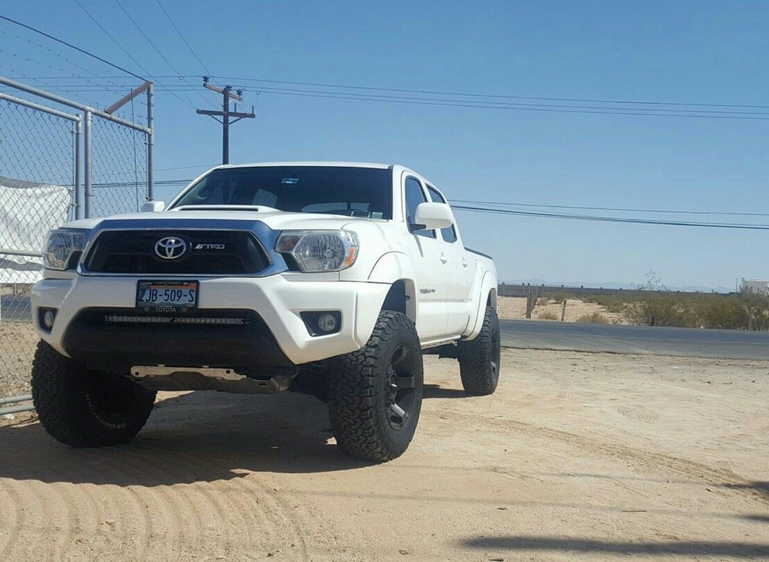

    I'd be more than happy to give a pic, what do you want, 2nd gen, 3rd gen or 3rd gen to 2nd gen hybrid

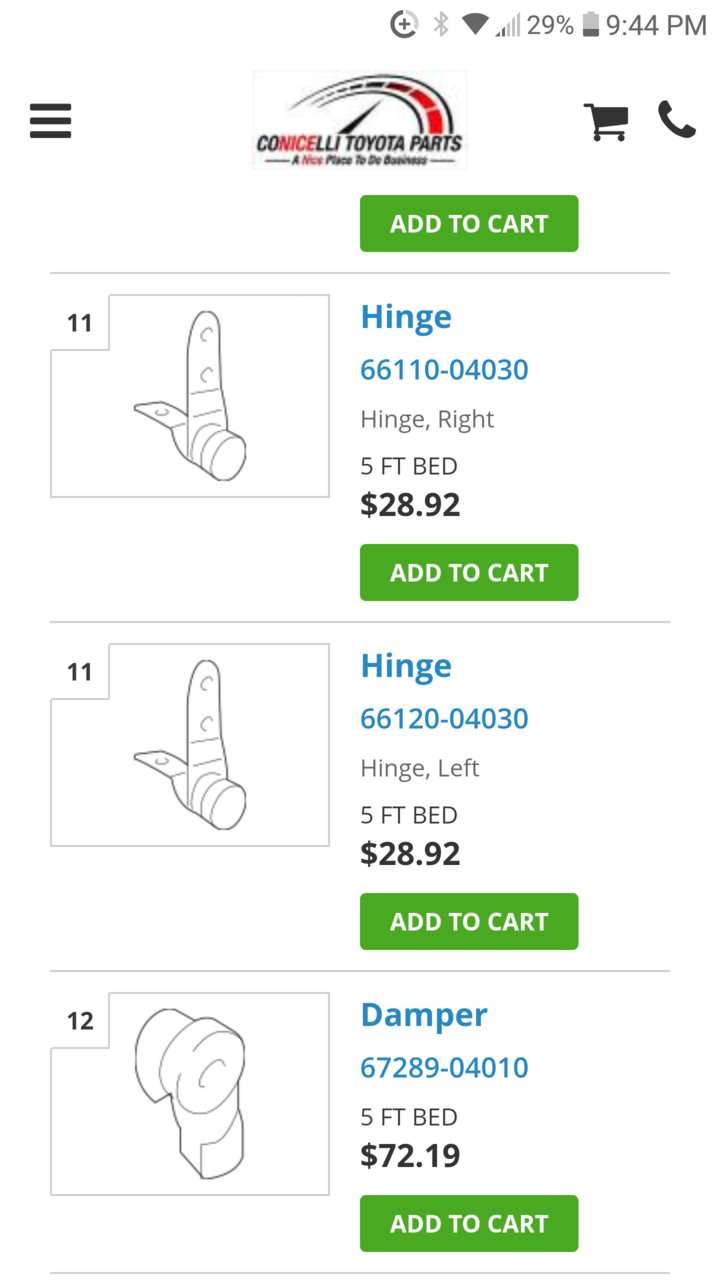

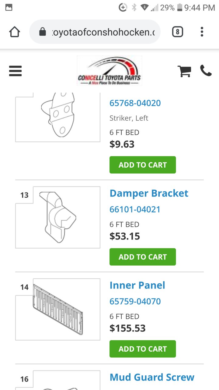

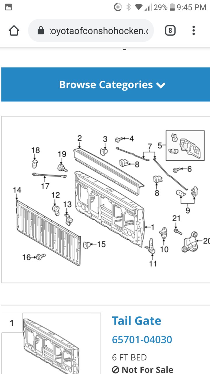

    #59085
    6,224
