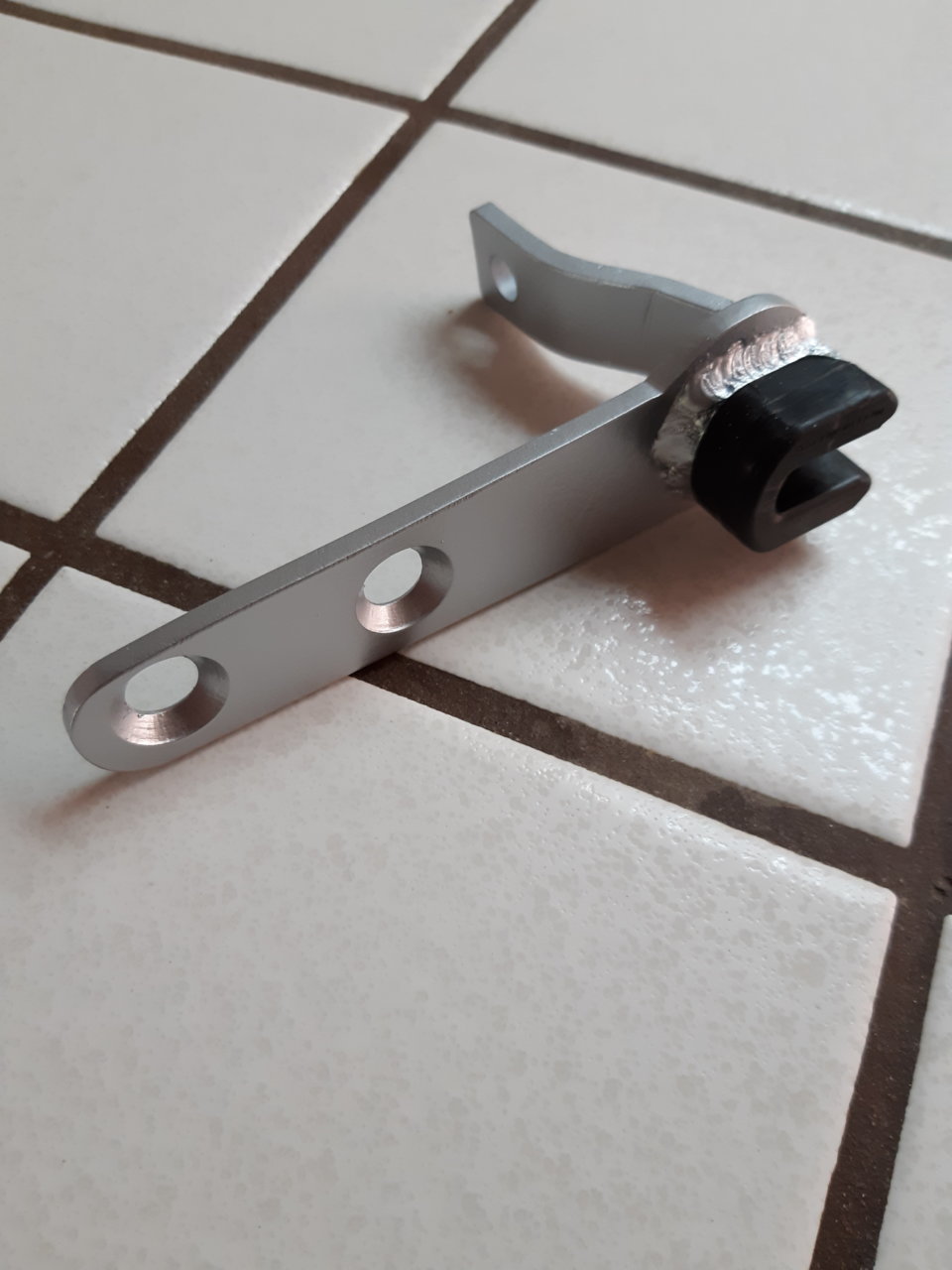

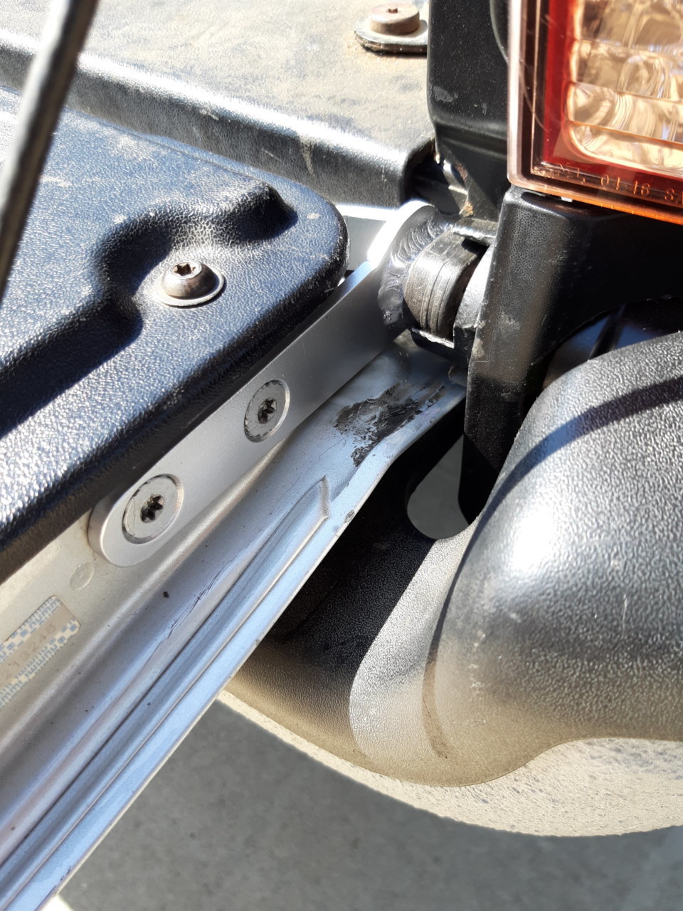

    Yes, I just got his parts in today, and I put it all on my truck. It works great, and wasn't too hard to do either. The only issue I had was when I was taking out the lower stud in the damper bracket, it was an absolute pain, but I also don't have a bench vise, which would have made much easier to remove.
    When I got his kit, and opened it up, I inventoried everything, but I was wondering what this allen headed bolt and lock nut were for, since he didn't mention it in his video, but when I was test fitting everything on my truck, then I figured out the nut and bolt is to replace the lower stud, since it was just not long enough for good thread engagement with the nut.
    So thank you @christian06, the kit works great! And now I don't have to worry about my gate slamming down since is heavier than stock, with a reinforcement panel in place.

    Thanks for the write up. Nothing mentioned in the video about removing that stud. Do you just pound it out with a hammer and a piece of pipe? Which reinforcement do you have? Steel or aluminum?

    Thanks, I was going to take some pictures along the way, but it really wasn't any different than the video he posted. I ended up cutting the stud off, and using a 7/16ths drill bit to drill out the center of the stud, and it eventually broke into a couple of pieces. I have a Mobtown reinforcement panel, and it is 14 gauge steel, so it definitely adds some weight to the tailgate.

    I just got done too about 30 minutes ago. I used hammer and bigger socket to take the lower stud. I was thinking also what is the extra allen bolt and nut. It’s all done.
