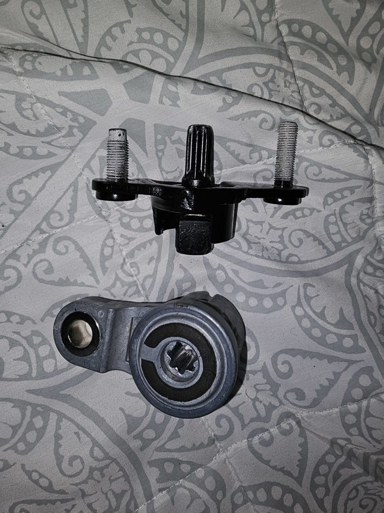

    Thread revival, install help. So I did all the drilling and cutting (yikes!) and now I'm ready to assemble. But I can not fit the 7 spline bracket into the dampener. In the install video, it looks like it slides right on, but mine is either a super tight fit, or something is wrong. Is there a trick or do I have the wrong parts? I bought the complete kit, see pic. Thanks!

    Never mind :) I guess orientation matters. I tried every spline in every position and found one that fit perfect! Weird, because it looks totally symmetrical. Anyway, installed and working! Despite all the worrying about the cutting and grinding, it was worth it! I have a drifter and spend over a hundred days a year sleeping in the bed. To be able to open the tailgate without having to reach way out to lower it is amazing!

    It will only fit the spline in one location, if you look at it, you'll see that there is one spline that is wider than the rest
