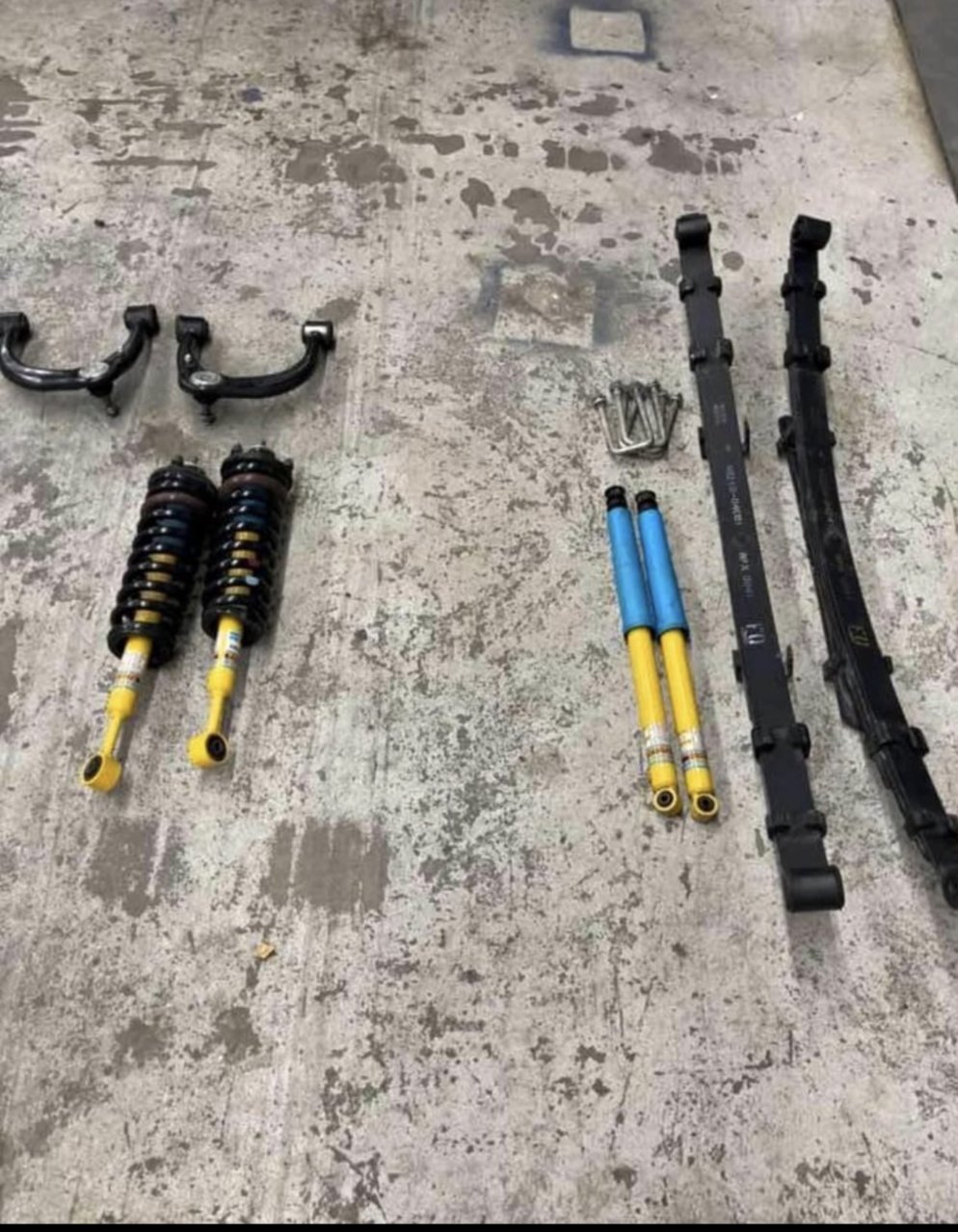

    Does anyone know if you can or how to put 3rd gen suspension onto a 2nd gen. For $400 I’ve got to at least think about it. For coils, uppers, and leaf springs if it’s not too hard I’d be willing to try. If not, if your in the SC area these are available from a 2021 TRD off-road w 18k.

    Why? Are your shocks, springs, and UCAs busted? If not, you likely aren’t going to see much improvement.

    They're direct swaps and should give about an inch of lift up front. Maybe more if your suspension is sagging. I'm not nearby but the process is simple especially since the fronts are assembled.

    Make sure to schedule an alignment as soon as you can after the install.

    Gonna add. I went from a 2014 to a 2021 off-road and the ride difference is much better in stocks.

    Thanks, I don’t expect much but from my 2010 to 2021 I’d hope there’s something different, and worst I get newer suspension for cheap for the daily

    That's basically it; you won't see a different comparing 2010 (new) to 2021 (new), but will likely see improvement from 2010 (used/old) to 2021 (new).
