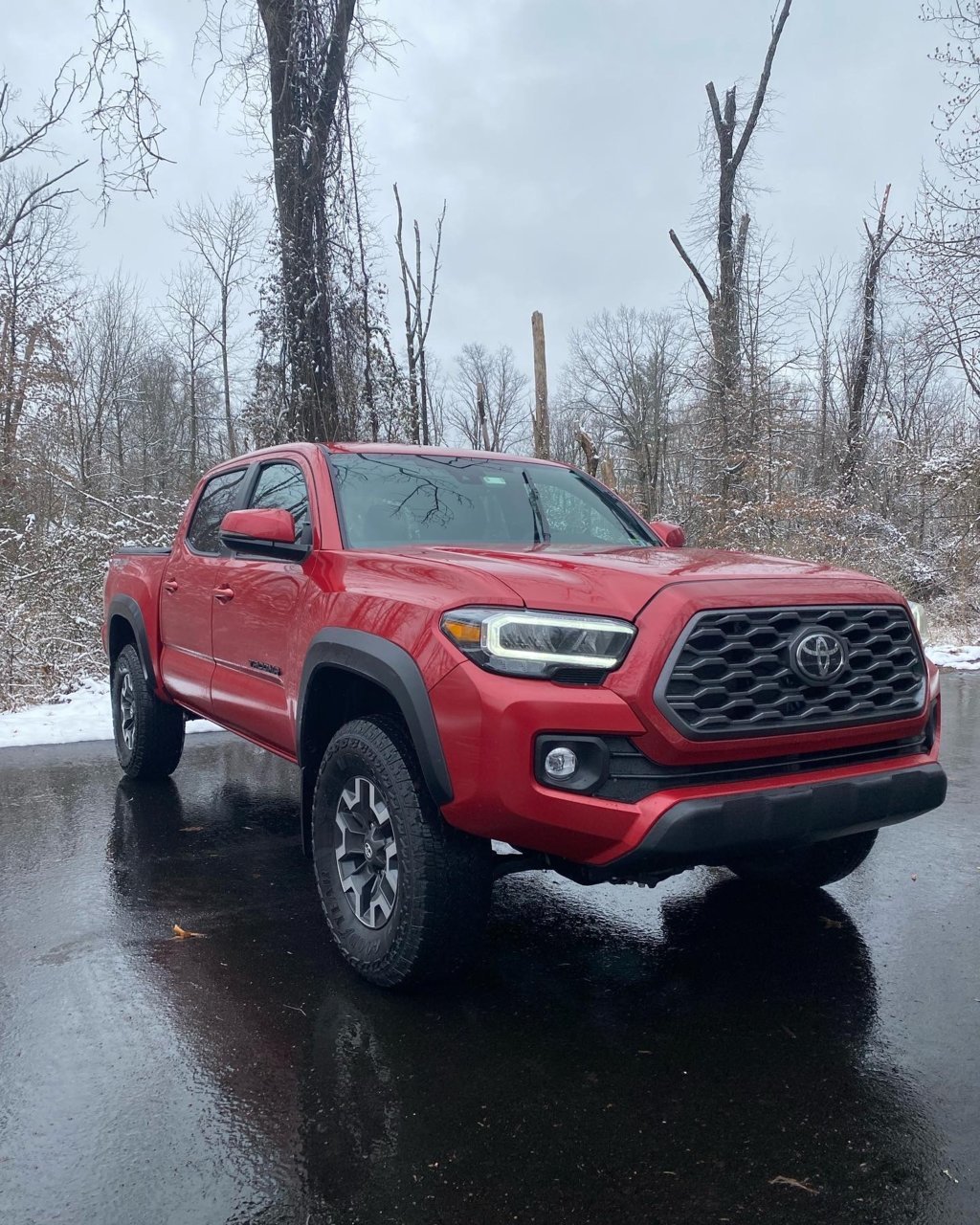

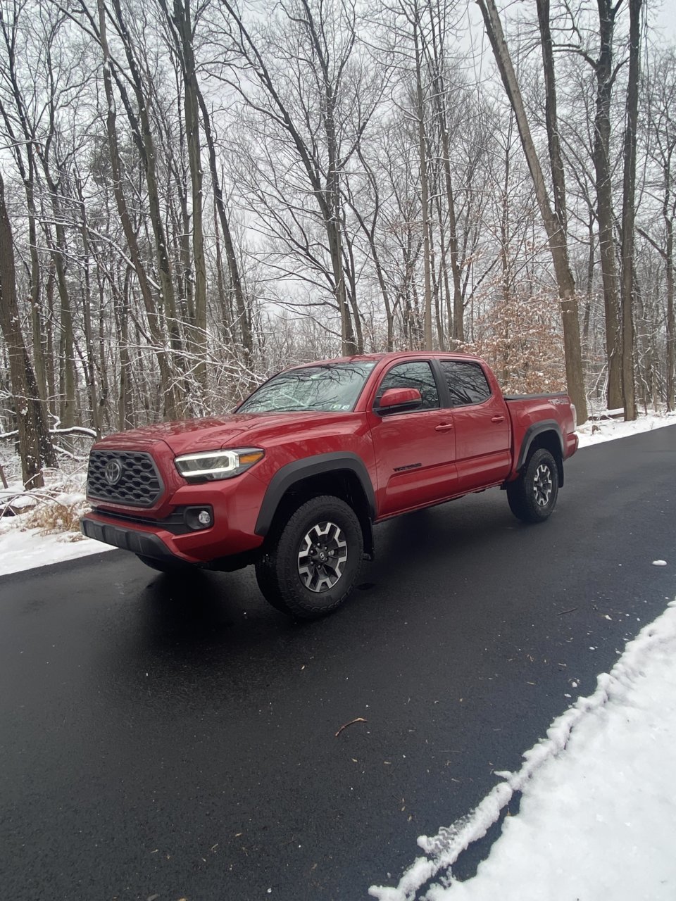

    Here are pics to the new truck. Picked it up friday. As of now, truck drives way different from the past nightmare i owned
