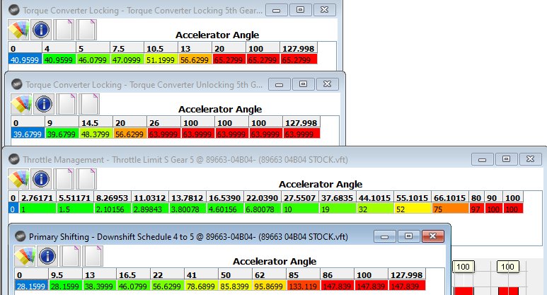

    TC shudder issue is right here in these settings. This stock 2017 ECU (TSB 2018). It has nothing to do with the fluid level. Speeds in kph. 3rd table is how much throttle allowed when you press your pedal. in 5th , TC locks at very low speed. Once it locked, the truck wont accelerate much due to accelerator limits for 5th gear. You have to either dent the firewall (downshift to 4th) or let the pedal go to unlock the TC and start accelerating. In your 45-50 mph scenario , the table speed is 80, to unlock TC you have to be 39 mph at 26* to 100* of accelerator, which is subject of the limits table. VF tuner allows to change this value to get rid of it even on Stock ECU calibration

    nice, so this needs to be edited out then.. I am having someone tune my truck tomorrow. Will be installing the 04B81 Regular Stock tune. Would i need a different tune instead ?

    No, start with it. The accelerator limits are increased on it. this will give you more throttle.
    If not satisfied, you can get a more refined tunes
