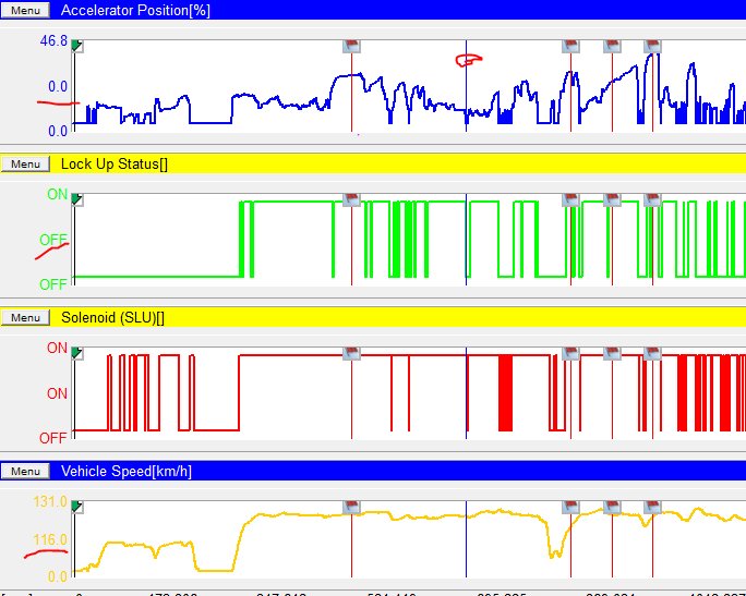

    Can you change the TC locking/unclocking settings in vftuner?

    Yes, but you will find that changing accelerator/throttle limits will give more benefits even with stock torque converter settings.
