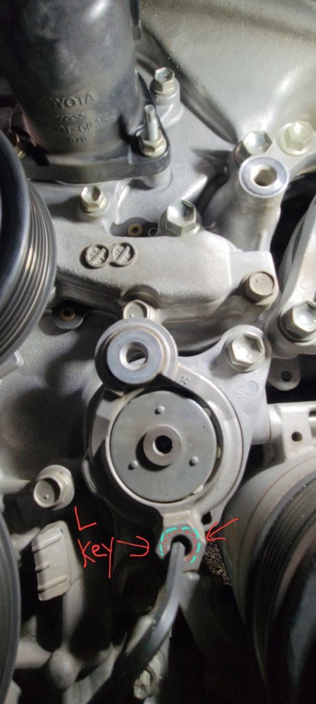

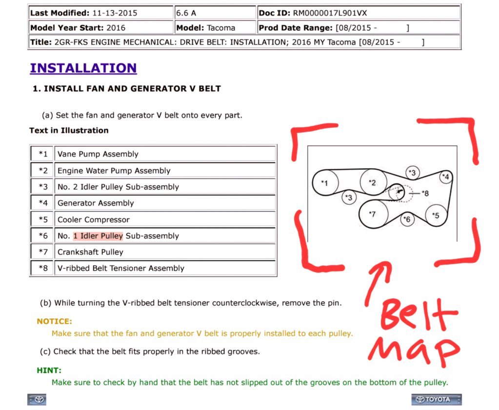

    ●First remove the serpentine belt. By turning the tensioner with the breaker bar and 14mm socket, untill serpentine belt is loosen. **<<<Have ready an allen key (5mm i think or bigger) to hold the tensioner spring, BEFORE REMOVING THE SERPENTINE BELT. Put the "L key" at the bottom holding hole>>>**
    And
    Remove the serpentine belt by wrapping it around the fan, 1 blade at a time. Untill completely out.

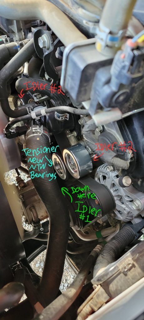

    ●Removing idlers #2 are self explanatory.
    ●To remove the Tensioner Pulley, the bolt is reverse threaded. So with the breaker bar turn the bolt forward or "Clockwise" like if you were to tighten a normal bolt.

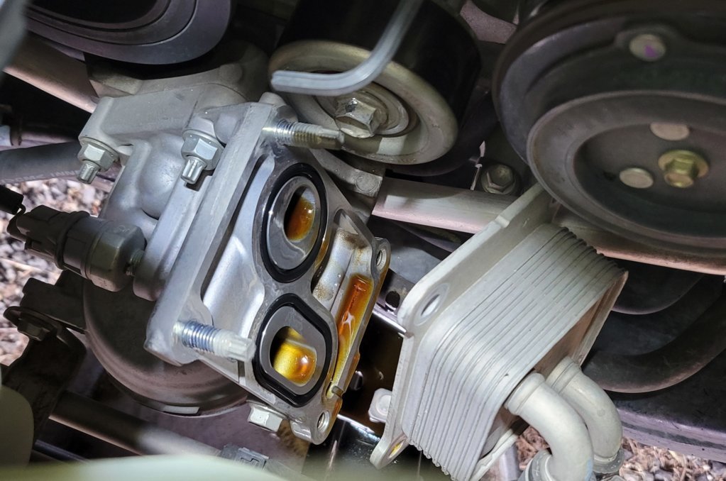

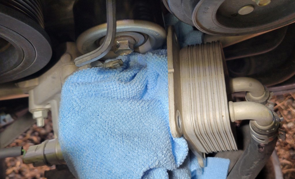

    ●To remove Idler Pulley #1 the Oil Cooler is on the way for Pulley #1. I had to remove the Oil Cooler, it has 2 nuts at the top and 2 bolts at the bottom, 12mm socket needed..
    I put a towel, to protect the oil cooler from getting dirt inside.

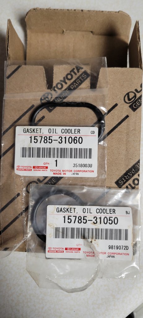

    Oil Cooler Gaskets, I think they Cannot be reused. They need to be replaced.
    Oil Cooler Gasket
    Part Number: 15785-31060
    Oil Cooler Gasket
    Part Number: 15785-31050

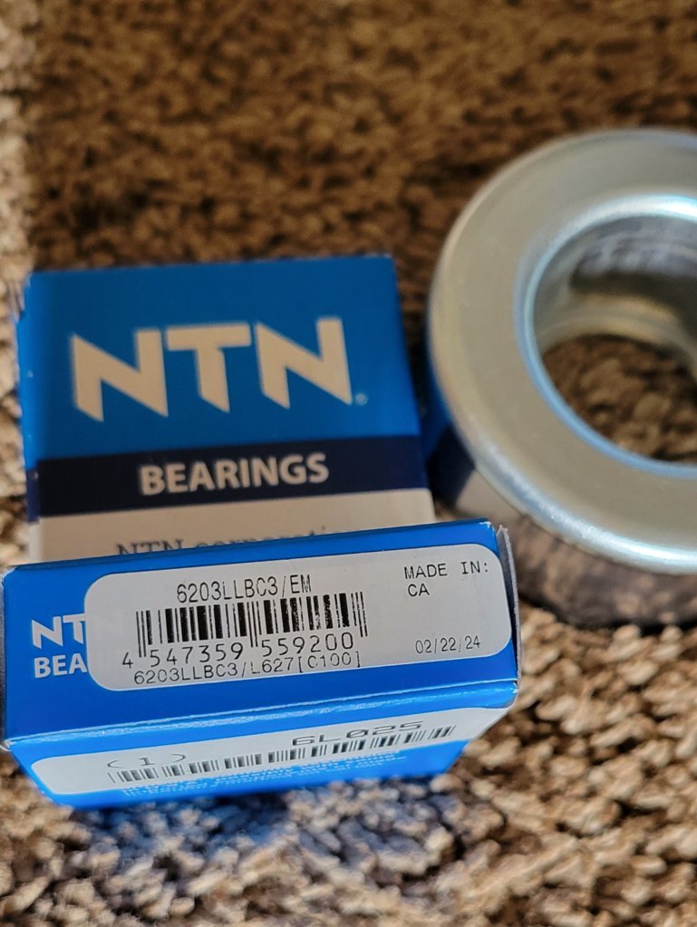

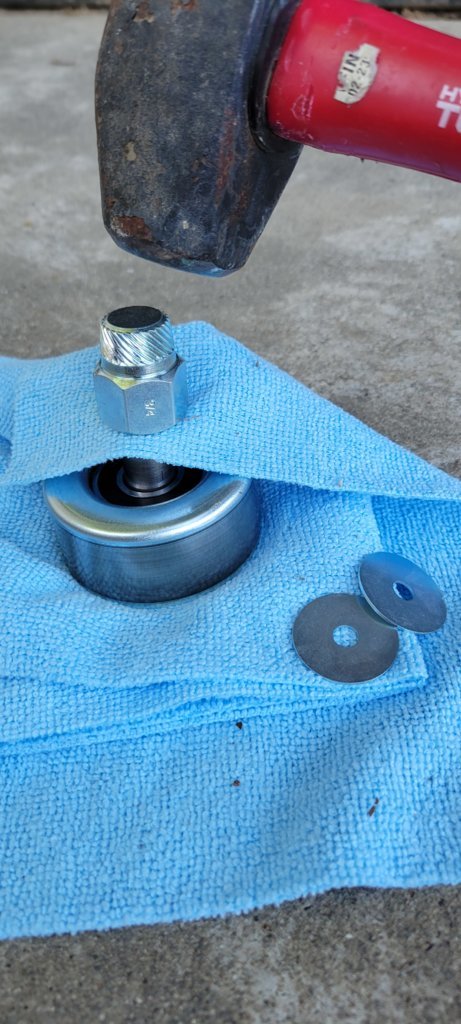

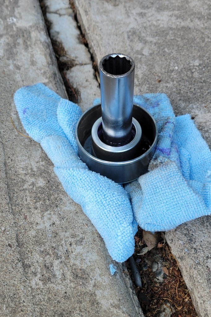

    ●To replace the Tensioner Pulley Bearings, I hammered the bearings out.

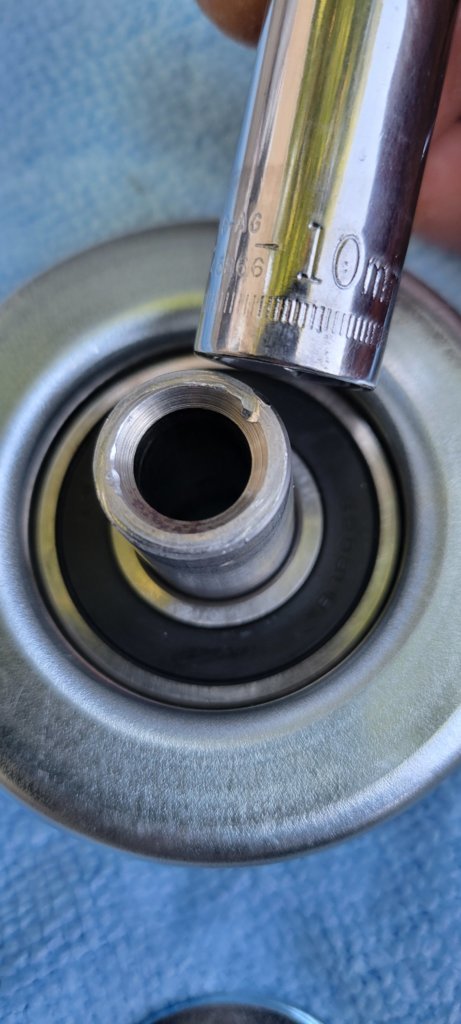

    ●To remove the middle Sleeve Bearing from the 2 bearings, I hammered it with a 10mm Deep Socket. To only hit the sleve bearing

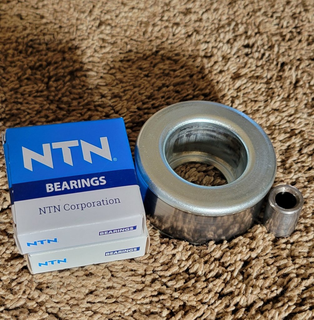

    ●Replacing the bearings on the Tensioner Pulley, since theirs no replacement for the pulley. I bought them at Grainger Store, and chose to pick them up in person the next day.
    The bearings are:
    NTN Radial Ball Bearing: 6203, Dbl Sealed, Non-Contact Seal, 17 mm Bore, 40 mm OD, 12 mm Wd
    Item
    6L025
    Mfr. Model
    6203LLBC3/L627
    Website:
    https://www.grainger.com/product/NT...hBar=true&searchQuery=6L025&suggestConfigId=1

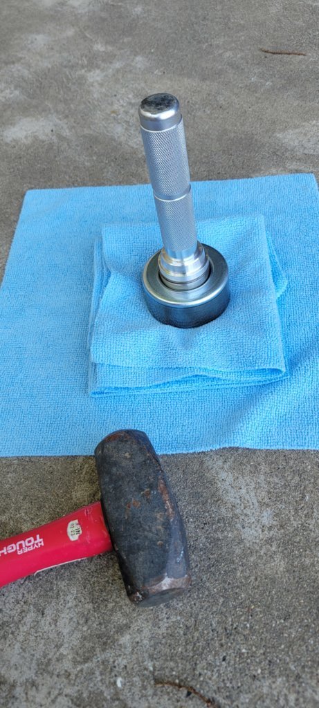

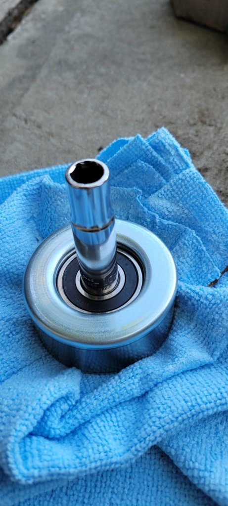

    ●To install the 2 new bearings I used
    MADDOX Bearing Race and Seal Driver Set, 10-Piece
    ●After first installing the 2 new bearings, I then reinstall the original Sleeve Bearing. I used the 10mm deep socket (you can use whatever works best)

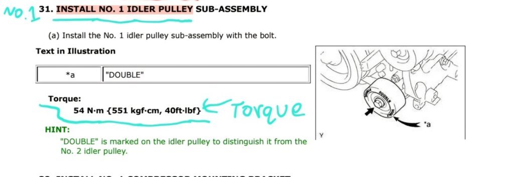

    Idler #1 Bolt torque spec:
    40ft-lbf

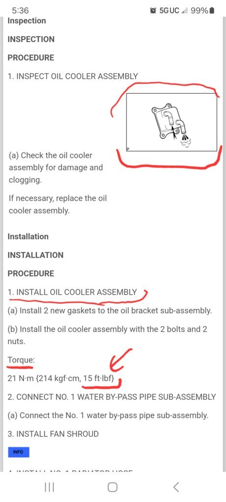

    ●After installing Pulley #1, now you can install the Oil Cooler.
    ●Don't forget to replace the gaskets With new ones.
    ●Clean the oil cooler with a dry clean rag, before reinstalling the new gaskets. Lubricate the new gaskets with engine oil. I got some from the engine oil DipStick and transfer it with your fingers or a clean towel....
    Oil Cooler Gasket
    Oil Cooler Gasket
    2 bolts and 2 nuts torque spec at: 15 ft-lbs.

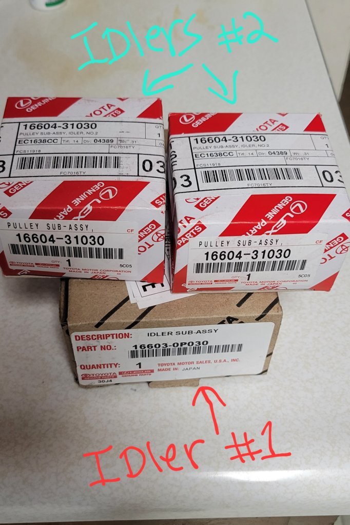

    ●Idlers #2 and Idler #1 toyota part numbers:
    Idler Pulley Sub-Assembly #1
    Part Number: 16603-0P030
    Idler Pulley Sub-Assembly #2
    Part Number: 16604-31030

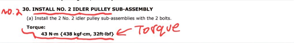

    ●Installing Idlers #2, with the torque Spec: 32 ft-lbf

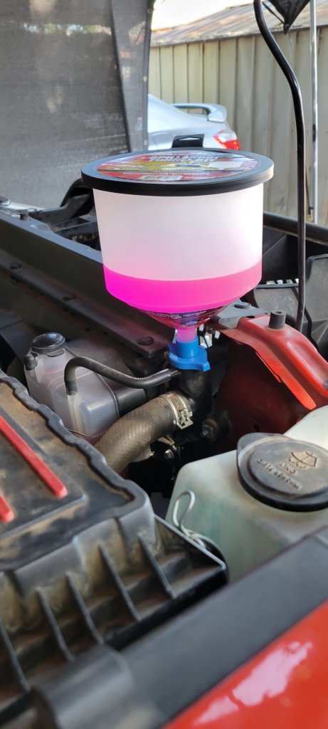

    ●Bleed out any air from the coolant, because the oil cooler was opened (the oil cooler uses coolant).
    I used a funnel that helps to prevent spills when bleeding the coolant. I reccomend it is pretty cheap on Amazon, for like $20...
    EPAuto Spill Proof Radiator Coolant Filling Funnel Kit
