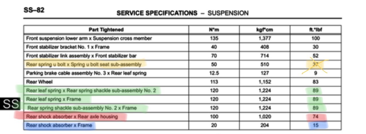

    So I ended up getting a complete trail edition suspension front and rear for $300. Before I was roughly 21” rear and 19.5 front. I’ll post numbers after but right now I’m looking for rear torque specs. I’m about 9 Modelos deep and not real into searching.

    I had this saved on my phone. The u-bolts should be ~73 not 37.

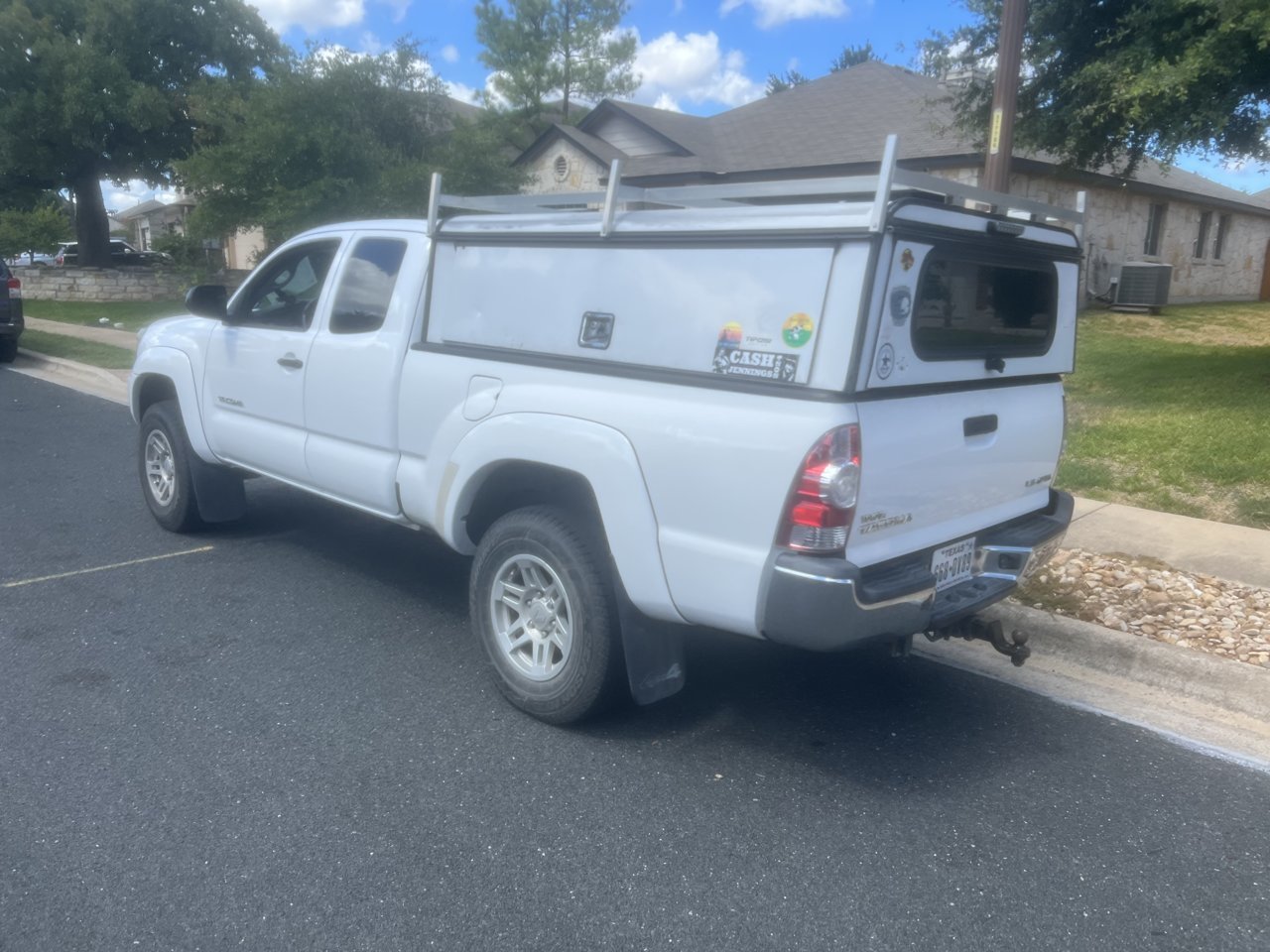

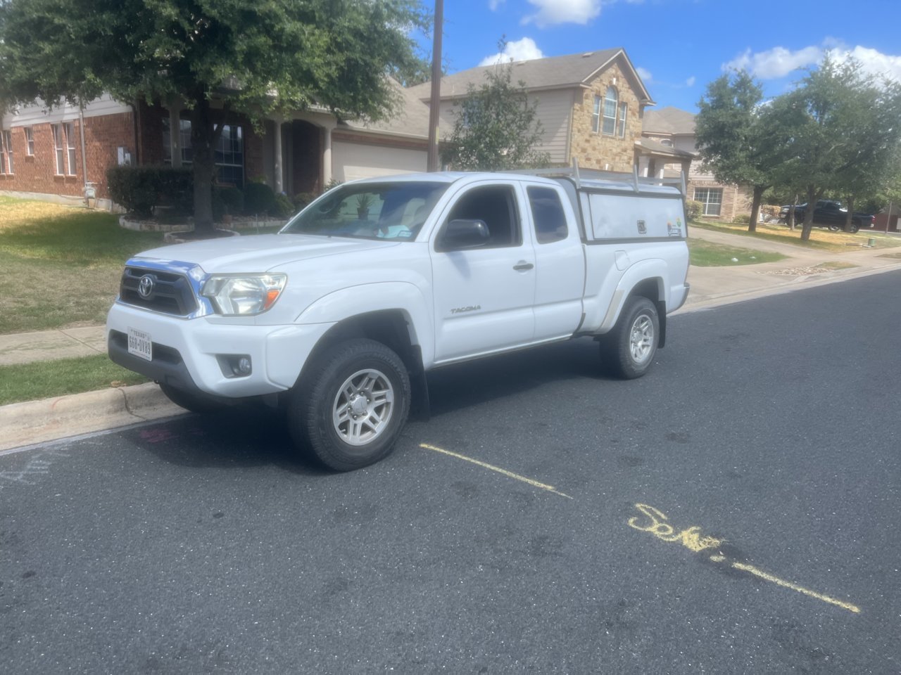

    So the numbers pre 3rd gen springs was roughly 21 rear 19.5 front. I didn’t take detailed measurements. After installation LF 21.75 RF 22
    LR 22.25 RR 22.5.
    I’m hoping the front settles a bit

    Nice, man! What differences have you noticed so far with the ride? The front will settle over time
